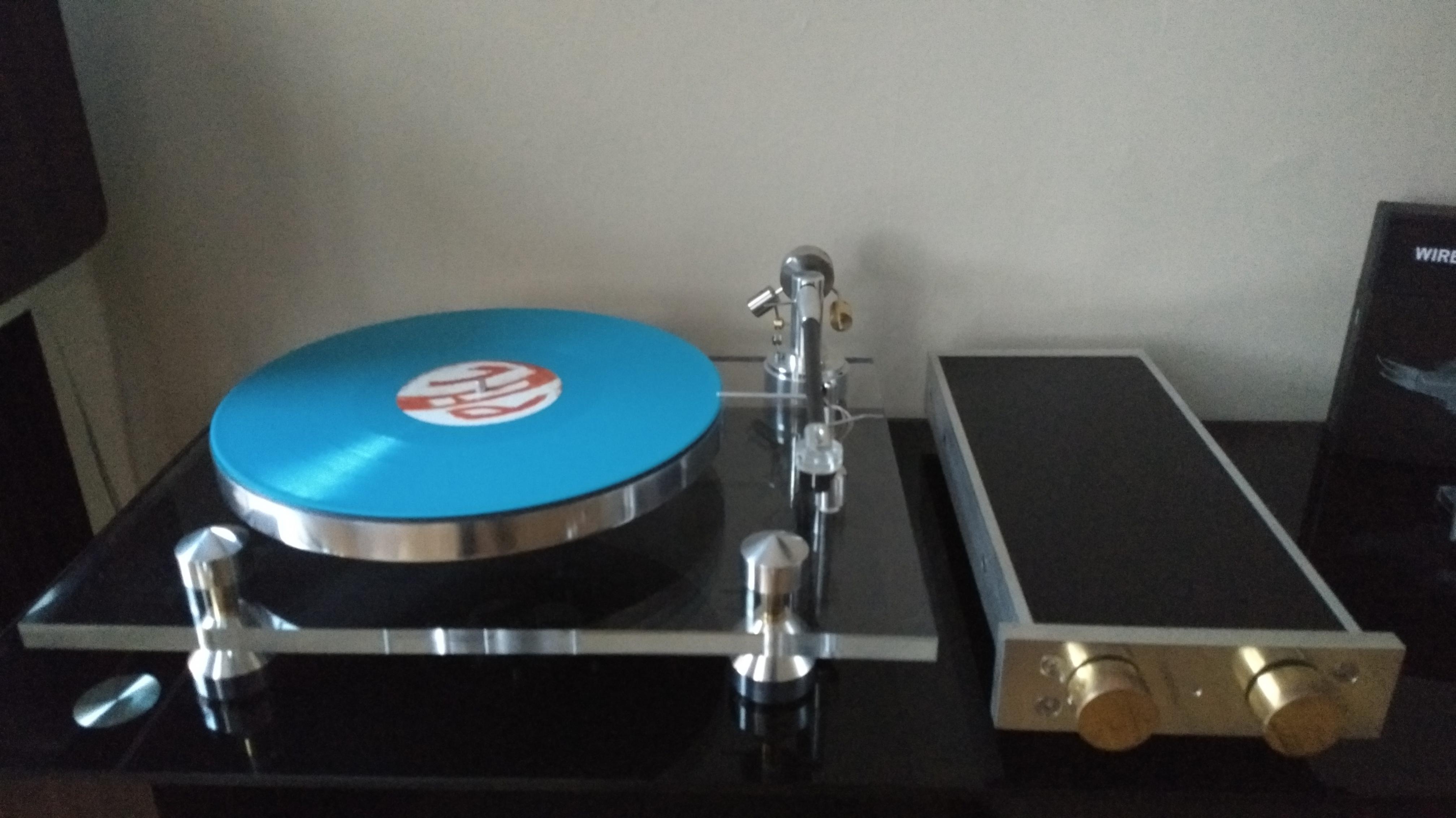

About five years ago, I externalised the PSU of an SL1700, and while I was at it, the motor control circuitry too.
I thought I might as well externalise the motor too, while I was at it.
To be fair, it was a scrapper, and no viable Technics TTs were hurt in the making of this 😉
wow - what a beaut!
