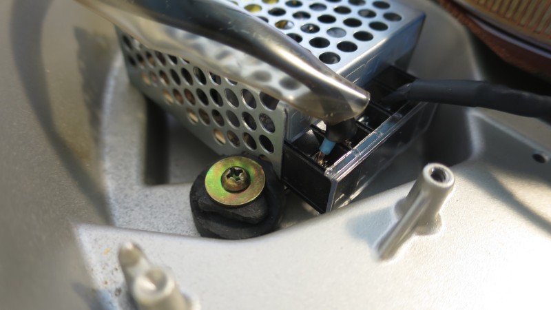

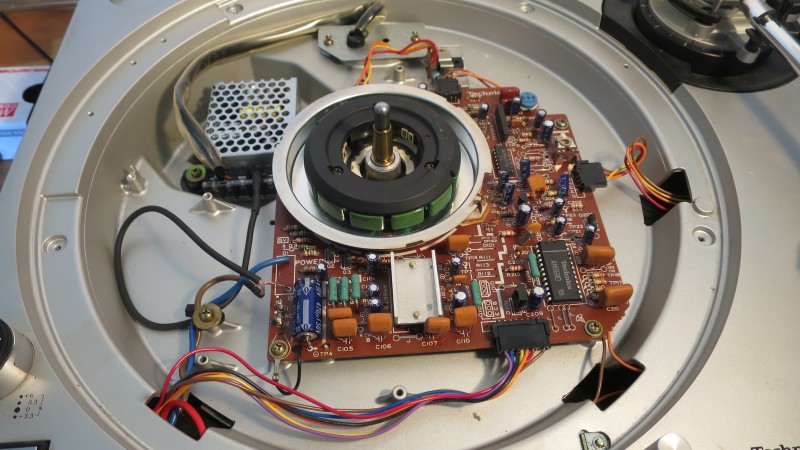

Another year later i am diggin out this old thread again. First i wanted to build an external PSU, but after calculating and thinking it over my interest switched to an internal mounted smps.
I had to order stuff anyway, so i added a Meanwell RS-15-24 to my basket. As it arrived i realised that the housed RS model should be connected to mains earth via its FG connector.

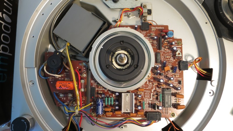

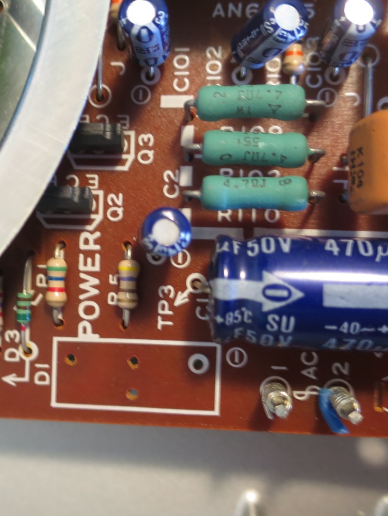

I opened my deck anyway to check if the size of the RS-Model SMPS would fit into the internal chassis of my technics 1200. I realised that my technics is pretty old, it has a darkbrown PCB.
I removed the Transformator and the PSU board, fitted the SMPS into the chassis, connected the old mains cable to the input terminals of the SMPS, connected the switch to the positive output terminal and wired the rest up.
I did not use the FG earth terminal for anything, and maybe this is the cause of my problem: everything is acceptable quiet until i touch the cartridge to put the needle on the record. Touching the cartridge produces a big amount of hum.
So my question is: would it make sense to switch to a power cable with N,P and FG? The Turntable would be the only device in my listening chain that would be connected to mains earth. Is this a good idea or stupid as hell?
some pics of Meanwell SMPS integration inside Technics 1200
I am back with some pics of the modding.
During my first test after modding with my nagaoka mm cart i had a big amount of hum when i touched the cartridge or the headshell.
Now i switched to my Denon DL-110 which behaves dead quiet now 🙂 No Hum and no signs of With the old transformer built inside the technics 1200 i had massive problems with mechanical vibrations. If i had put the needle on the resting, non-rotating record groove, my DL-110 picked up the mechanical vibrations at around 50Hz caused by the transformer. I could even hear the transformer humming when i put my ears next to the platter while the turntable was turned on.
I was never aware of that nasty humming before i used my new DL-110 together with a dead-quiet diy preamp. It never bothered me back in my low-fi days using DJ-mixer and ortofon concorde carts..
The SMPS-Mod solved this kind of mechanical hum-problem, maybe i will optimise it with line filters or an added LM317 voltage regulator. But after trying the smps only, without any added filters, it does its job pretty well. Thanks Calvin for the hint 🙂
Why not use the SMPS as the sole power supply: an NES-25-24 Meanwell SMPS can be adjusted down to 21.6 volts. This should be usable to bypass the complete internal power supply of the SL1200.
I liked Calvins contributions about leaving the internal regulators in the main board alone and let them do the job. SMPS should be run at around 70% of load. The RS-15-24 has way enough power (rated at 0.65 A output current) to run the technics without any readjustment. I am using no additional parts right now, but might add an HF filter cap at the output.
And i most likely will try and change the mains cable for a three-pronged one to connect to safety ground / mains earth.

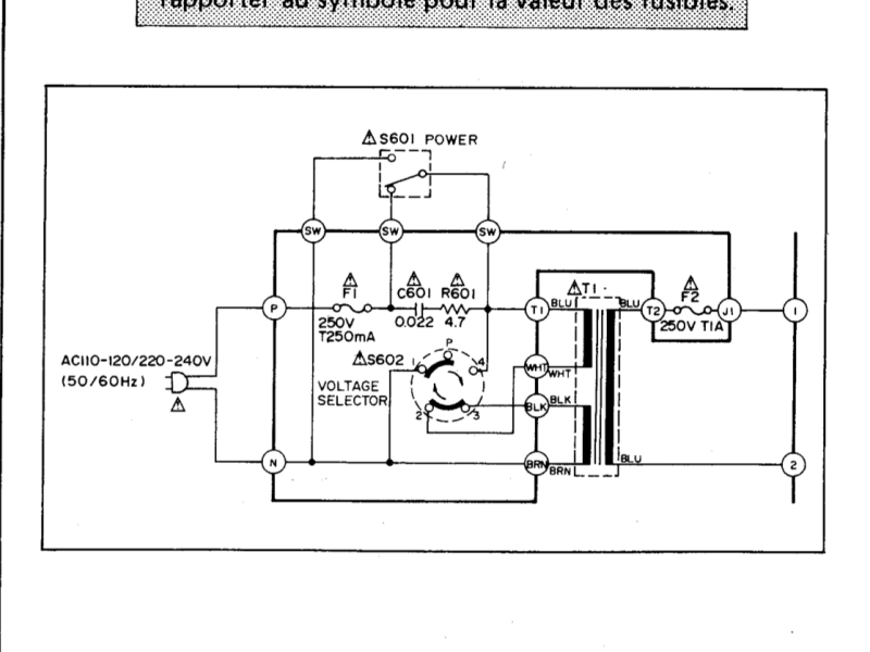

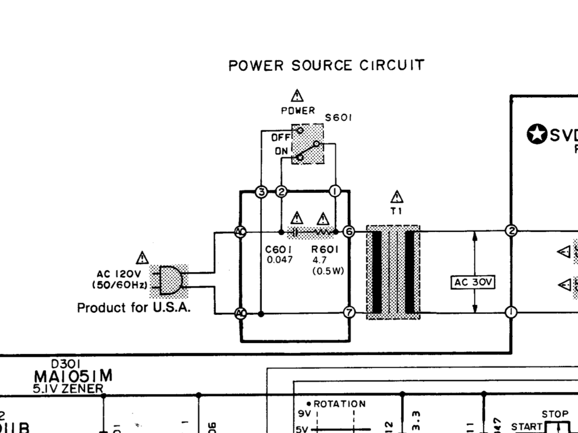

After testing the raw setup i am thinking about moving the power pcb back to its place inside the case for the reason of the original function of the power switch. I got myself the service manual for the technics 1200 to check out the original implementation of the power switch (attachment one)
I tried to figure out, which position of the switch stands for on and off. I found the answer in another part of the manual (attachment two).

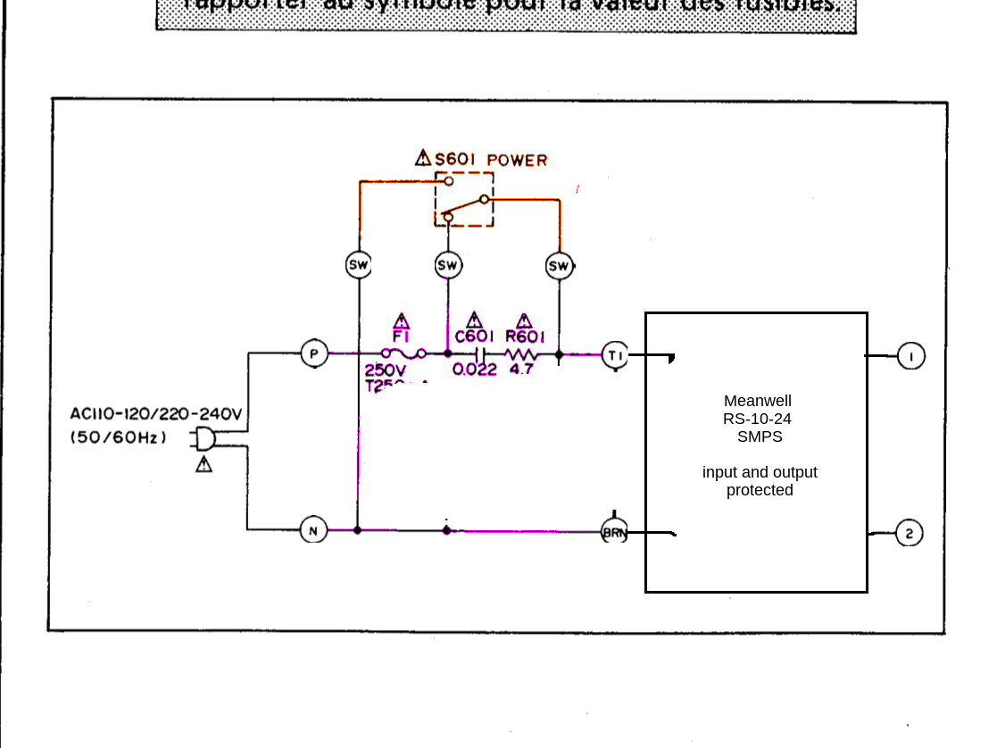

After that i tried to figure out how to wire everything to keept the power pcb as connecting board between mains AC, the mains fuse F1, power switch and SMPS. That new version is attachment three (sorry for the very ugly photoshop job) and i would be grateful if someone would take a look to see if my idea seems to be good or stupid. I am interested in your opinions..
