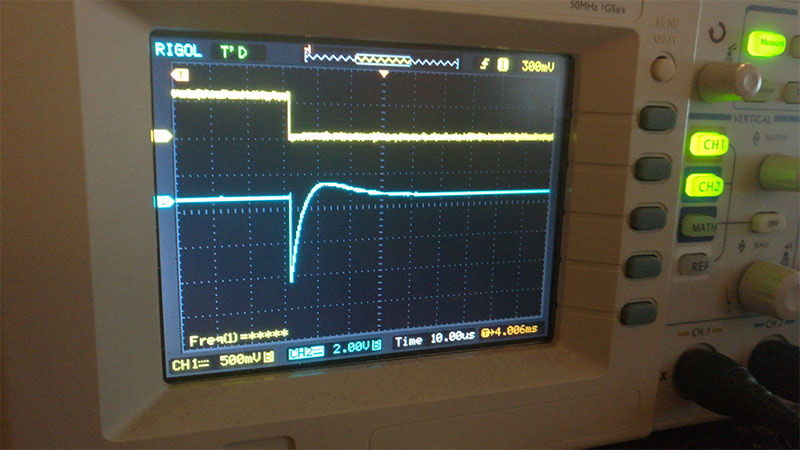

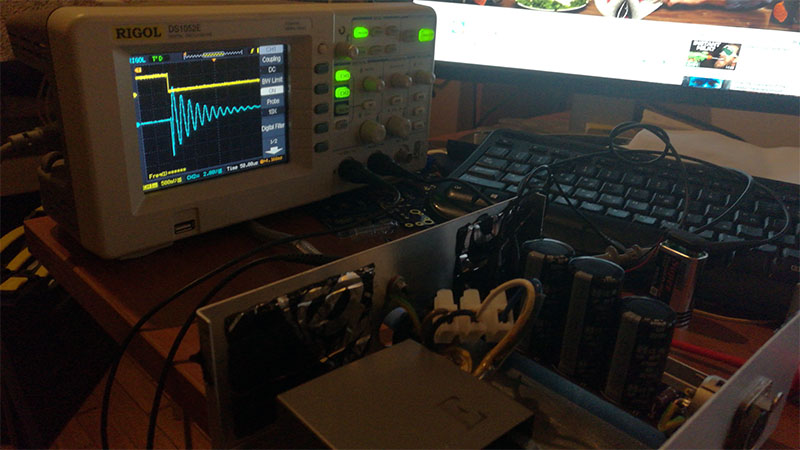

I just measured the stock transformer with the Quasimodo jig to get a proper snubbing network to replace that 220nF cap.
attachment.php
The values are
Cx: 10nF
Cs: 150nF
Rs: 270R
This is for a primary wired for 230V.
Sorry no measurements yet for 110V, but with something like 250R you should be close enough for a first evaluation.
And here are some scope captures
With just the 10nF cap attached. Quasimodo ringing the bell full strength.
attachment.php
And here is what's left of the ringing with the values above.
attachment.php
