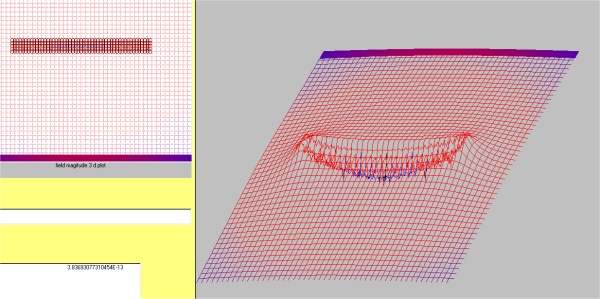

Well yah...for now..
Here's a simulation picture of the magnitude of magnetic field around a rectangular conductor..it is composed of 100 wires, in a 25 by 4 array. Since this is NOT a depiction of a high frequency current re-distribution, but a DC one, it is sufficient as a model for deriving the DC magnetic fields to a point..I use magnitude for this, as coloration based on field line direction and intensity is just a tad more difficult to understand..I can make those pics, but trust me...while pretty, is very confusing...😕 😕 😕
For this software, I have black as zero field, blue as middle, red as highest field, in gradations..the view is close to the wire, so there is no outside black regions...
The spikes and dips in the pic are a result of using individual current conductors...the math goes wild if the calculation point gets too close to a current, the currents are singularities..
The most significant thing to see is the center of the conductor..note that there is a dip in the field there, as indicated by the blue. Also note, that the dip in the field along both long edges is evident..
When this conductor is driven by high slew rate currents, the higher field locations will create the higher eddy's, this is where the currents will be drawn..
Please excuse the fuzziness, this 100K file size is too small..
Cheers, John

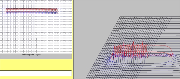

Here's a pic of a pair of ribbons..
Note that the magnetic field is highest in the center..this is the classic dipole field, just elongated..and it will react differently to high current slew rates.
Also of note, the field around the ribbons...it's almost zero, the black field is everywhere...
I made the software auto-range field intensity so that the peak field is the same in all cases, colorwise and vertical wise, so you can't simply compare both pics to get a feel for absolute field strengths...but it is quite powerful for showing how the fields tend to congregate..
Cheers, John

John, many thanks, very illuminating. How about side by side? (I love taking advantage of free labor!)
SY said:John, many thanks, very illuminating. How about side by side? (I love taking advantage of free labor!)
Ummm, SY? (look up) You mean, like that?
Cheers, John

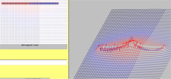

SY said:The posting is running fast and furious- I missed it!
Ya snooze....ya lose..
I wasn't sure which side by side you wanted, so I started this one...it is side by side, not overlapping..notice the thing spashed field all over the place, it's definitely higher inductance positioning..no control, what a mess!!
Case anyone asks...the software runs at different scan resolutions..really coarse ones, then finer and finer..what I've been taking snapshots of is the next to last scan, which is a roughly 50 line by 50 line vector presentation..the last scan is about 3 times the resolution, which provide solid coloration of the fields..The vector lines provide a clearer depiction of the fields for simple discussion, as the slope of the field intensity can be seen.
John
