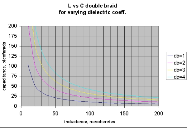

I have referred to the "Effective Dielectric Constant" (EDC)...I will elaborate on that..
For a transmission line, the velocity of propagation is V = 1/sqr(LC) (eq 1)
L of course, dependent on the magnetic permeability mu, and C on the Dielectric Constant, epsilon.
Lower the inductance or capacitance, and you increase the prop speed...the limit being lightspeed.
For a coaxial line composed of both inner and outer cylinders, like braid, the equations are this:Ro is inner diameter of the outer conductor, Ri is the outer diameter of the inner conductor..
(hope you guys don't mind me not using html here, it is such a pain..
C = (2 PI epsilon)/ln(Ro/Ri) (eq 2)
L = (mu/2 PI) * ln(Ro/Ri) (eq 3)
Rearrange equation 2..
ln(Ro/Ri)= (2 PI epsilon)/C
Rearrange equation 3..
ln(Ro/Ri)=2 PI L/mu
set equivalency of the log ratio's..
2 PI epsilon/C = 2 PI L /mu
re-arrange... LC = 2 PI epsilon mu / 2 PI,
LC = epsilon mu (eq 4)
This is the complete derivation for the equation I posted earlier, that being L * C = 1034 * DC... (eq 5) note L is nH per foot, C in pF.
Now, equation 5 sets the bounding relation between inductance, capacitance, and DC..for a coaxial run. For any other wire pair or configuration, this equation sets the limit for what is possible given any dielectric. In point of fact, it is not possible to make a wire that has an LC product smaller than 1034 times the DC of the insulation, it is only possible to get higher.
I stated before, EDC. the definition...first, a limit: we will only discuss non magnetic materials, IOW, mu equals 1..
For any wire construct which is not coaxial, you will have a measured L and a measured C. The equation for EDC is :
EDC = L * C / 1034 (eq 6)
If the cable is 100% efficient at containing both the magnetic and electic fields (as a coaxial one is) , then the EDC will be equal to the actual DC. In the limit, very wide ribbon pairs can approach this, at least for DC applications..
If fields spill out, for example, a zip cord, then the EDC will be quite a bit higher than the dielectric...this is of course, the inductance increase of the fields around the wire..
From equation 1, V = 1/sqr(LC) , substitute equation 5 for L * C, this gives:
V = 1/sqr(1034 * EDC) (note that epsilon is actually epsilon absolute times epsilon relative..dc is epsilon relative.)
Again, the prop speed is proportional to the EDC of the system, and the EDC can be used for calculation of velocity.
Attached is a chart showing the relation of inductance and capacitance for four different dielectric coefficients..
Cheers, John

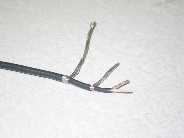

The best approach is to think of it in terms of efficiency of geometry..the closer you get the EDC to the actual DC, the more efficient..
For the best efficiency, a double braid coaxial structure is the best. Use of an inner braid removes the 15 nH per foot penalty of a solid inner conductor, so it is not necessary to increase the capacitance to bring the Z back down to 8 ohms..
Plus side: I can make any Z I want, my first design (pic attached) was 10nH per foot, 288 pf per foot, EDC was 2.7, which is exactly the DC of the Tefzel insulation I used (hey, gotta check and re-check for consistency). The braid I used was just some stuff off a kilofoot roll of mike cable I have, so it is not low R.. It is easy to get nice braids which are #10 awg equiv, I am working with some of that now..
Neg side: To lower the EDC to about 1 requires thicker insulations, which requires larger cable diameter...for a Z = 8, a reasonable insulation with DC of 1.05 needs to be about 30 to 40 mils thick, this sets the inner diameter a tad larger than the heat shrink I have easy access to..overall structure will be about half to 5/8 inch diameter..
It also has bend restrictions..it's incredibly low inductance relies on the symmetry of a coaxial cylindrical structure, and bends tend to make the structure oval. The external cancellation of field may or may not remain cancelling if the shape goes oval, as that will be dominated by the modulus and thickness of the insulation and the overwrap pre-compression. IOW, total unknown..
Second choice for me would be cat 5 type stuff, multiple wires to lower inductance, braid to guarantee consistency in current sharing throughout the band.

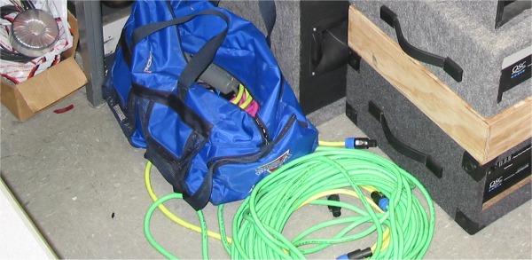

Oh, almost forgot the requisite pic...here's MY audio cables...#12/3, in neon colors, with neutrik connectors..color coded for length, 1+, 1-, and 2+ are used, the 2+ wired to allow the same cables be used for bridged application, rather than wiring separate cables for that. Tough to transport, but robust, in case one of the guys here runs it over with a forklift..
Cheers, John

Good eye..
I needed a cylindrical entity to start with..so I used a coaxial cable as the inner core..because there is no electric or magnetic field within the core of a cylindrical current, the actual material in there has no consequences with respect to inductance, capacitance, skinning, or absorbtion..the choice of inner coax as a starter allows the feedback for the amp be picked from the speaker. This allows the amp to control the terminal voltage at the speaker, rather than at the amp, without picking up the B dot error associated with a simple voltage pickup scheme. (b dot is rate of change of magnetic field..at low impedances, the high slew rate of audio currents will generate loop voltages (faraday's law of induction), and those loop voltages will alter the time relationship of the signal being fed back..The accurate measurement of fast voltages and currents within a low impedance circuit is one of the most difficult things to do if e/m theory is not considered, so many do it incorrectly..and don't realize it.
It was never tested, I had sent the cables to a guy on the west coast to try..and he never returned them..oh, and, the outer two braids are used for the run..

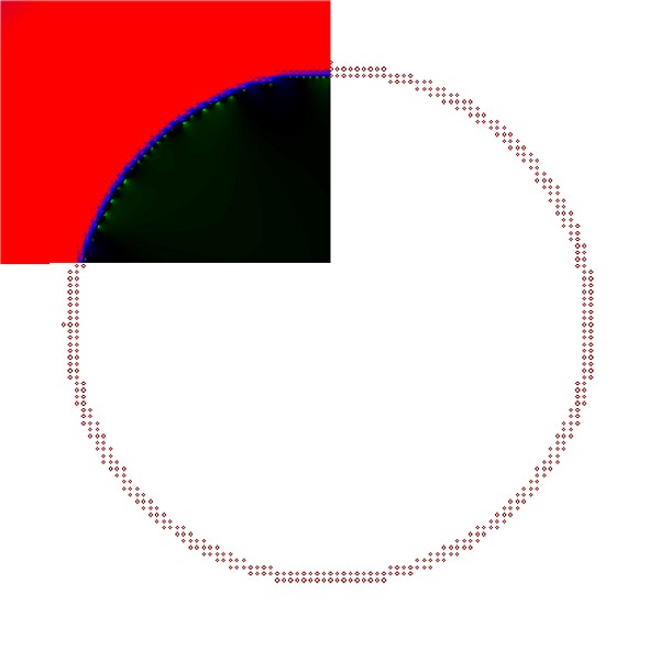

What was I thinking...no pic
I stated that a cylindrical current distribution has no internal fields...here is the field map for a cylinder of wire..one quadrant copied for filesize limits...note that the green residue is the result of the graininess of the simulation structure. If I use more wires for the simulation, the green reduces..the magnetic anomolies tend to be about the same size as the conductor element spacings and go to zero in the limit of continuous conductors. But note, how black the interior is...no field...no inductance within..
Cheers, John

There is no trick..start with a tube, pull one braid over it..hold the braid tight, then heatshrink over that, pulling the heatshrink tight as is shrinks..this will make the structure of the braid visible through the shrink..then pull the second braid over that and final heatshrink or wrap over the second braid..it is important that it not be loose, and care needs to be taken not to damage the insulating layer between the braids.
Belden makes some triaxial wires, #88232 video triax, which has 2.6 ohms per kilofoot, #14 equivalent, inner and outer braid, with Fluorinated Ethylene Propylene as the inner jacket. They give the overall nominal diameter and the inner jacket dia, but they do not specify the inner shield diameter, so I cannot calc the Z of the double braid..the DC of the FEP is somewhere in the 1.8 to 2.4 range, I calculated this from the elec data on the Belden site, but I can't vouch for the accuracy of Belden's data..in the 32 wires I looked at, there were 3 gross errors..
Cheers, John

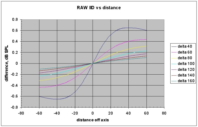

I have finished the first iteration of the IID spreadsheet calculations..I am somewhat taken aback at the numbers I am seeing...so much so, that I have to re-check the numbers.
But, I attach the first graph..it it the SPL difference between ears, for a source that is between 40 and 160 inches in front, and from -60 to 60 inches to either side.
If you look at the "delta 100" line, which represents the ear to ear spl diff for a source 100 inches away, this can be seen.
The difference in spl from center stage to 20 inches to the right, is .1 dB..that is very small. If we wish to keep an image stable to within a foot of where it is supposed to be, the system will have to be good to about .06 dB from one channel to another..from the initial ITD graphs, it appears to be about 50 uSec as well..
It is possible that IID is the more important of the two parameters.
Cheers, John
