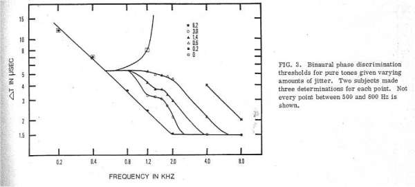

The statements 1 uSec and .01dB were examples of setting criteria to measure...I could have provided any numbers as examples of criteria...I am suprised you focussed on 1 uSec instead of .01 dB...I think the dB level is more difficult and outrageous..
That said, I've attached a graph of actual date, this simply because I already scanned it and converted to jpeg...the other data I have is in hardcopy form, the scanner is at home..
As is evident, differences at the 1.5 uSec level were reliably detected..this graph being simple tones..
Actual music will have far more information which we use to localize, so I certainly expect our sensitivity to be on par with what is on the graph...
Um, Jan..have you ever seen a test setup that is capable of measuring accurately 1 uS response stuff at 4 to 8 ohms?..at 20 Khz, even a 6 inch long piece of 500mcm generates enough magnetic field rate of change to produce 300 mV error. Nevermind making a darn load resistor capable of flat response to 106 hz..
janneman said:Just show us that speaker cables can give more than 1uSec differential delay and we will beat a path to your door to congratulate you!

I don't think I'll quote your lengthy post # 54. I know there is a lot interesting stuff in it. But precisely BECAUSE our heads are not in a vice, we have huge varying differential delays, all over the place, unpredictable, continuously. Milliseconds of it. Show me a cable that can dominate the localisation at those levels.
And I also do NOT agree that measurements with pure, jittered tones can be transplanted to music 1:1. Available measurements with THD levels, phase shifts, delays etc that I am aware of (but I may have missed a few), ALL show that you can hear these things, sometimes, with specially constructed signals, but NOT with music.
