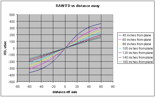

I've been crunching the numbers for ITD only so far, here is a graph. This graph represents the difference in arrival time between the ears, for a source which is a distance of 40 to 160 inches from the plane of the listener, and at a distance x axis inches off the centerline of the listener's line of sight.
When the source of sound is 40 inches from the plane of the listener, and 20 inches to the side, the difference in arrival time, ear to ear, is about 200 microseconds. When the source is 160 inches away, that difference reduces to about 60 uSec.
So, with complete disregard to the intensity difference between the ears (that will come at a later date), this graph represents what a human needs to be able to distinguish using ITD, in order to localize an object absolutely within the two dimensional space in front..
All the lines should asymptotically approach 440 uSec for large distances to either side, as that is the time required for sound to travel 6 inches, the ear to ear spacing assumed, neglecting the wrap distance around the head.
From this raw data, calculation of side differential sensitivity and depth differential sensitivity can be trivially calculated..It is the differential ITD's and IID's which will determine how the virtual soundstage appears to us, as the absolute soundstage is determined by the head position. Since we do not keep our head still to the degree required, it is necessary to approach the issue as a differential one..
I will be re-checking the math, as this thread content has begun about a week before I was ready to elaborate..
Speed of sound is 13620 inches per second..
Cheers, John

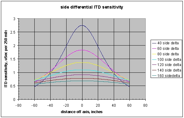

Next, let's look at the side differential ITD sensitivity.
Graph attached..this one is a little more difficult to understand..
Again, each line represents the distance the source is away from the listener plane, and the x axis represents the distance in inches off the listener's center of vision..
Didn't have time to correct the y axis units, so I modded the y axis title...y axis for this case represents the difference in arrival time, in uSec, for an x axis shift of 1/4 of an inch..I used 1/4 inch increments to keep this graph relatively centered in x..
Example...for a source 40 inches away, if the source moves 1/4 inch to either side, the ITD shift will be 2.75 uSec...for a 1 inch shift, it will be 4 times that, or 11 uSec.
If the source is 40 inches away, and 40 inches off axis, a shift right or left 1 inch will result in an ITD shift of 4 uSec.
If you look at the 160 inch numbers, center stage has an ITD sensitivity of about .7 times 4, or 2.8 uSec per inch sensitivity..if an object is moved 10 inches off axis here, the ITD shift will be about 28 uSec..
Application to hearing? If a virtual source has been generated which appears to be 160 inches away center line, an arrival time shift of 28 uSec at one ear will result in the virtual image moving about 10 inches to the side..
Application to speaker wires? Glad you asked..
To form a virtual image in space, both the time and intensity of the aural cues must be maintained true to source..given the complex waveform being presented to the speaker, how would a wire affect these? And, to what degree?. I can measure wires easily enough, but how does the measurement of the wires correlate to creation of a virtual soundstage?

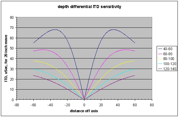

This graph is the sensitivity of ITD to depth...
Each line represents the difference in depth as a result of an ITD shift. For example, the blue line represents the difference in ITD from 40 inches away, to 60 inches away..
Note that on axis, the image is not sensitive to depth moves..in other words, if the source moves forward or back, ITD does not change.
If a source is 40 inches away, and 20 inches off axis, moving the source 20 inches away in depth causes an ITD shift of 52 uSec..
Look at the 120 numbers..if your speakers are presenting a virtual image 20 inches off axis, and one speaker, for whatever reason, delays the cue 10 uSec, the image will shift. I could say that it will shift back to 140 inches, a 20 inch move...but, I have kept the discussion simple here..in reality, the sensitivities to ITD and IID will interact, and that will be seen more as a smith chart than anything else...
I work to derive that chart, so that it will be plainly seen what a shift in either or both parameters will do to the aparrent location of the virtual source..
If one chooses to use the overly simplistic model of human hearing, that is, the JND research for monophonic discrimination of level sensitivity fro 20 to 20K, that is just fine...it, unfortunately, has nothing to do with soundstage parametrics..

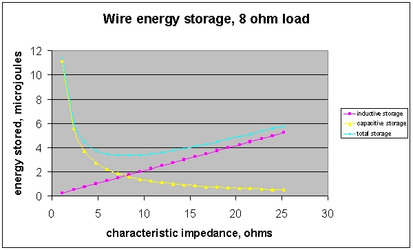

As for application to speaker wires? If one assumes only our sensitivity to monophonic reproduction, like THD, then it doesn't. But I am deriving the human sensitivyt to two sources, and the coherence between them.
Between the amp and the speaker, resides an energy storage device, one with capacitance, inductance, and resistance. If you take a standard zip cord, with about 200 nH per foot inductance, the energy stored within the wire pair is about 4% of the total energy which resides in a 10Khz square wave at 8 ohms..cap energy, for this example, is trivially small...
The storage within the wire is lagging. A lagging mechanism will alter the ITD parameter.. for two identical wire sets, this lagging mechanism must affect the two channels in a different fashion..and that must be measurable..as is clear from the graphs, we are not looking for picosecond things, just low microsecond.. Once the measurement errors of current technology load resistors is removed, microsecond stuff is kinda trivial..but it ain't gonna be measured with dale 250 ni's...
BTW, the lagging storage mechanism of a transmission line...as it turns out, it is a minima when the line impedance matches the load..the simple il squared, and cv squared equations..Ok, I'll post that graph...this is a graph of an 8 ohm load, driven by a cable, to a 100 watt level..I believe (but am not sure) that I used a DC of 1, and a length of 10 feet. It's been over a year since I did that, and I'm hungry...

What is the relation between the back EMF of the load, the load current, the amplifier damping factor through all four quadrants, the power supply loop coupling to the feedback (after the divider) and the transformer primary, and the high current signals within the chassis to the chassis ground loop formed by the input?
Answer: rather complex...and as I have pointed out, we actually are not measuring that stuff...
In reality, we need to go much farther with what we actually are sensitive to, to figure out how to measure speaker wire interactions within the system.
Luckily, I believe in measurements, not floob like "grain boundary" garbage...
