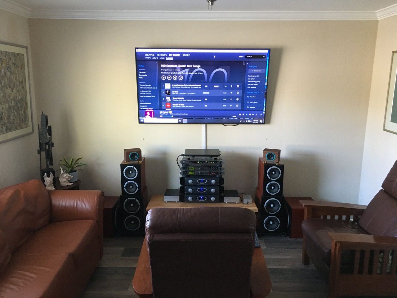

The thing that really impresses me about the 10f, used as an ultra wideband tweeter, is that
1. It has outstanding dispersion for a 3.5” driver, somewhat comparable to a 1” tweeter(Except for extreme off axis angles, which isn’t necessarily a bad thing)
2. The CSD is as good as any tweeter in the high frequencies
3. High order harmonic distortion is, for all intents and purposes, non existent in the treble range
4. It’s extremely inexpensive for the performance you get
5. It’s as “efficient” as it needs to be in this role, especially if the 4ohm version is used.
6. It would be essentially bulletproof
Oh yeah, and the most important aspect of using it this way is to get the crossover Completely out of the ears sensitive region. It seems very counterintuitive to plop a crossover right smack in the middle of the 1 to 5khz range, where most of the delicate spacial cues are located along with most of the important aspects of HRTF

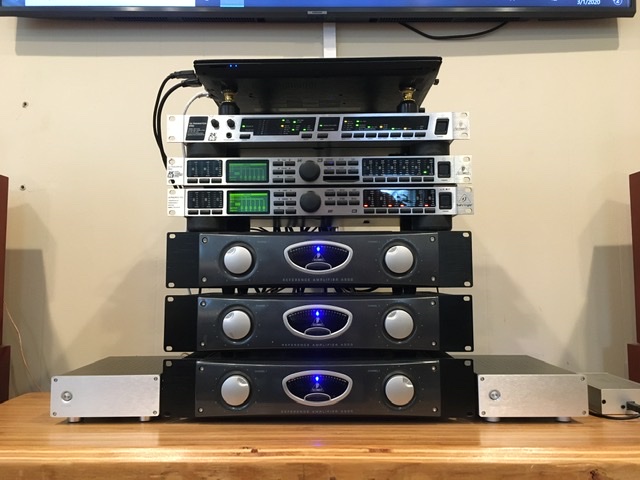

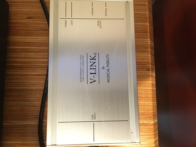

A look at my electronics from top to bottom(Except for the “Musical Fidelity V link”, to the far right, which converts the USB signal from the computer to an SPDIF signal, which can then be used by the DSP devices in the system)
1. On top is the computer, which is used for streaming from the Amazon HD service. It’s also connected to the 65” tv for viewing selections.
2. The V link, as mentioned above.
3. Behringer ultramatch pro, which upsamples and reclocks data(jitter reduction). The digital output is then split and fed into..
4. Two Behringer Ultradrives, one for bass frequencies the other for mids and highs.
5. Three Behringer amplifiers, used only for bass(The top one operates up to 600hz.
6. IcePower amps(from kits)
(To the sides of the Behringer amps, which are being run(In this case) from 600hz and up

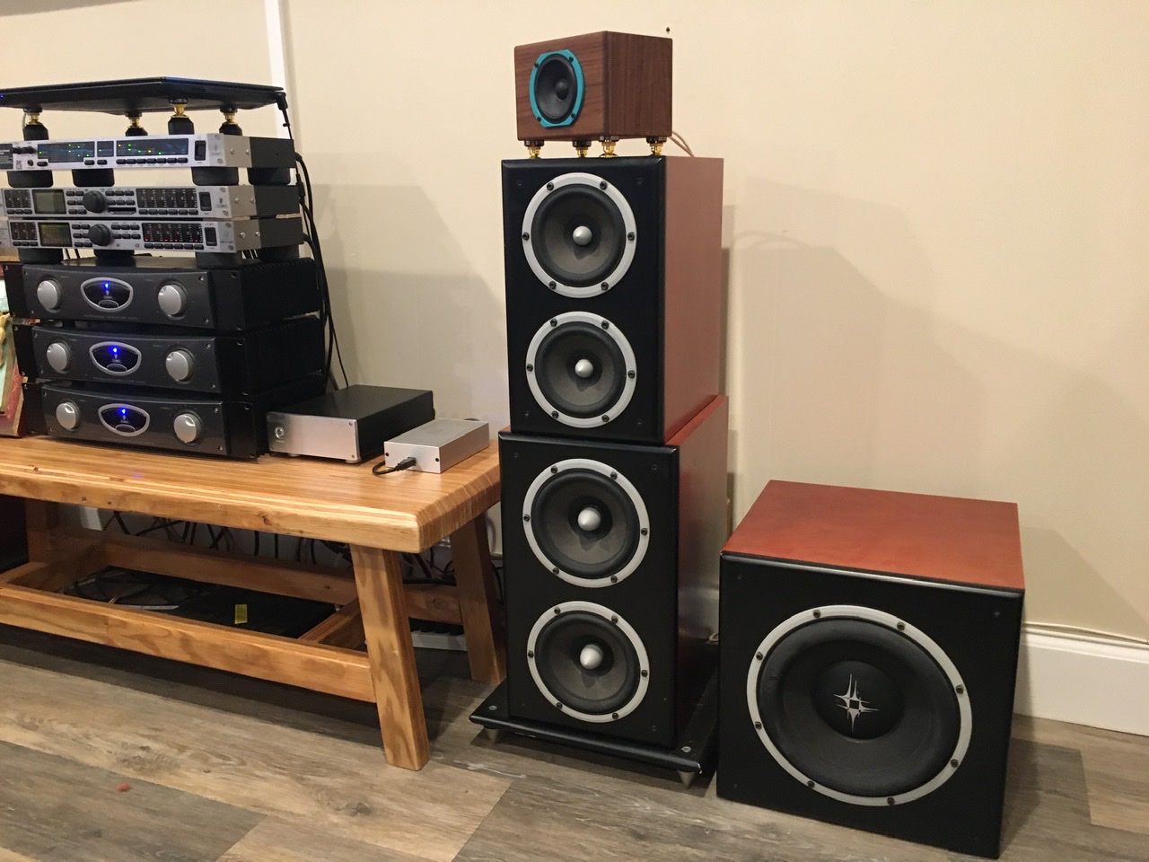

A look at my bass and midbass speakers..
10” Peerless XXLS Subs. One per channel and crossed over at 60hz, 8th order
6.5” Peerless HDS bass drivers, crossed over at 60 and 300hz, 8th order
5” Peerless HDS midbass drivers, crossed over at 300 and 600hz, 8th order
I designed the system this way to allow extreme control of the bass and midbass frequencies, without forcing any of the drivers to do electromechanical backflips in the process.

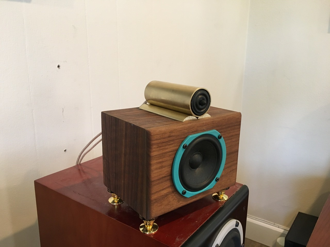

For the last step, I’ve added a super tweeter with an
8th order crossover at 7khz. This tweeter operates flat up to 40khz
Once again, my main objective with this project was to keep the crossover points well away from the ear’s sensitive range. The 8ohm 10f is extremely flat up to 7khz, where the fr starts to gently rise. ThIs is the perfect place for the Super tweeter to take over.
If anyone is interested, the brass parts came from “Online Metals” and the tweeter is the Peerless Ot19nc00-04
The Ot19’s rear cup is metal( it looks like plastic), so care needs to be taken to make sure the terminals don’t short out on the rear cups or the brass tube.

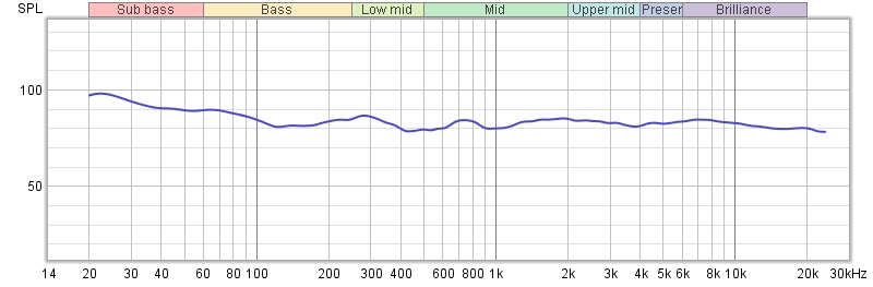

un-equalized system response at listening seat. 1/3 octave smoothing. Vertical scale is a little too compressed(Sorry), but I'm maintaining +/- 3db from 100hz to 20khz
