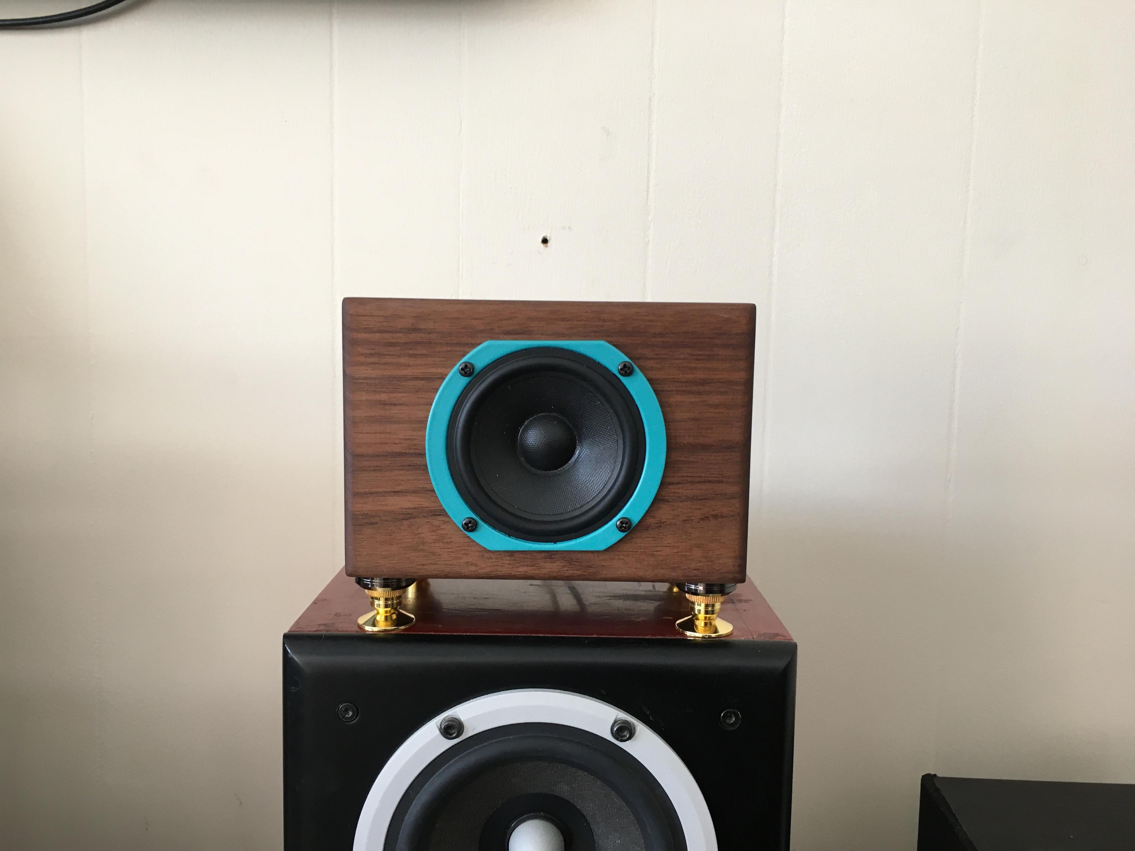

Couldn’t pass up the great deal on these at Madisound. Identical to the Regular Scanspeak 10/f-8424. Running them from 500hz and up. Super flat response up to 15khz

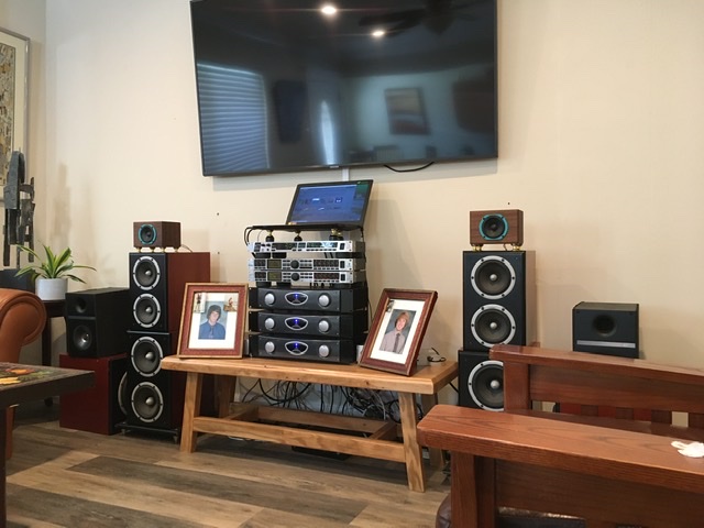

How they look in the system.
IcePower amps on the 10f’s
Mild -2.5db parametric eq Centered
at 15khz, With the q set at .1
More info..
Knock down micro cabinets from Parts Express
Walnut veneer
1/4” solid walnut baffles with auto panel sound deadening on the back
Stuffed entirely with high density polyester felt Panels.
Spikes sold in packs of eight on Amazon for $25.00
Ran them in with a 90hz sine wave for four hours, and now I’m listening critically for the first time. Soundstaging(different from imaging, which can happen without “depth”)is staggeringly good. I’m assuming this is due to the lack of any crossover anywhere near the ear’s sensitive range between 1 and 5khz.
The new SB Acoustics 3” fiberglass cone is very interesting too. Could be another cost effective version, similar to the Tymphany TC9’s. The peak at 15khz would have to be tamed though. Otherwise, the response is scarily flat for a wideband driver.
