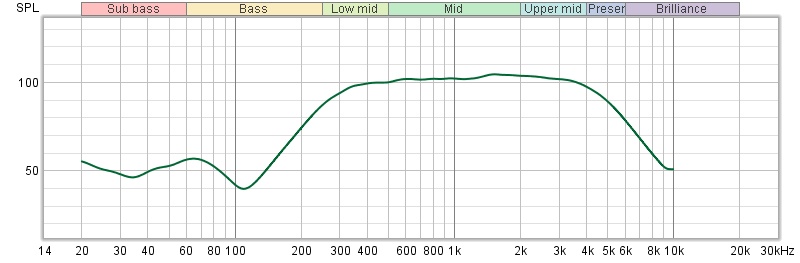

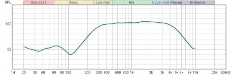

I am getting the bump on the 10f's at one meter. At the listening seat, not as much. Slightly off axis is the probable reason. once again , please excuse the squished vertical scale. that bump looks small but its actually about 3db

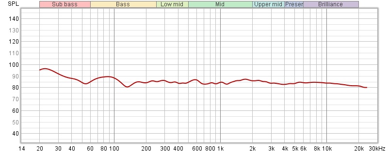

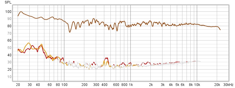

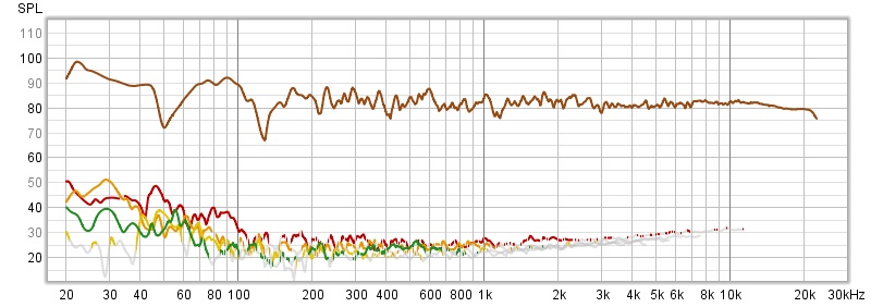

About as flat as I can get it without EQ, eight feet away at the listening seat, 1/3 octave smoothing. Had to abandon 8th order for 4th order. It was just to hard to integrate
thanks for this measurement.
That's pretty good ! This was with the super tweeter ? Don't you like something a little more in the last two octaves ?
The REW program with the miniDSP microphone can only measure up to 24khz(48khz sample rate). The tweeter I'm using is almost ruler flat up to 40khz.
