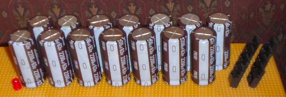

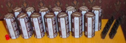

In this case, a scrap of copperless phenolic perfboard, 6 of 6800uF caps (use 3 per rail), a pair of prefab bridge rectifiers (use 1 per secondary) and some lengths of 12ga solid copper cable. I'd also add mild drainers and add some LED's to the rails for safety indication.or can you point me in the direction of a suitable PSU.
Note: The CRC function isn't needed for subwoofer amp. Some power supply examples That page is out of date--those are older models, but they do work. Problem: The output diodes (MBR1645) and their ferrites should actually go at the "amplifier end" of the dc umbilical cable. Those parts are optional but allow maximum performance amplifier board decoupling to work. Even with a subwoofer amp that is useful.

300va 25+25vac transformer, TWO bridge rectifiers, and 13200u per rail simple supply.
As small as 250va may be used, but I'd prefer better than that on a stereo build.
An even smaller transformer may be used, with the caveat that it won't make as much power.
(but if you want more power instead, see post #41 just above)

Due to the well working filters (added to the amp board with mods) shown in the photo attachements at Post#30, there is no need for a CRC type power supply board. Therefore, for the documentation at Post#1, I'm uploading an edited power supply photo that is simpler.
This is 7x2200uF per rail and it has two bridge rectifiers made from 8 diodes
(Or much easier with 5x3300uF per rail and a pair of prefab bridge rectifiers.)
