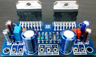

TDA7293 Parallel kit from ebay (modular/slave style, no lossy emitter resistors)
The easy little kit
This chip has Fet output built in, so it doesn't need lossy resistors at the output for paralleling.
279672d1335671579-tda7293-parallel-kit-ebay-modular-slave-style-no-lossy-emitter-resistors-tda7293parallelkit.jpg
Making two chips as easy as one.

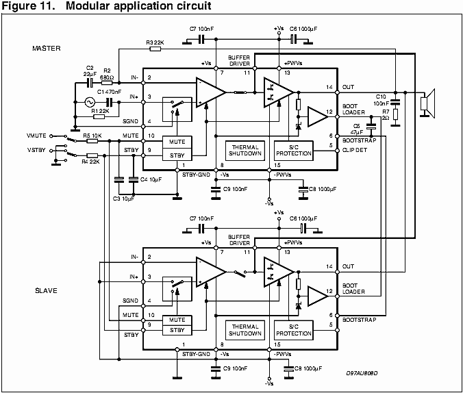

This is documented in the TDA7293 datasheet as a modular approach.​

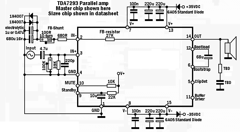

Fortunately, the kit came with 220uF power caps for the amp board, which is perfect for clear sound and cool running of TDA7293. This setup with 220uF (or 330uF) power caps assumes that there will be larger power supply capacitance (a real power supply board).
Voltage:
If you push for quality, the Antek AN-3222 transformer is low priced, drops only 2v @13a and has ideal specs for use with TDA7293. If you push for power instead, AN-4228 is about max. However, 25+25vac dual secondaries transformer is typical and that's what I'm using.
Cap values:
I'm changing the 47uF bootstrap cap to 100uF to assist low bass (valid range 68uF to 100uF).
I will omit the 10uF Mute cap (location is right side of the board, near speaker jack) for zero delay.
A highly effective power circuit upgrade is shown at post#30.
Instead of the 22uF FB-shunt cap (which is far too small), I'm using a 680uF 16v cap paralleled with a 0.47uF electrolytic cap for good treble. I'm also using a 1n4007 antiparallel pair as safety clipper to restrict this big cap's discharge to 0.65v. Photo is at post#29
The 105, 1uF box cap is your input cap, but there's other fun options to use, such as 4.7uF (or smaller) Elna Cerafine paralleled with a tiny polyester (to DIY your own low cost blackgate), etc. . . Try some variety and choose which you like.
Resistor values:
The leftmost 22K resistor is Input Load. Valid range is from 15k to 28k. A difference in value can alter the midrange loudness. If you don't need the adjustable feature shown in the schematic with 100kVR||39k, then just use a simple 22k or 25k resistor for input load.
The gain divider is the factory standard 22K/680R and although this will work, I disagree with bad performance that generic values cause. Instead, I would like to use 27K/730R for great quality. If you want quality results, the feedback resistor and the feedback-shunt resistor(s), MUST be placed underneath the board, close to the FB-Shunt cap. The feedback resistor is installed from pin14 to pin2. The feedback shunt resistor(s) are installed from pin2 to FB-shunt cap. It fits easily and shown at post#24.
349465d1368903275-tda7293-parallel-kit-ebay-modular-slave-style-no-lossy-emitter-resistors-tda7293.gif
The above is new text and new schematic. Previously, there had been some problem getting sufficient gain; however, a just-right gain divider setting with resistors direct (not inserted to pcb), and a power circuit update was the combination that got this little amp up to high fidelity.
See assembly photos starting at post#24

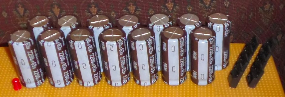

Due to the power circuit mods for power filtering at the amp board (in the photo attachments at Post#30) we didn't need a CRC type power board, so here's a simpler edition.
429934d1406261198-tda7293-parallel-kit-ebay-modular-slave-style-no-lossy-emitter-resistors-7x2200-simple.jpg
(5x3300u caps per rail and a pair of prefab bridge rectifiers is similar but easier.)

Yes, new content that uses the schematic (above) starts at post#24--previous discussion might not be applicable to the new schematic, so you will probably want to skip ahead to post 24.

Daniel - a link to the Ebay auction or seller please?
These look great. Very interested.
-Charlie
Sure. There are several vendors. Here is one. Parallel TDA7293 You can find others just by comparing with the photograph in post1.
P.S.
These boards are monophonic--it takes 2 for stereo. These will drive 4 ohm speakers easily.

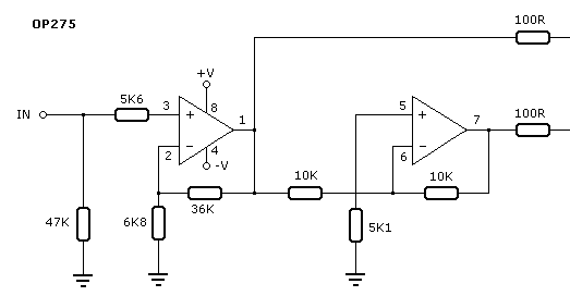

Bridging:
A bridge adapter, such as homemade version with op275, provides an additional, yet upside down, copy of the source signal. Even if built for unity, 1x, this device is effectively unity doubled (two copies), or 2x. It uses regulated/capmulti power and approximately the same parts as any good preamp. At end result, the output gets twice as big without increasing the demand from the source device.
See Rod Elliot bridge adapter circuit and you can read the good explanations there. And, see the very similar schematic attached below:

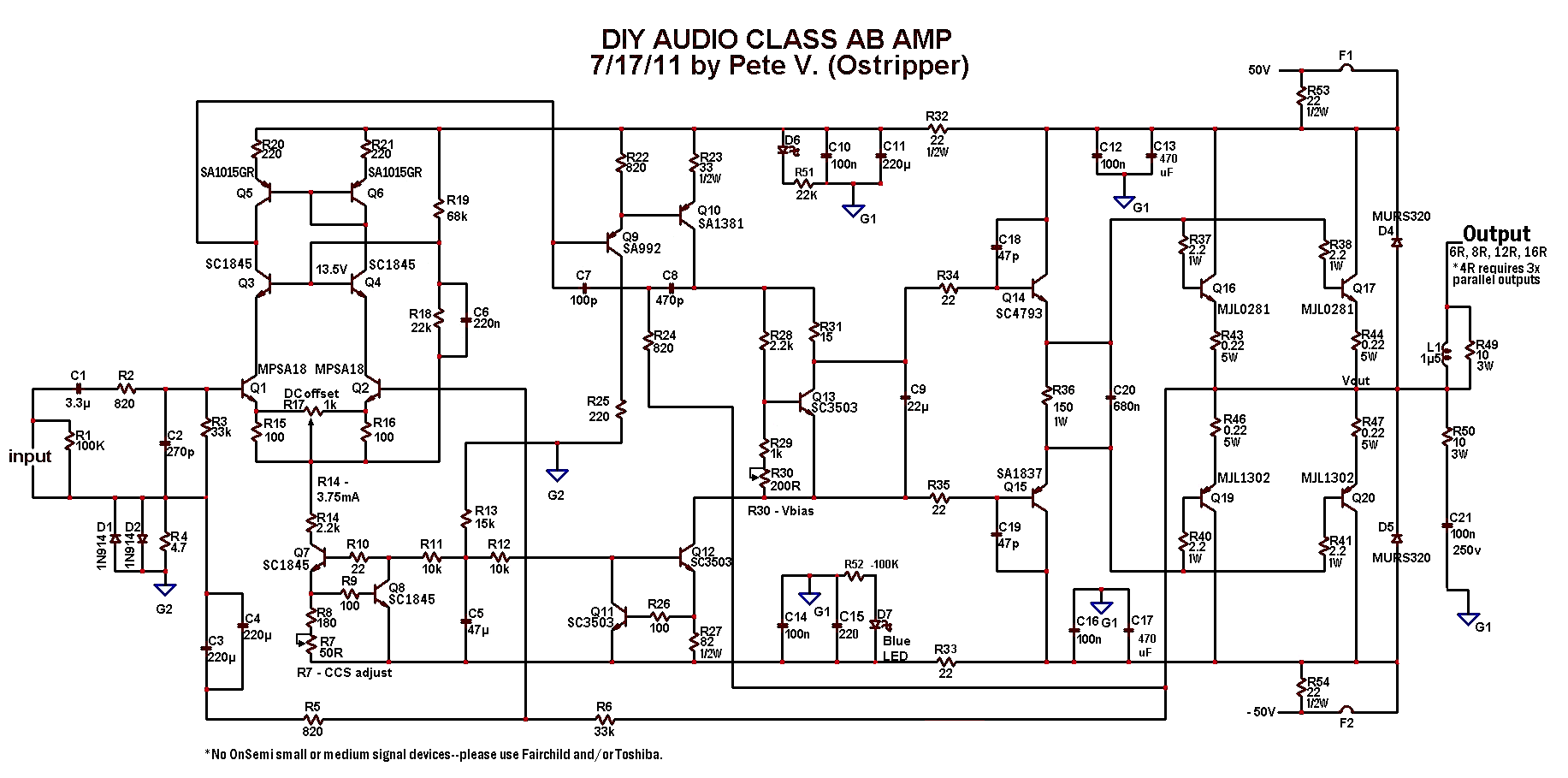

With those 30+30 vac transformers, I suggest to use the discrete Honey Badger project instead. Yes, it is a big project, but it handles your transformers, and the board from the diyaudio.com store turns complexity into something as easy as soldering practice. OStripper's test transformer has very similar voltage to yours, so you'd be easily in the voltage "sweet spot" for high quality results.
Here's the boards:
The diyAB "Honey Badger" Class AB Power Amp - 150W/Channel (2 Channels) - PCBs
Here's a build tutorial:
http://www.diyaudio.com/media/build-guides/diyaudio-diyab-build-guide-v1.0.pdf
Here's a schematic example for easily matching Mouser parts:
http://www.diyaudio.com/forums/atta...746574-diyab-amp-honey-badger-honeybadger.gif
Here's a link to Honey Badger build thread:
http://www.diyaudio.com/forums/solid-state/211905-diyab-amp-honey-badger-build-thread.html

For kits, I'd distrust anything that has the power supply on same board as the amp. The "included" power supplies are normally minimum "get by" designs that fit into the smallest space possible, which makes the board cost lowest possible, also at the cost of least possible audio quality. oops.
SO, I like the very tiny double-sided amp boards + DIY power supply board.
Those are clean.
From obviously the same designer as this compact parallel board, you can also find even smaller solo chip boards, and those can work well with 8 ohm speakers. I've seen both TDA7293 and TDA7294 kits available with a pair of the tiny double-sided boards.
The design is so elegant!
In my opinion, only the smallest of double-sided boards have thoroughly tamed the TDA7293, TDA7294, crazy pinout. So, it is the smallest boards that can give the clean performance, like a point to point, except easier to build.
The kits do all seem to come with bankrupt component values, either like the datasheet, or insignificantly better (and there's not much way to do worse), which is all a hot-running mid-fi of some sort. Sometimes the included caps are all very small for the only reason that tiny caps are less likely to be mashed in the mail. :) So, some of the designs have components selected for non-audio reasons.
However, some of the boards are good and you can plug in whatever components you'd like to use. I'm just glad that they finally invented nice little double-sided boards to support these chips! :D
