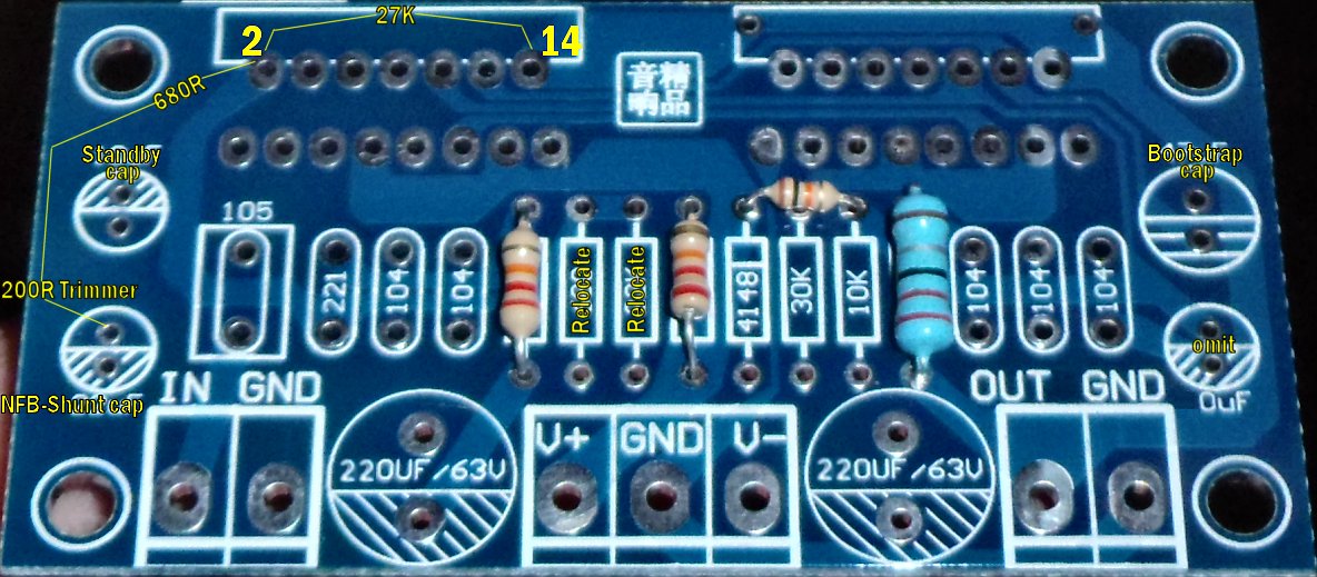

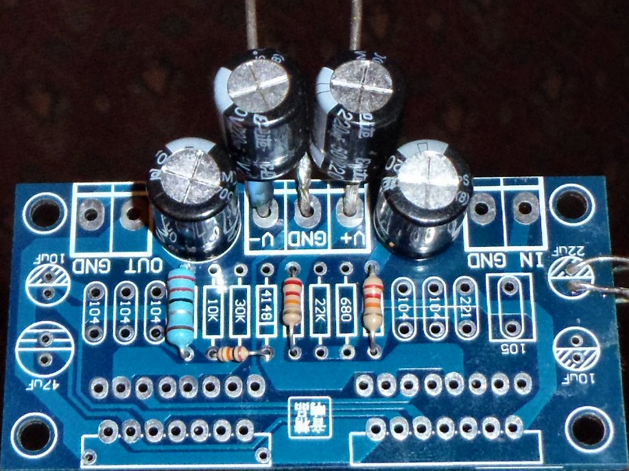

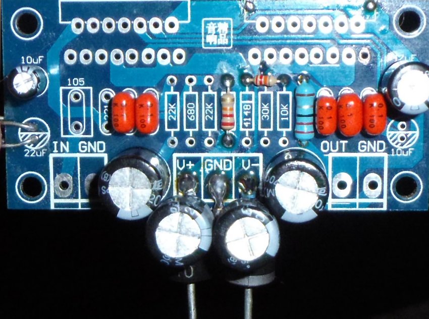

I'm putting together the other channel now. Here's what it looks like.
In the picture, it shows the feedback resistor (27K under-board and it shows the feedback-shunt resistors (680R+200R trimmer) under board.
The mute is simplified with "just 10k" as shown (22k also works fine). I used a little 1/8 watt resistor for the mute, however, a full size resistor can be used--it just stands up a little bit. The board's datasheet application for mute is more elegant while the amplifier is off. However, for mute I prefer just one resistor and omit the mute cap to simplify the power circuit for clearer sound while the amp is on. The difference is minor.
The Standby with 22k resistor and 10u cap is done per the datasheet.

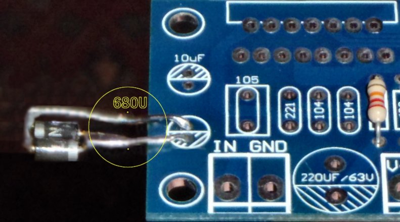

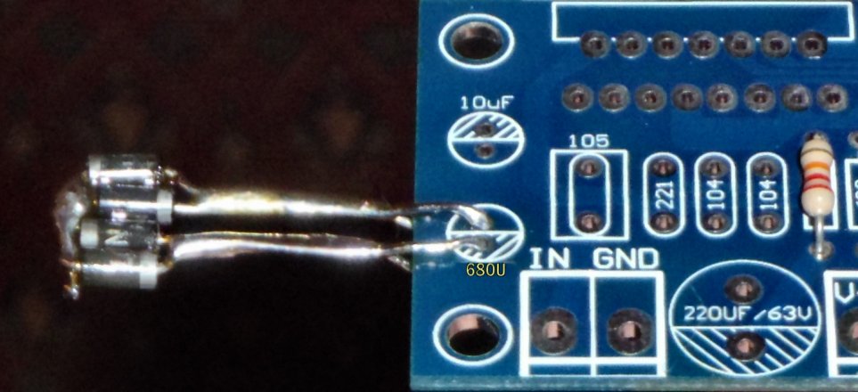

A 1N4007 starts to switch on (stutters on) at about 0.47VDC. This might not be quite enough "leeway" for some slightly tilted rails and other error conditions that may or may not occur on some builds. Therefore, I'm going to show antiparallel diodes (0.47VAC) series to antiparallel diodes (0.47VAC) resulting in 0.94V tolerance. In this case, the NFB-Shunt Cap cannot charge up to more than 0.94V.
Tomom said:
Daniel, please can you show where and how do you connect that anti-parallel pair of 1N4007..thanks.
I'll show twice that much.
In the photo below I have:
Pin2, diode>|, diode>|, ground
Pin2, |<diode, |<diode, ground
And, in the photo below, I have left the pins quite long because I have several possible suitable caps to use for NFB-Shunt Cap and I'm going to "test drive" them in combination/conglomerate with a 1u or 0.47u electrolytic for treble bypass cap. Dual-layer boards are quite difficult to desolder and swap caps, so I've left some room to do that. The caps will quite easily straddle the diode pins. That might also be useful in case your caps are too big to fit on the board.

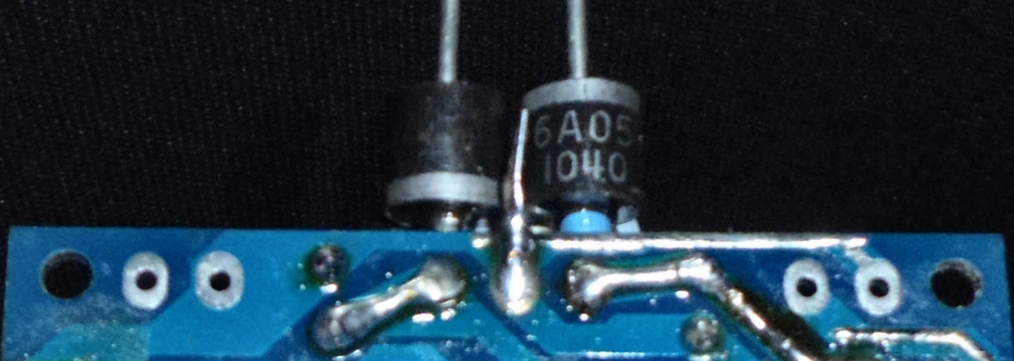

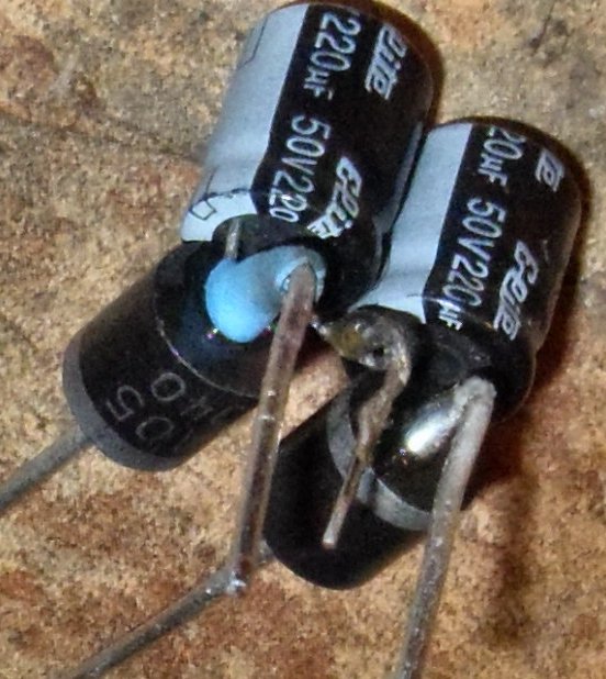

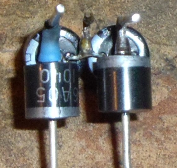

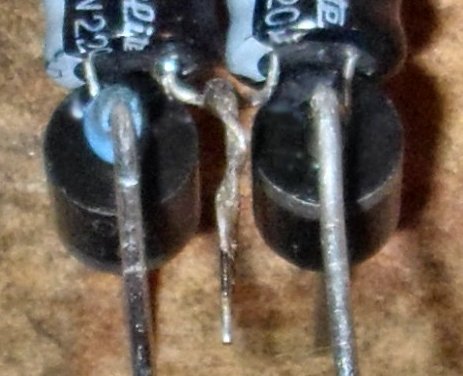

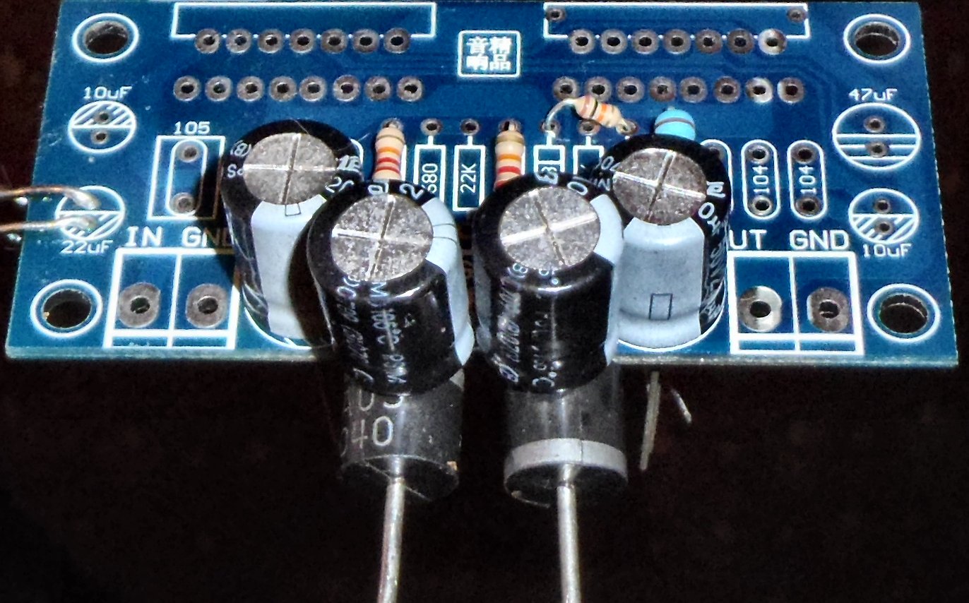

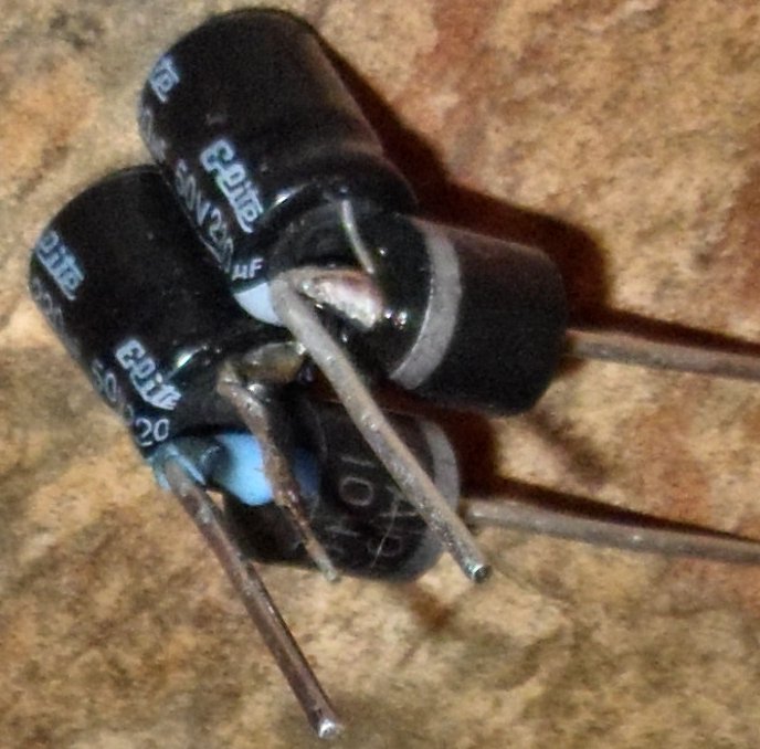

Power photo bonanza. . . Shield power with 6A05's and 440u.
On my board, I have a parallel pair of 220u caps and a standard diode, per each rail.
There was one caveat--a ground trace on top of the board, in front of the V- terminal, needed some extra insulation, just to be sure. So, that little blue bit in the photos is a scrap of heat shrink tubing.
These photos with 440u and 6A05 per rail, are just an expansion of the previous effort. Substitutes for 6A05 include 6A01, 6A02, 10A05, 10A01, 10A02. I got my 6A05's from the radio shack store. The larger voltage drop can allow up to 660u per rail and still sounds like small caps, all fresh and clean. Curiously the greater voltage drop in combination with the greater capacitance results in More useful audio power. I could not possibly explain why, except that the amp behaves as if the proportion of useful power is greater. A real engineer is needed before an explanation makes sense.
Functional Parameters:
If what is shown in the photos is too much work, simple 220u and MBR1635 (or MBR1645) per rail works great, is low loss, and still performs on stereo separation.
Works vs doesn't work:
220u per rail and 6A05 works. (0.65vfw, 100u~660u range)
440u per rail and MBR1645 doesn't work. (0.25vfw, 100u~220u range)
In these parameters I see that the bigger capacitance causes the need of the bigger voltage drop--the bigger voltage drop does Not cause the need of bigger capacitance. So, if you're using substitute parts, perhaps these parameters will help.
Notes:
Whatever diodes you really hate for discrete bridge rectifiers (switching) can be used for this forward biased (non-switching) application, since the usage is much different.
Reverse voltage tolerance is not used by this application; however, for forward bias applications, low voltage diodes (35v~100v) will work better than high voltage diodes (400v~1000v) and you can see why if you look at your diode's datasheet forward voltage drop graph. Choose a diode with a forward voltage drop per current graph that looks like this: "|" not like this: "/".
If driving heavy loads at full tilt for long duration at full blast, you might rather have 10A05's which are far stronger than the amplifier.
Estimate: Apparently, if using the very bottom of the chart (stutter/first switch on, smallest figure) one could multiply the diode's smallest forward voltage drop in the diode's datasheet by 1000 to approximate the maximum capacitance per rail it can shield for the amplifier board. The actual figure may be somewhat less than 1000, so be sure to leave room (voltage drop) for the application to work.
A simpler (220u+MBR) version will work for this board is minimal effort and sounds great.
However, I'm doing this larger (440u+6A05) version because it further reduces the need of compensation (in some way that I do not understand) and the greater tolerance may allow the gain to be dialed even lower. Orthodox: It may do nothing other than promote greater stereo separation, because it is Virtual Dual Mono, aka Dualmono/Monoblocs with only 1 transformer, only 1 power supply board. Unorthodox: The 6A05's have allowed using larger capacitance on the amplifier board without also incurring either extra heat or dull sound that can be observed if the diodes are omitted. So, you can see why I used the diodes. I don't know exactly how this works, but it is reliable and the function is fantastic. I don't have any more data on this, so here's the photos. . .
