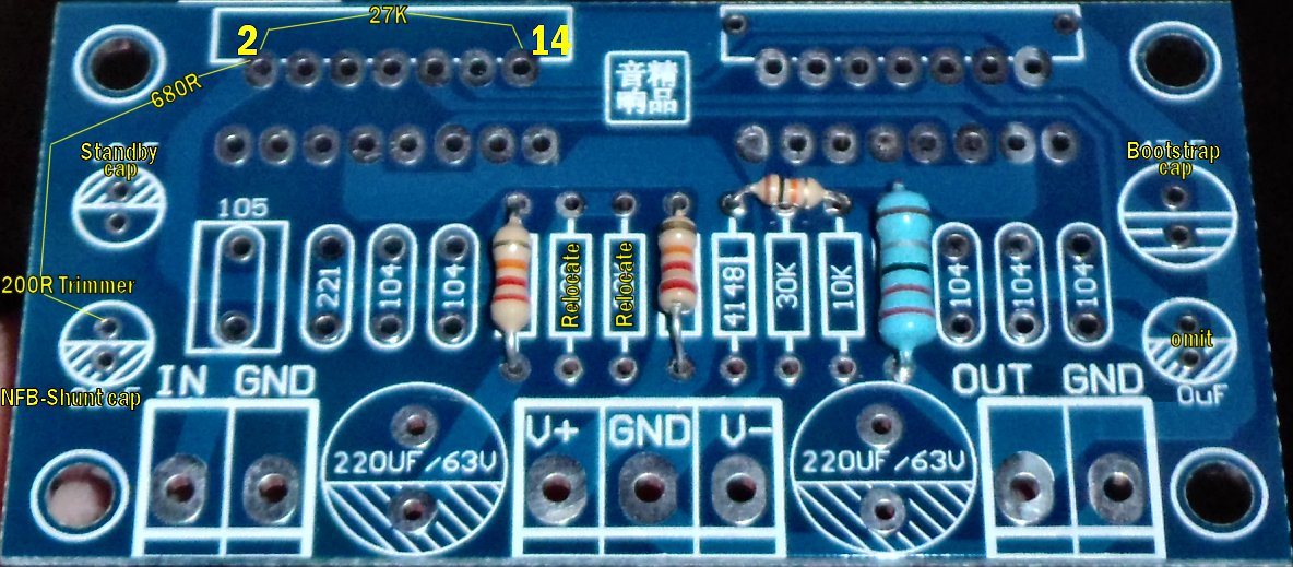

To avoid bad tone, some inductance must be removed by Moving at least 1 resistor.
This was posted earlier, however, it does contain a top priority layout fix.
I'm not talking about the feedback resistor, but rather its partner, the feedback-shunt resistor really must be moved. See the left side of the board, the Feedback-Shunt resistor, 680R+200VR (startup value Total is about 727R).
The most important thing about this photo is that the feedback-shunt resistor has been relocated from its inadvisable yet decorative location. . . to a much more direct route instead.
The photo shows the Feedback-Shunt resistor (680R + 50VR) directly from Pin2 to the NFB-Shunt Cap. This change in location to a direct route has removed an extraneous inductor (the overlong trace).
The fix is this: Shortest, most direct route, is least inductance.
This one easy fix will do more than any amount of labor or expense with signal parts selection. Even the most expensive audiophile cap can perform like a really bad cap if when in series to excessive inductance. Specifically, there's no need to play with audiophile or bypass caps until after the resistor has been moved off of the overlong trace, and relocated to direct route instead. After moving the feedback-shunt resistor as shown in the photo, then your signal capacitor Brands&Bypass play, can work as expected.
Basically:
Please don't attempt captweak labor, or other fine tuning, before moving the resistor(s).
Please move resistor(s) first, since layout is more important than capacitor brand names.

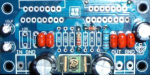

Optionally, MUR diode can be used. Or MURS diodes with the nicely insulated tab may be even better.If what is shown in the photos is too much work, simple 220u and MBR1635 (or MBR1645) per rail works great, is low loss, and still performs on stereo separation.
Clean look? Okay. See photo. It is an illustration. But it shows a simplified means to get nearly the same performance, and that clean look too.pinnocchio said:I don't really mind paying for an optimized PCB since I like a clean look, even though it will be hidden in a chassis. If someone has the skills and is interested in doing a PCB layout using part SMD and through hole it would be great!

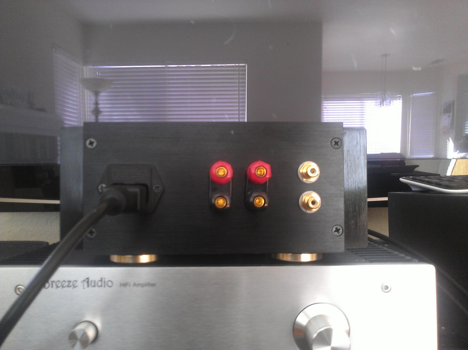

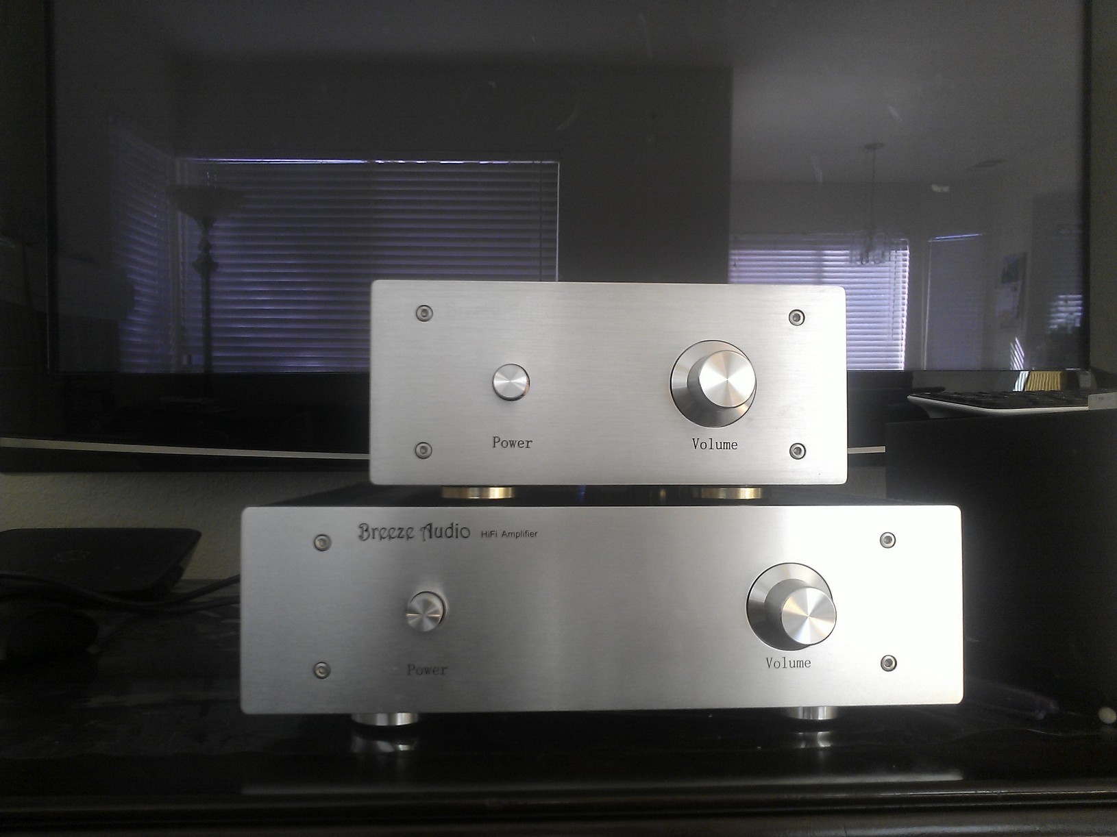

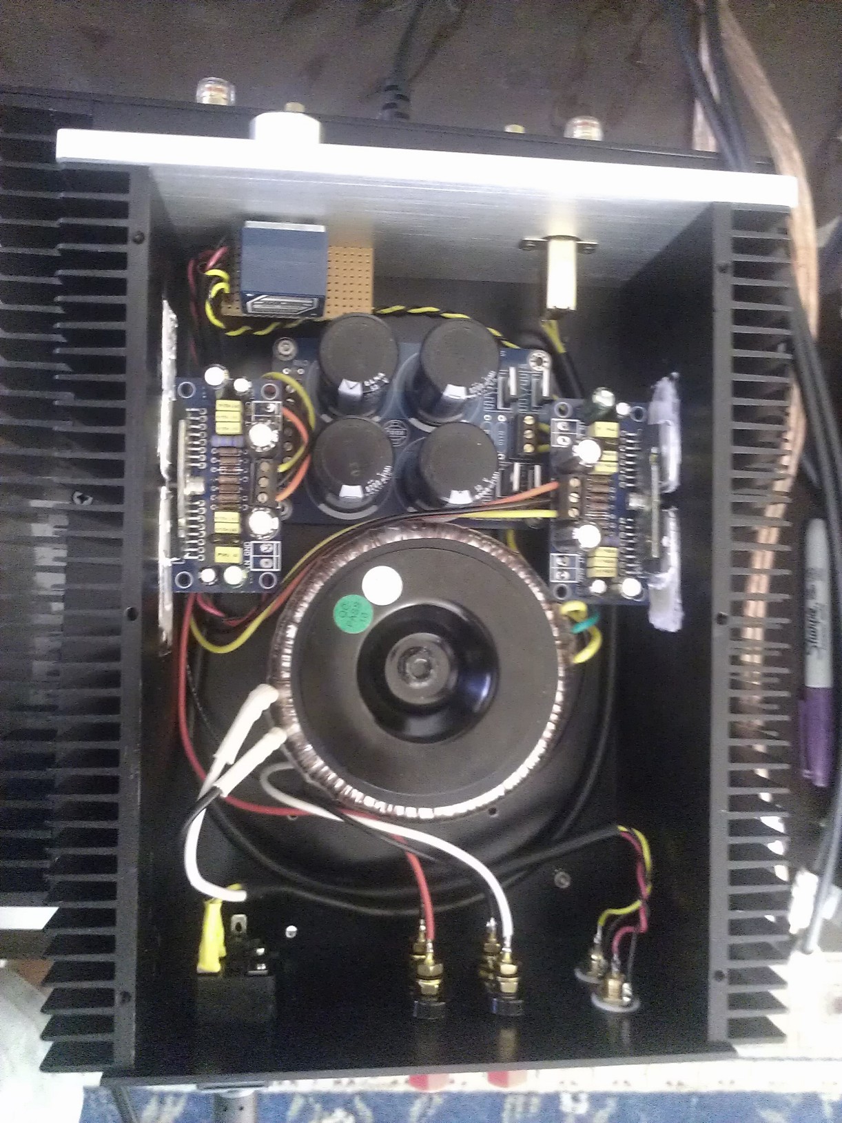

Here is mine
Hi Folks,
Here is mine. I bought PCB, power supply PCB and case from eBay. Case came with power, speaker and RCA connectors. Built according to schematics except Rf, Ri changed to 47k, 1,5k - Feedback capacitor changed from 22uf to 220uf and the bootstrap to 150uf.
It sounds wonderful, in the pictures it is sitting on top of VSSA. Main differences between these two are - VSSA is bit more transparent you can perceive the layers of sound. TDA7293 amp has bit more punch in the bass region. We can find the difference between these amps when we do A/B testing. Otherwise we can equally enjoy the sound of both these amps and you forget the differences.
Finally, I would like to Chinese sellers on eBay, without them I couldn't build this high quality amp with such a low price. I do remember how hard to get the PCBs, only way is to order in bulk. Forget about the chassis, there was no place to buy a good chassis at reasonable prices.
Hi Folks,
That is a beautiful job on the build! 😀 😀 😀
However, I do have some comments on the electronics.
I see a center tap configuration, which has an opportunity.
Transformer reacting with your bridge rectifier makes noise that can cause masking. But we could hinder the problem. One variable RC made with a 2.2uF polyester cap series to a 50 ohm variable resistor can be hooked up from ~ to ~ (across the transformer) to dampen that area so that the high pitched racket doesn't put masking into the amplifier power circuit. This RC doesn't attach to ground. Turn the dial for best treble imaging clarity.
After that. . .
It may be important to note that, with a chip amp, the entire amplifier board is the small signal area.
This photo matches up with the schematic at Post#1.
The photo shows amplifier board power decoupling forced to work, which is the most certain way to guarantee that it does work. The diodes also provide virtual dual mono stereo separation since each amplifier board has a little bit of somewhat "private" power.
All of the above is good for clarity and imaging.
These diodes are runing on only DC (you Do still use a power supply board). Suitable diodes include standard silicon diodes like 6a05 (at the radio shack) 6a01, 6a02, 10a05, 10a01, 10a02 and similar. This small voltage drop doesn't decrease usable audio output power at all, but it will do less constant power, more peak power, which is more useful, more dynamic and more lifelike.
Also,
This is a gain compensated amplifier and it needs to be set precisely; so, I would suggest to use a multi-turn variable resistor at feedback-shunt resistor. In your example with 1.5k, you can use 1k multi-turn trimmer series to 510 ohm resistor. The ideal location is very close to and directly between the nfb-shunt cap and pin2 of the master chip (which are conveniently close to each other). My schematic has this adjustable gain dial because the ideal compensation (and therefore ideal gain) depends on the power supply voltage used. The sweet spot is very narrow and nearly impossible to get with fixed resistor values. Consider it an audio quality dial.
