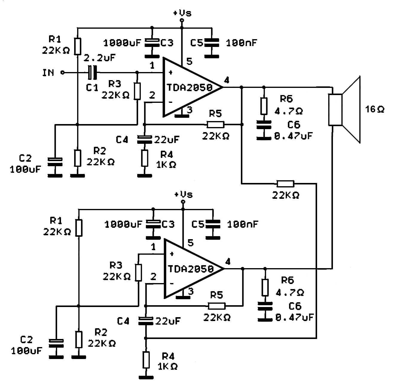

Running these in bridged configuration increases the distortion slightly.
Is that due to how they get the signal for the other amp and would distortion be less if both amps were fed from a phase splitter provided the phase splitter has extremely low distortion itself?

Yes, but if that level of THD matters then maybe you should not bother with chip-amps. I had a cheap stereo with bridged chip-amps that I altered the way they were bridged, and it sounded very nice as a result, mostly because I got rid of most of the capacitors, and then my wife sold it in a garage sale. 🙄

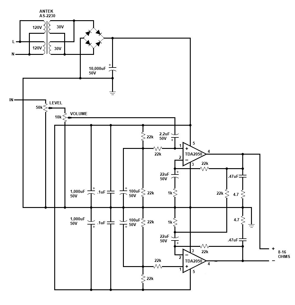

I need 40Vac at 30Hz to power some 120V mirror ball motors with the whole thing drawing under 40 watts.
I currently have a class d amp with a small step up transformer, however that causes some RFI. Now if this amp running bridged can put out at least 45Vrms then I can eliminate the transformer and class d amp which eliminates the RFI and makes the whole thing smaller.

Wiring the amp for bridged mode was very easy. R4 is close to the input terminal block so all I had to do was remove the volume control from the board and solder a 22k resistor from the junction of R4 and C4 to the + audio input terminal and solder a wire to pin 4 of the chip on the amp connected to the + speaker lead.
Now when I remove the output coupling caps, I will need to just run a wire from the + speaker terminal on the speaker jack to the + audio input terminal.

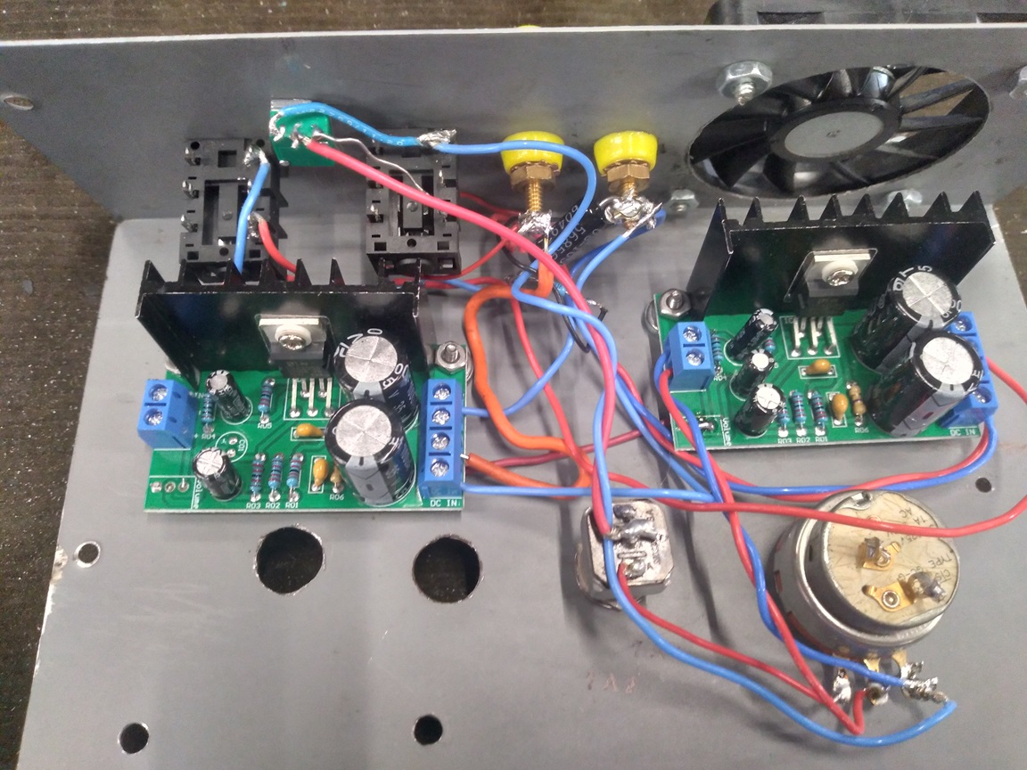

The amp is now this.
Here's a photo of the second amp installed. All I need to do is add a couple holes to the bottom of the chassis where the heatsink will be over so some air can move over the second heatsink.

What I might do is get an AnTek transformer and build somewhere between a 24-40V power supply. I might also include a speaker protection circuit in the power supply.

Here's a better schematic of the amp. I will order the bridge rectifier, transformer and capacitor this Thursday when I get paid. Nice thing is since I am using a toroidal transformer I can put a two prong cord on the power transformer and a couple banana plugs on the secondary and won't even need a case for the transformer. The bridge rectifier and cap will be mounted inside the amplifier case.
