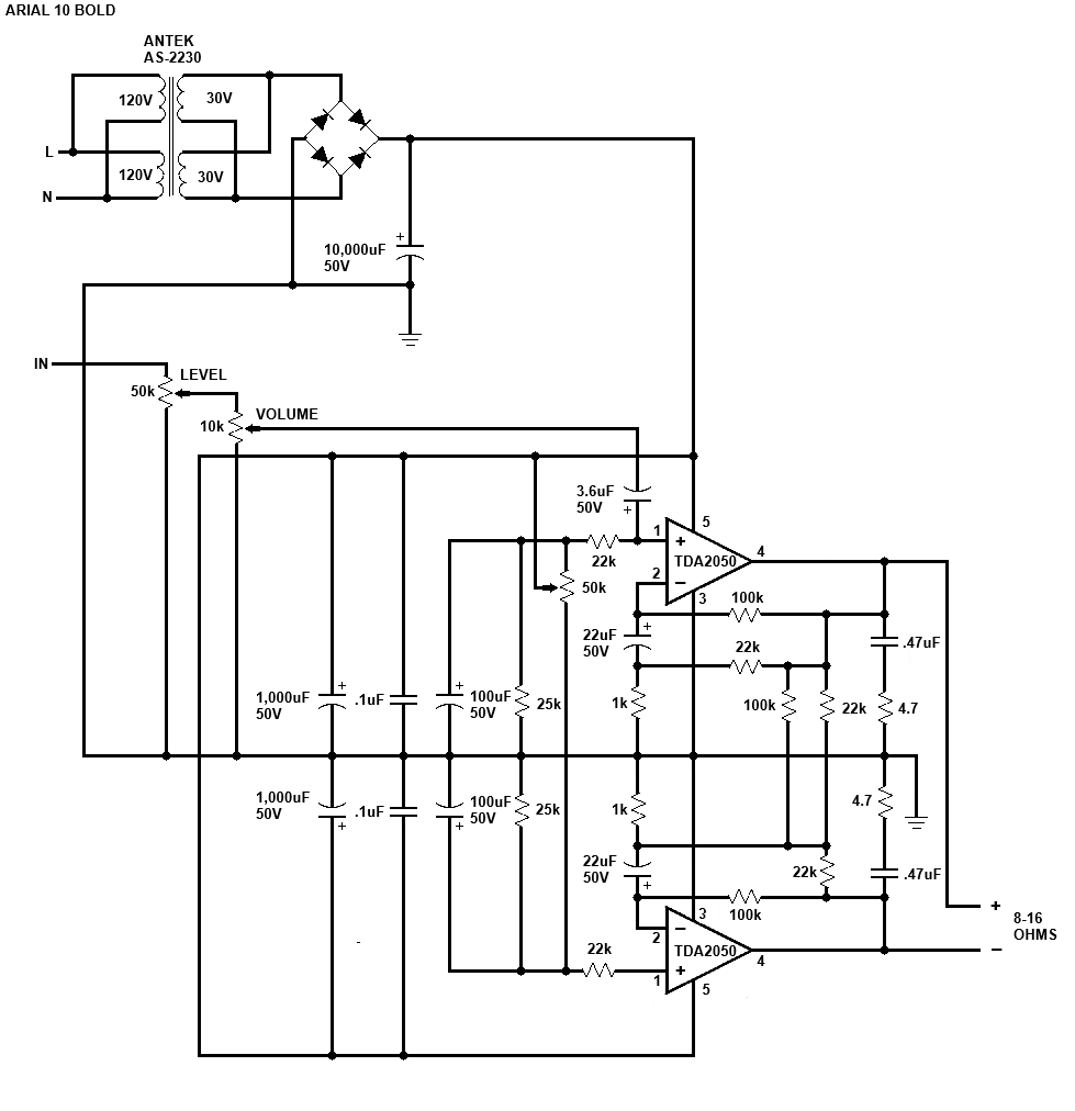

And bam just like that it hit me.

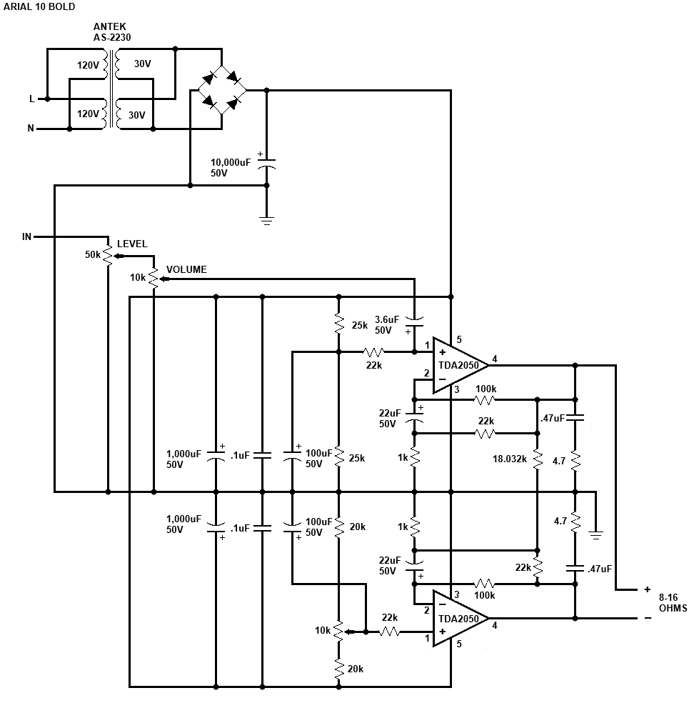

There's a 10k pot on the lower portion to adjust the C offset. That will affect the charge time of the 100uF cap which is likely why there is a DC voltage on the output when the amp is first turned on.
The solution is to replace the two 22k bias resistors in the top portion of the amp with 25k resistors. That way the charge time of the 100uF caps is real close to the same.
Also the idea about how to redo the gain so the 22uF caps do not have a lower resistance path to ground worked well except I goofed and failed to realize I needed a 100k resistor in parallel with the 22k resistor sending the signal to the other amp section.
So the schematic then becomes this.
Output briefly jumps up to 2Vdc then falls back down.
Gonna measure the voltage across the 22uF cap and see what it is and how long it takes to charge. If that causes the jump in voltage it might be possible to use a lower value there.
I did test the amp and there is no noticeable phase shift anymore.

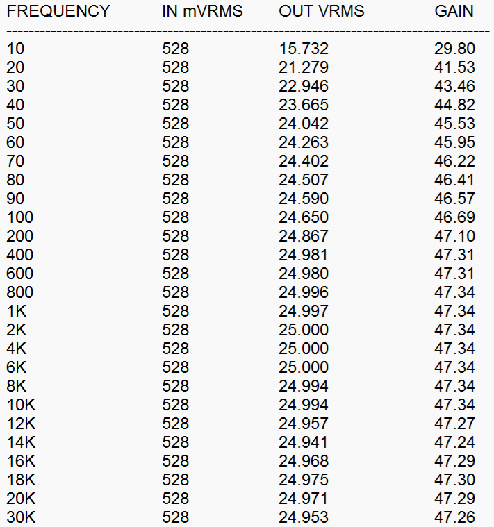

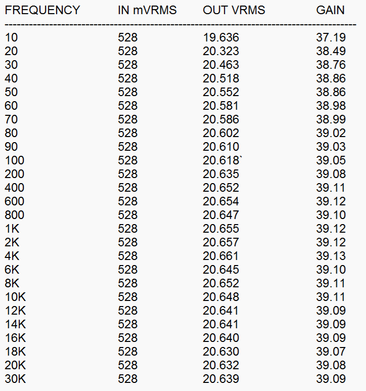

Frequency response test.
Unmodded.
Modded.
Gain dropped slightly which is beneficial for my needs, but the low end frequency response is more flat.

Not goodOutput briefly jumps up to 2Vdc then falls back down.
Increasing feedback resistor values by 10X will increase Johnson noise
The spike is very brief, however it was worse before I replaced the two 22k resistors with 35k resistors.
The pair of unmodded boards did similar, however.
Would altering the bias resistors to be like this work better far as setting the DC offset is concerned or is the bias being like it is not causing the voltage to spike like that?

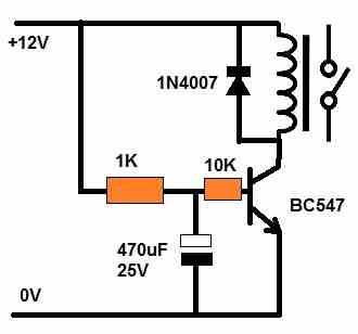

Maybe you can try something like this
That could work. I've done similar before.
That said I'd likely get a speaker protection board kit as it will also protect the speaker in case the DC offset gets way out of whack during operation.
I'd need to figure a way to drop the voltage from 44V to 12V though.
You can use two 24V relays in series , one for each ch. , they will work at 44V. Dropping such higher voltages for 12V relay will dissipate more power in the series resistor or regulator

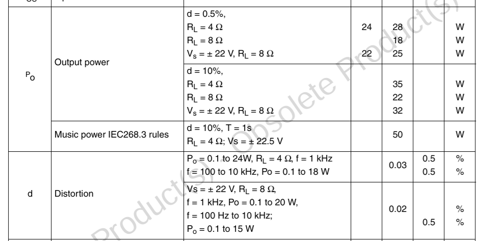

According to the datasheet.
https://www.st.com/resource/en/datasheet/cd00000131.pdf
Looks like I might need to use two of these amps bridged per channel to get enough power.

Instead of going bridged is there a way using power transistors to make the 2050 put out more power with keeping the same low distortion numbers?
These chips are simply limited by the power supply voltage. You may run into current limiting also, but there is no way besides bridging two to get more voltage. If you add extra power transistors in a configuration which has voltage gain there is no point in using a power op amp front end. In those designs a 5532 does just as well if not better.
I saw one circuit where it used a NPN and PNP power transistor for more output power. One transistor was a 2N3055 and the other was whatever the complementary PNP transistor to that is.
That said I know bridging two will for sure get more output power.
