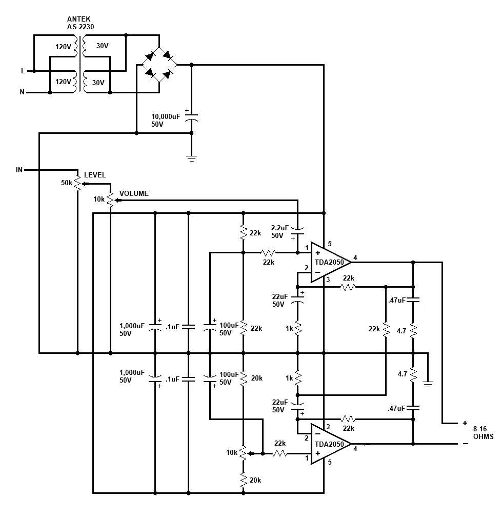

So I decided to take care of the DC offset. I replaced the 22k resistors with 20k resistors and put a 10k pot between both 22k resistors and the other 22k resistor so that I could adjust the offset to 0V. I wonder how much the DC offset would be if both amp chips were on one larger heatsink right beside each other.
Gonna use the other two amp boards and mount them to a single heatsink just to see if the DC offset is affected by the chips being on the same heatsink. Won't be a 100% proper test as the chips won't be right beside each other, but will be about 4" apart on an aluminum heatsink. The results of that test will determine if I do or do not do the DC offset mod as if the chips being on the same heatsink causes the DC offset to be compensated for to where it is under 20mV then there's no real need for the offset adjustment.
What I find interesting is that I can find a 2.1 channel board using the TDA2050, but I cannot find a board that runs two TDA2050 in bridged mode. If I knew how to design circuit boards I'd design one myself. Only I'd likely design it with a +/- supply so that there's no DC on the speaker + terminals which would eliminate the need for bias resistors and a DC offset adjustment.

The only issue with how the TDA2050 is bridged is phase shift caused by the two 22uF caps. There's some initial phase shift by the top 22uF and there's phase shift again by the bottom 22uF.
To eliminate it the 22uF cap has to be 330uF
But I don't feel that I can increase it any.

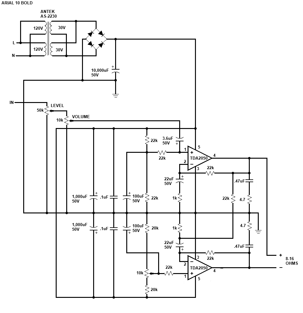

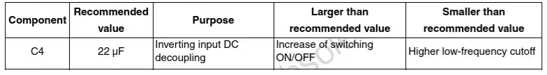

The settling time at switch on is affected. The designers who put together the app note probably staggered all the time constants in the “system” to minimize POP at turn on. If you would rather increase these time constants to get better bass response you either put up with a longer and possibly larger turn on transient, or put a delayed speaker relay at the output so you can “ignore” it
Looks like the time constant goes from 22mS with the 22uF cap to 330mS with the 330uF cap
There was a pop when I had a single amp used with a 1,000uF speaker coupling cap, but with both amps used bridged and no speaker coupling caps there's no pop.
I may parallel a cap with the existing 22uF and use my scope and DMM just to see what happens.
When the amp is bridged some (but not necessarily all) of the time constants are common. Voltages at the + and - outputs may more or less go up and down at the same time during settling.
I tried 160uF caps in parallel with the 22uF caps.
When the amp powers up it starts at 4mV offset for about a second then jumps up to about a volt and drops back down quickly then jumps up to several volts and drops back down quickly.
So using larger caps there is no good.

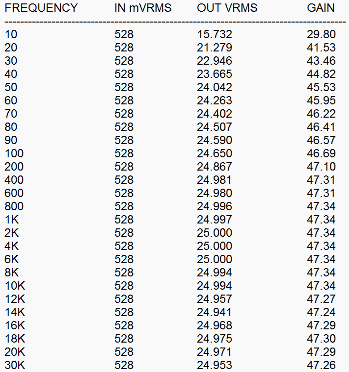

Here's the frequency response with no load.

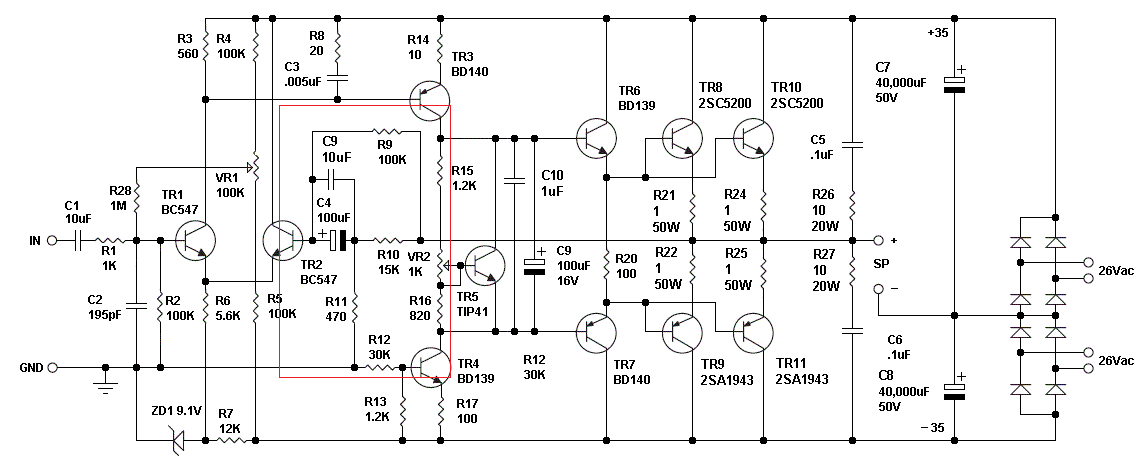

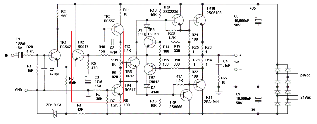

I keep, looking at the 22k 1k resistor junction and thinking there's a real simple way to alter the circuit to achieve the goal of better frequency response without any ill effects on the circuit.
I see how to do it. Look at the red area of the schematics.
Original
Modified
Now how would I modify this amp like that?

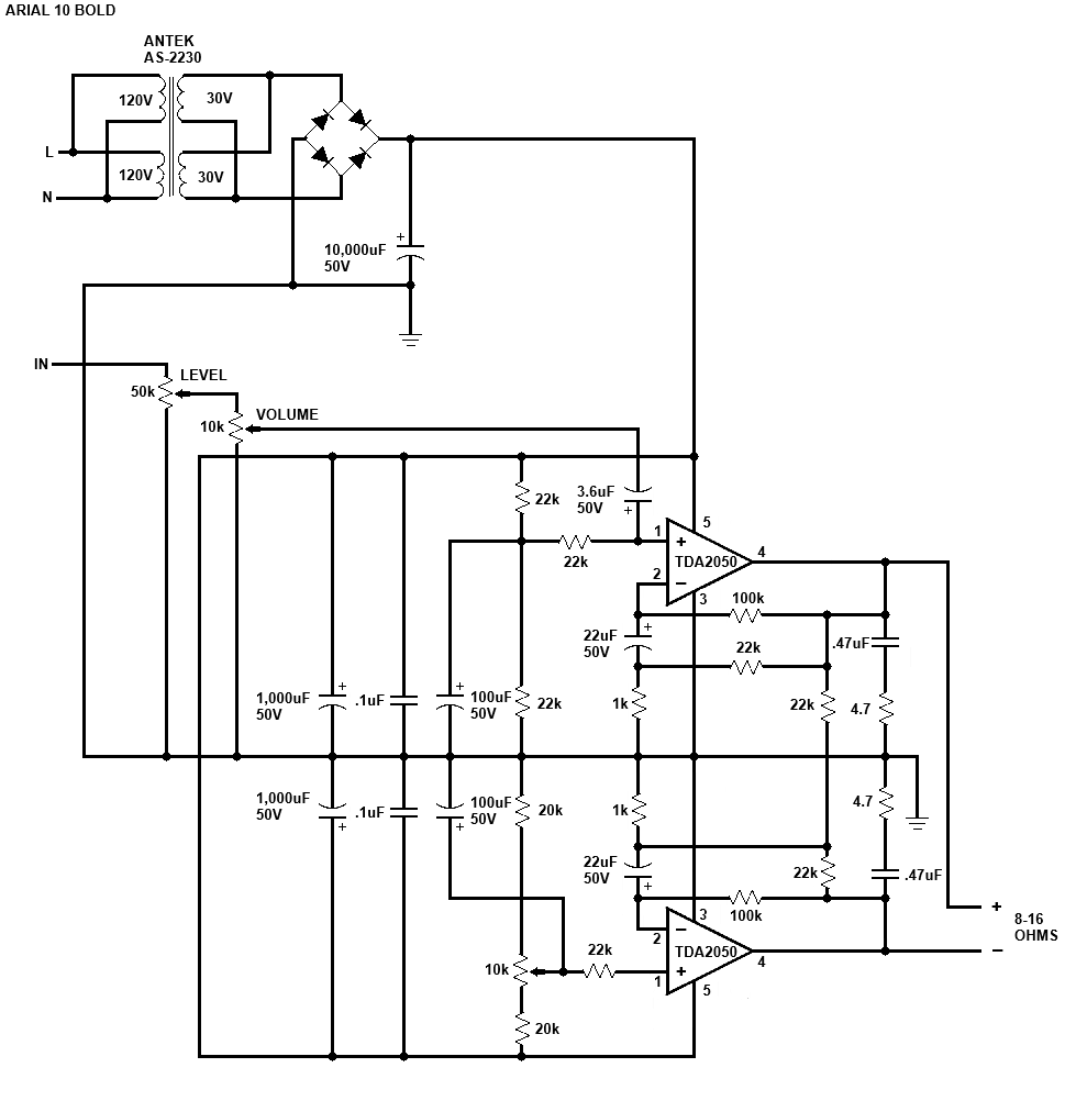

So here's what I'm thinking.
Replace the 22k resistors from pin 4 to pin 2 with 100k resistors which provide the DC feedback.
Install a 22k resistor from pin 4 to the 1k 22uF junction on both amps. That way the 22uF cap doesn't go to ground through any resistor and only has the DC voltage between pin 2 and the 1k 22k junction across it.
Will only require removing one resistor, replacing it with another then adding a resistor and doing the same on the second amp.
Only gonna do one first just to see how it works and so I can compare it to the unmodded amp far as gain and frequency response are concerned.
Will update the schematic after lunch.

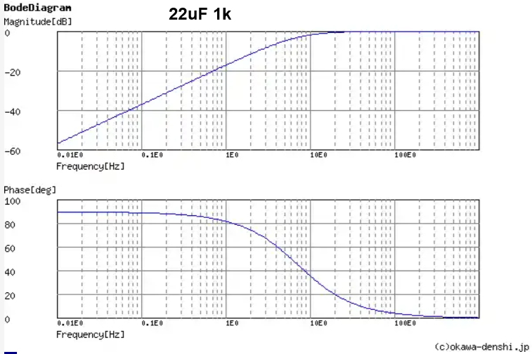

Just make the 22 uF caps bigger. You’ve got 2 cascaded poles at 7 Hz that fully explains your roll off. Yeah it will cause a longer “thump” but it will be common mode, moving both outputs up/down simultaneously. The input coupling cap can be made bigger too, although that is the one you want to set the actual low frequency corner with.
The test I did yesterday using 160uF caps in parallel with the 22uF caps showed that the change in dc on the output is not common mode like would be expected.
I suppose part of the reason may be that the 22k resistor from the top amp to the bottom amp forms a voltage divider with the 1k resistor so there will be a DC voltage on the negative of the lower 22uF cap.
That said doing it the way I propose doesn't require the 22uF capacitor to be larger in size.
So the amp would thus be like this.
