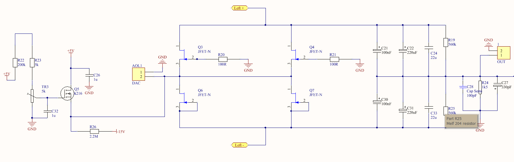

Jjazz, I had a look for the schematics and couldn't find it. Ill attach something similar to what im currently using. The only difference is its configured as SEN not CEN.

I bought the pcb and I welded the pieces (have to review any)
I believe that in order to know if everything works properly and does not spoil the dac chip tda1541A is necessary to weld some resistance and measure the voltage. I refer to this. What resistance and tensions which is necessary to measure?, if I am not mistaken is the way to check if everything is soldered correctly. I don't have much experience in this, I am rather an assembler.
I prefer to use the already welded pcb, so I'm on the interest list, but as there is no date I will run the risk of test which I have welded.
Thanks a lot
Hi Jjazz,
Yes it is recommended to check the voltages before you put in the 1541 chip. Use dummy loads to test the regs.
Use:
180R for +5 and - 5
510R for -15
If you dont have exact values dont worry, approximate values will be ok.
I'll update you on the populated PCB very soon.
Ryan
