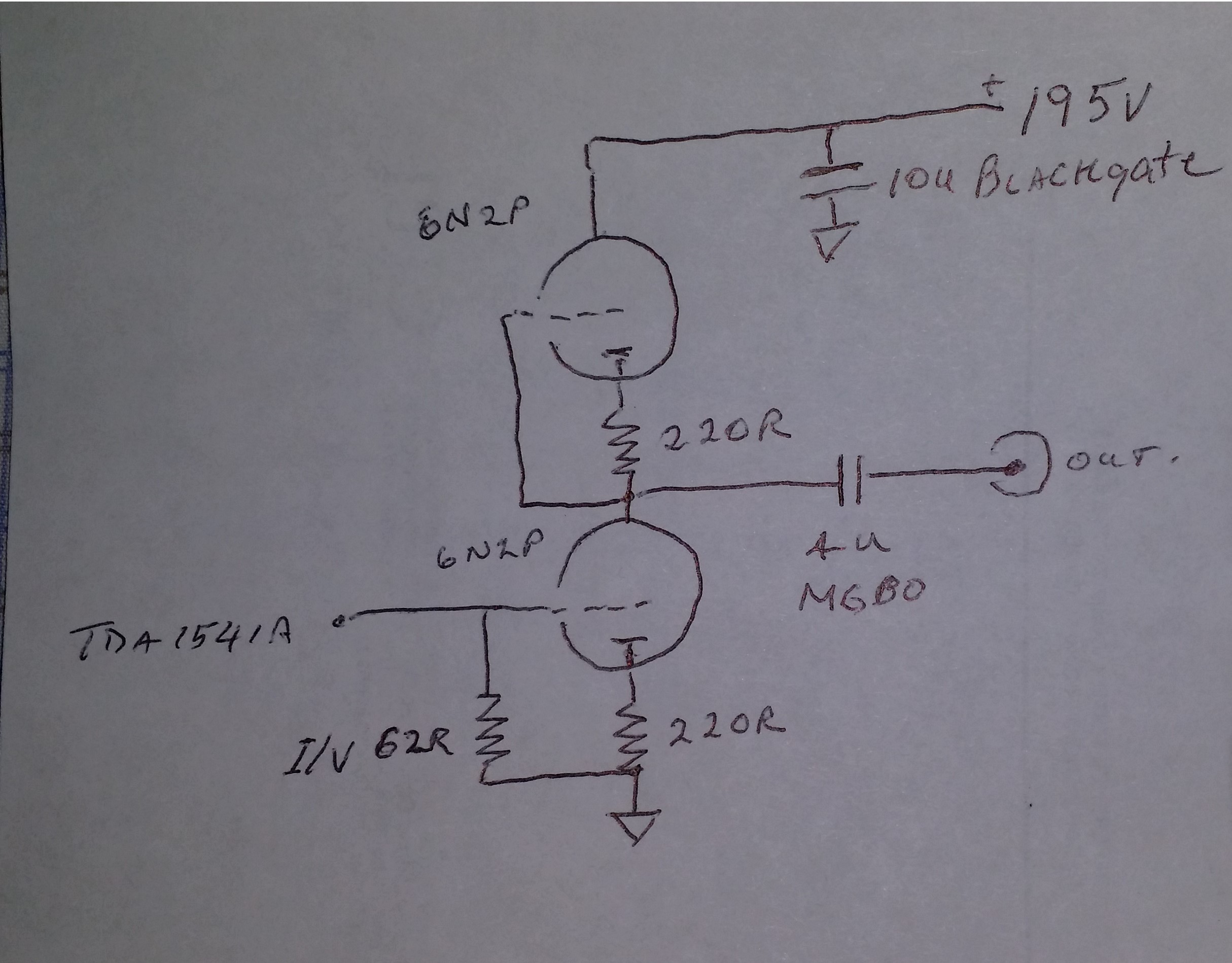

You will enjoy these resistor experiments. FYI, I wrote a short blog concerning my fun in this regard.
2013 Holiday Projects - Ridding the system of resistor problems - diyAudio
Later I also changed the cathode resistors to Manganin and realized equal benefits. Values of all are in the attached schematic.

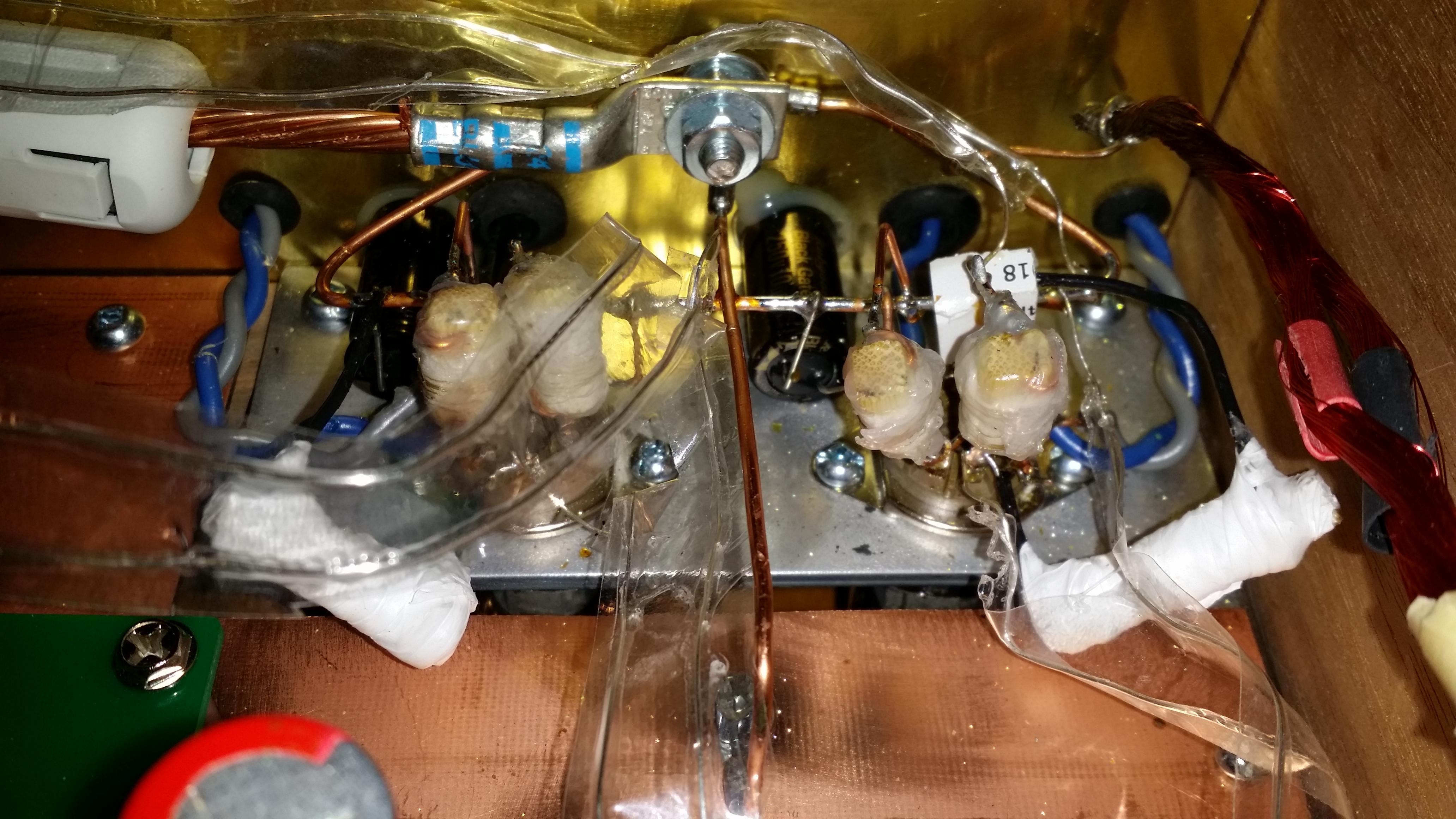

For fun I attach a pic of the circuit wired pt to pt. The white blobs are the hand made resistors. Not pretty, but sound is sublime.
I came to the conclusion that all resistors near the signal path are evil and should be eliminated where possible and replaced with least damaging element which to my experience is manganin. I believe this is what Rhopoint uses as their resistive element.
