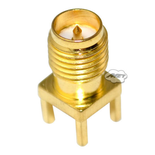

Hi ryan. I'm interested in getting one but might I suggest something for v3 if you ever do one. I'm talking purely for the analog outputs here, I'm happy with the connectors on the pcb for the digital inputs. I've used RP-SMA female sockets so that I can get a really good low impedance connection but also keep impedance at 75 ohm and use RG6 coax coming directly from the PCB into my amp. To preserve shielding and to keep correct impedance. I'm strange but I like to keep impedance correct even for audio signals. I figure that any digital noise which makes it into the analog side can then find a path to ground much easier. Make sense? :wiz:
You could just put the holes required for the RP-SMA socket on the board and still have plenty of room? maybe... Wont even need to populate it with a socket, I'll gladly do that even on the populated pcbs. I can't tell you what to do. At least that way you can cover my use case and also give others who don't use coax for audio signals plenty of room for making a good solid connection.
Also. I'm not suprised that you preferred a SMPS psu over a battery, I've before tried these dacs with batteries and it sounded awful and stale, lifeless.
I personally prefer E-core transformers. They improve things a lot. Despite being 'technically' inferior.

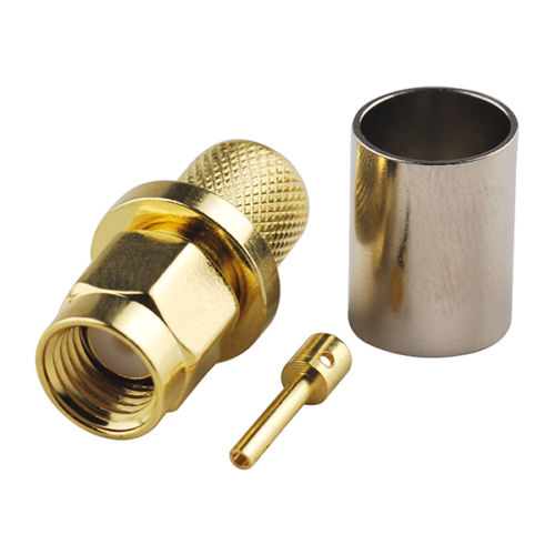

This is the RP-SMA sockets that I use on my analogmetric dac, I use RP-SMA female to RG6 coax connectors (crimped types) throughout my builds. I'm interested in getting one of your dacs but would LOVE it if V3 had large low ohm RP-SMA connectors on the analog outputs instead of those little solder tabs that are close together. I can then use small coax to run to an external AD797 opamp. See attached 1st pic:
Also. I've attached a photo of the RP-SMA connectors for 75 ohm RG6, note the 2nd attached pic, the center pin is female, not male. It has a little hole in the center. I've found these connectors to be much easier to find than the other style (SMA) which I saw that you used in V1.
