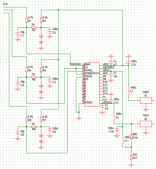

please tell me whats wrong so i could correct it
Not a mistake, but R2, R6, R9, R3, R4, R7 have not the values suggested by Henk ten Pierick.
Decoupling between VDD and VDD1 is missing (maybe between VDD1 and VDD2 too).
What values are needed to obtain a 1.2-1.6 V swing, as suggested by Htp?
And how to "copy" the currents out of pin 6, 25 to the VDD pin 28 ?
Paul

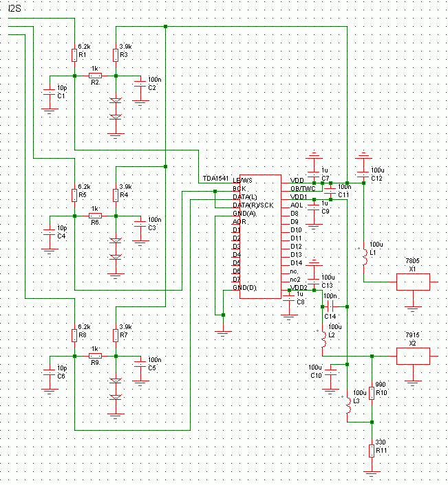

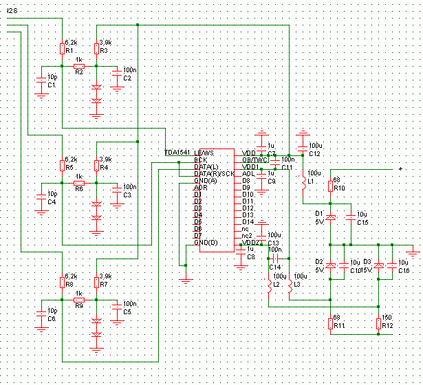

What about:
The way VDD1 is made from VDD2
I suppose that, due to different loads (VDD1 and VDD2), the way you showed with only one 7915 for both -5V and -15V, does not give good regulation.
My suggestion was to use a single pre-regulated -20V rail feeding two separate local shunt regulators, as seen in Thorsten's Adagio, TNT Convertus ecc. Since HtP stated that the current reference generator is supplied between the -5V and the -15V pins, I guess that a single supply rail gives a better ripple performance. Opinions?
Paul
