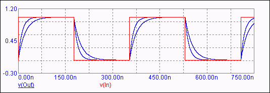

Delay is not important as long as the delay is equal for all inputs.
I guess it is no problem to have the same delay for all the lines but you will not have the same delay for all the frequencies. Honestly, I do not have an idea if this could be bad or not, just want to note that the general 10ns becomes some 9.7ns on 2.8MHz and 8.6ns on 6.4MHz.
Delay has no influence on the definition of the transition as long as the noise of the delay element or the noise of the inputstage does not significantly cause jitter.
I was not referring to the noise/resistor induced jitter, I was referring to the smoothed waveform like generally less wanted waveform here because of the problem of indeterminacy of the moment of transition in time. Attached are the bandwidth unlimited ~2.82MHz square and squares limited wit RCs of 12ns and 22ns. Are there good reasons why they usually use just square signals here or not? Or the rise time is all we need to determine the best bandwidth of these squares?
Current reference generator for the output current is between -5V and -15V. Output current from the dac comes out of pin 6, 25 via diode switches or comes out via the +5V pin 28 by darlingtons. This means that complementory output signals L+R flow in supply pin 28.
I do not quite figure this. Three or 4 active divider pins are inside -15V- -5V range but the others are not.
Interesting note about pin 28.
