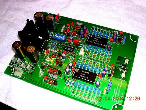

this is my new design which use parallel (two) tda1541a NOS.
DAC with CS8414 contain I2S (SYN-SCK-SDATA) & CS8412/8414 can run use dip.switch setting for syn mode or aysyn mode.
thanks

Tda1541a info
hi Bernhard,
very thanks for your comment.
this circuit was one of Germany friend send to me & I reference several more then Layout the PCB.

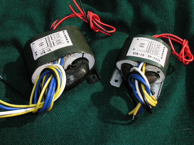

This several days I was testing this PCB & testing the Power transformers.
I collect this which prepare for this PCB & the output stage which use 6X4/diode with 6C45,EC88,EC86,EC8010 or 6DJ8 SRPP circuit. Also, I had another test need to test is, if the user use 6C45 or EC8010. Then use the pre-amp output 10K:600ohm to output.
I don't know the performance but i will test in detail.
pls see the power transformers.
thanks
