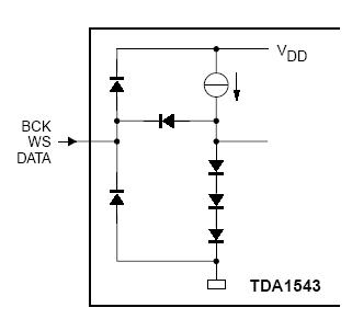

The TDA1541(A) has the digital input circuits refered to a slicing level. This level is 2vj, thus two forward biased junctions above digital ground. All internal logic current routing logic and is refered to dgnd, and is supplied between -5V and +5V. Apart from some spikes, the logic supply currents are dc currents.

Bricolo said:Mr ten Pierick,
While reading the TDA1543's datasheet, I found this schematic representing how the inputs are made.
Unfortunately, there's no such schematic in the TDA1541A's datasheet.
It it similar (maybe with 2 diodes instead of 3)?
WS, BCK and DATA inputs of the TDA1541(A) are made by the base of a horizontal pnp. They have a one diode, the base to substrate junction, to -15V.
regards,
I think I'll go back reading books this evening, I don't know what a horizontal bjt is, neither the substrate (I know what it is for a fet, but that's the 1st time I hear about that for a bjt)
