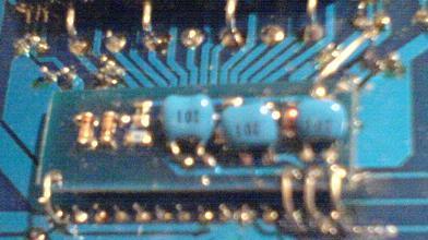

I do tell myself it sounds a little clearer and cleaner but I might aswell delude myself as that is what one would expect from this mod.
The values probably need to be handtweaked with a scope to get them optimal.
Which wont be fun since I used Smd:s

Nice work hifi! Especially in smd it's possible to get such good results.

I settled on 3K1 in series with the datalines and I do belive the sound improved by it. So sure its worthwhile but not earthshattering.
But I also implemented the DEM-reclocker att about the same time and had a little difficulty with using 4FS, the lower bits would on occasion distort. But with 8FS everything works well and I can pass lowlevel sinewaves without trouble.
So, Im not quite sure what to attribute to what. In any case you can always implement both of these circuits on separate boards without making a total mess, after the dac is completed that is.
To set things in perspective, using a separate PLL in the dac and making it controll the oscillator in the CD & Using Jocko:s Spdif interfaces on both ends. Made a much larger difference to me then the Dem/Level adjustment did.
