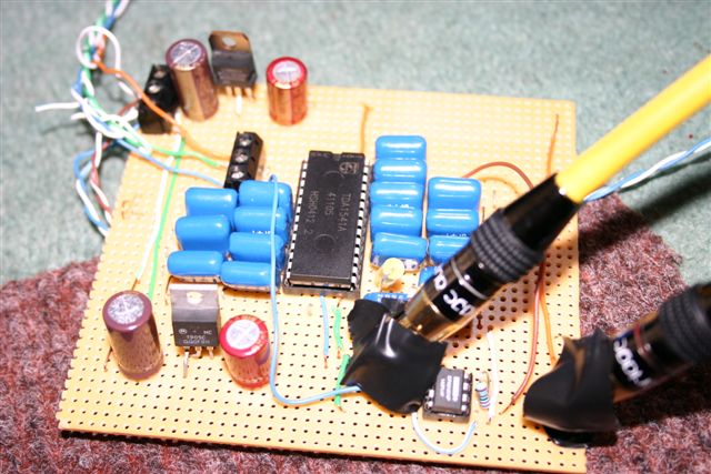

How can you tell the date?
Mine are Taiwanese, and might be quite late too.
TDA1541A
41105
HSH0412 2
Sounds alright to me though. They work (which helps ;-)
Phil
TDA1541A
41105
HSH0412 2
Phil
Can you post a photo?
According to the usual coding they should be from week 12 of 2004.
Cheers
Andrea
Cheers
Andrea
Here's the picture, its in my first ever DAC, so no comments about the build quality!...
I have four of them, they seem to work well to me (although I have never had the opportunity to use the older ones, so I have a limited frame of reference).
It shouldn't, in theory, make too much difference where they are made. It might be though that the process has progressed and the die size is smaller (makes the chip cheaper) - but I would imagine that is very unliekly as it would cost a fortune to respin the chip for such a low volume.
Maybe they made a one off batch of a few thousand, just for small customers? Very nice for a major semi vendor.

if it works without Cosc (pin 16-17) it is likely to be a remarked 1541, if it doesn't it's a real 1541A. Easy check.
cheers
Andrea
cheers

I'm gutted!
Last night, I snipped the leg of the 470pF capacitor, and it still worked!
So I guess these are 1541's then. I bought mine from a (I thought) reputable seller.
So, where can I get a proper one then? I guess I may well be looking for old CD player just for the DAC.
At least it can sound even better!!

I tried running the TDA1541A without the cap and... it still works!
After a momentary puzzling I also noticed that with the cap disconnected there is a sort of background noise , kind of "fizzzzzz".
Thinking better about it the DEM is used to calibrate the current sources, so probably the chip works even without it but the uncalibrated current sources give degraded performance.
Try with just one leg of the cap soldered, if you experience the same result then you have a real "A" chip
Hope we found the solution!
