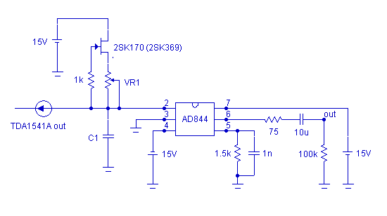

I'm trying to realize this DAC.
What is the correct setting of the trimmer VR1 connected to the SOURCE pin of 2SK170 fet in I/V conversion module.
Can anyone help me? Regards.
Davide.

Hi philpoole,
Yes, I have the schematic, but I fear to damage the TDA1541A setting incorrectly the trimmer VR1 connected to the SOURCE pin of 2SK170 FET in the I/V conversion stage.
Please, can you help me? Could you explain to me the regulation procedure? Regards.
Davide.

Oh that schem, i allready thought of it when you mentioned the sk170 fet. The schematic is from Pedja Rogic, have build and tried. Without fet part i hooked it on a PCM56, this dac doesn't need an offset.
My advise is to build it, turn put pot in middle, run dac and measure offset on dac-output. If you use a socket for the dac push a cheapo 1541A in it, and no S1 or S2 or other expensive selected dacs to reduce money waste when a first setting was not at best. Then set pot for minimal offset, and reset it after 30 min warmup.
Maybe Pedja himself can give some other/better tips.
Just shows how useful a schematic is - I was suspecting it was a discrete common gate/base amplifier.

If you think of jocko's stage, try pedja's first, and if you like it stay with it. Jocko's (but then a derivate of it from r.broertjes) have i tried too, liked it first but after a while discovered a sort of distorsion on the sound i didn't like.
The AD844 stage is way better then a regular opamp 5532 output, but when you pick a good opamp (i tried a THS bla bla opamp) the simple cdp opamps stage can be rather good. My all day cdp is a modded cd304mk2 with original opamp stage,(THS)
The 844 stage is fast, and emphasises rithmic music, but hooked it on a pcm56 nonos. Jocko's stage emphasises the more continous tones, maybe better for classic? (but hooked it on a 1541 nonos.) All matter of taste.
