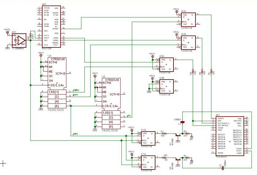

I am implementing the provided DEM/BCK/DATA reclock scheme with 74VHC163s and 74VHC74s, parts I have at home, plus a 1ppm clock. The reclocking target is for the OS TDA1541A in my Marantz CD50SE.
Would the attached schematic work theoretically?

Guess no one wants to tell me whether the connections on the schematic are fine?
Well, I guess I will get a perf board and test out the schematic myself.

Thanks Andypairo,
I just finished hardwiring the stuff with the 8fs for DEM. Hopefully I will have time to test the board with my CD50SE tonight.
honinbou

Hi tubee,
It does work, but I think I need a separate power transformer for the clock and the 74's. I am power everything with the original transformer inside the CD50, and I am worried about killing it! There is definitely a noticable improvement in the soundstage, but I don't know by how much.
May be I am fooling myself?

Hi tubee,
Schematic remains the same, but DEMs are clocked at 8Fs. I used 74HC163s and 74VHC74s. -6V, 5V (except the TCXO) were taken directly from the mainboard.

Tubee,
I forgot to mention that I also removed the WS, BCK, and DATA reclock portion of the circuit. I couldn't get that part of the circuit to work. However, I guarantee 100% that DEM reclocking with 74VHC74N and 74HC163N works!

Ok thanks Honinbou for info.
The /163 isell known, use a 74HC163 in free running mode, as clock divider after a separate clock (Tent &/or kwak)

Resurrecting the thread...
....to ask some clarifications
In the various DEM schematics posted I noticed, apart from the use of different dividers, that pins 16 and 17 aren't treated in the same way:
-In Henk's original schematic the emitters of the BJTs get two out of phase signals
-In the schematic with synchronous counters (honinbou) the BJTs get two in phase signals
-In the DEM syncing proposed by ecdesigns pin 16 is coupled via a cap directly to the output of the flip/flop and pin 17 is left unconnected
Which schematic should I use?
