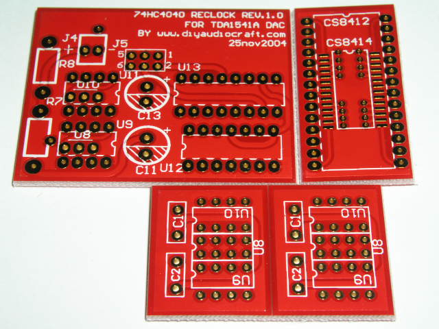

Here's a "beta" pcb I did.
:att'n: There's no power supply, and no PS decoupling for the momment.
It's designed to be used with a Kwak-Clock (clock and inverted clock outputs), and uses a 74HC74
Your comments are welcome 😉

DragonMaster said:
Hi, it's the first time I read this topic.
What are 256fs and dem_pin?
Can I use it with normal I2S signals or I need a 4th signal from the CDP if I use it?
As I understand it.......
256fs = 256 X 44100 (cd format) = 11289600 Hz
This works out at 11.2896 MHZ so the 256fs is the system clock.
I think this 256fs is divided by IC 4024 (74hct4024) but i'm not sure exactly which divider to use (depends on NON-OS vs OS)
The latch then reclocks the new clock using the original system clock.
Note that WS is also reclocked in the design.
http://www.diyaudio.com/forums/showthread.php?postid=364560#post364560
dem_pin = pin 16, and 17 on the tda1541a (where orignally a cap was)
Kind regards,
Ashley.
