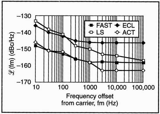

for higher frequencies try to use a 74AHCTxxx type of logic circuits, they are faster as the 74HCT type.
Hmm, they look nice.
Only 3,4nS propagation delay.
Only SMD though, and maybe only needed if we want to go 384 kHz sampling rate. I will se if I can test my through-hole prototype at 96 and 192 kHz.
However it will take me some time to get to that.

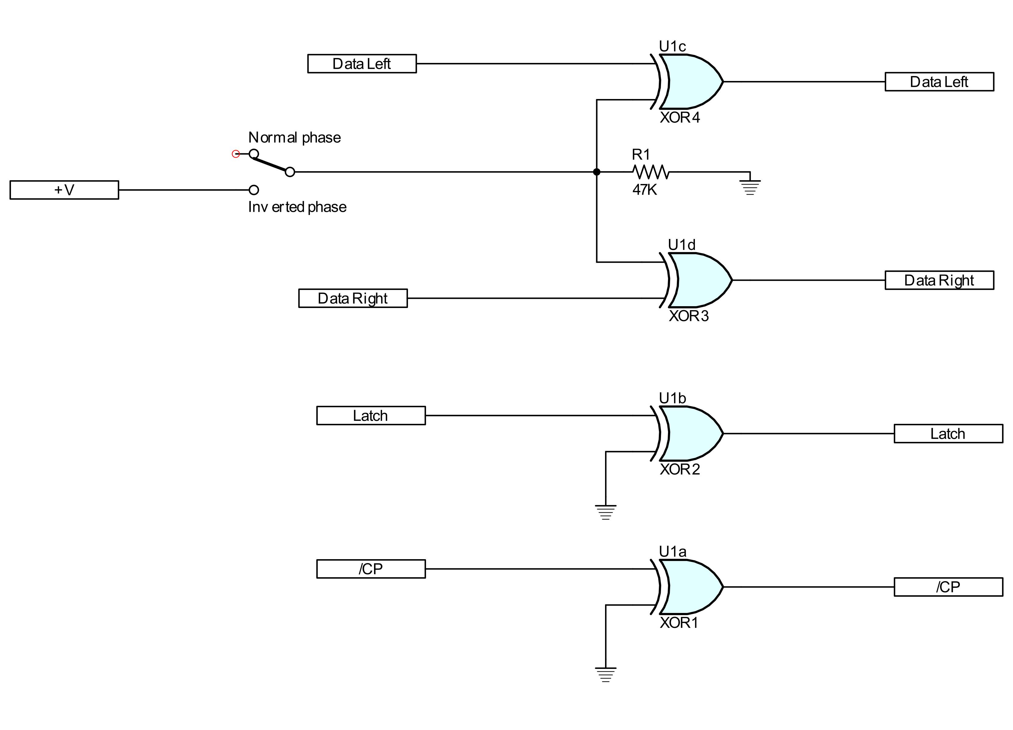

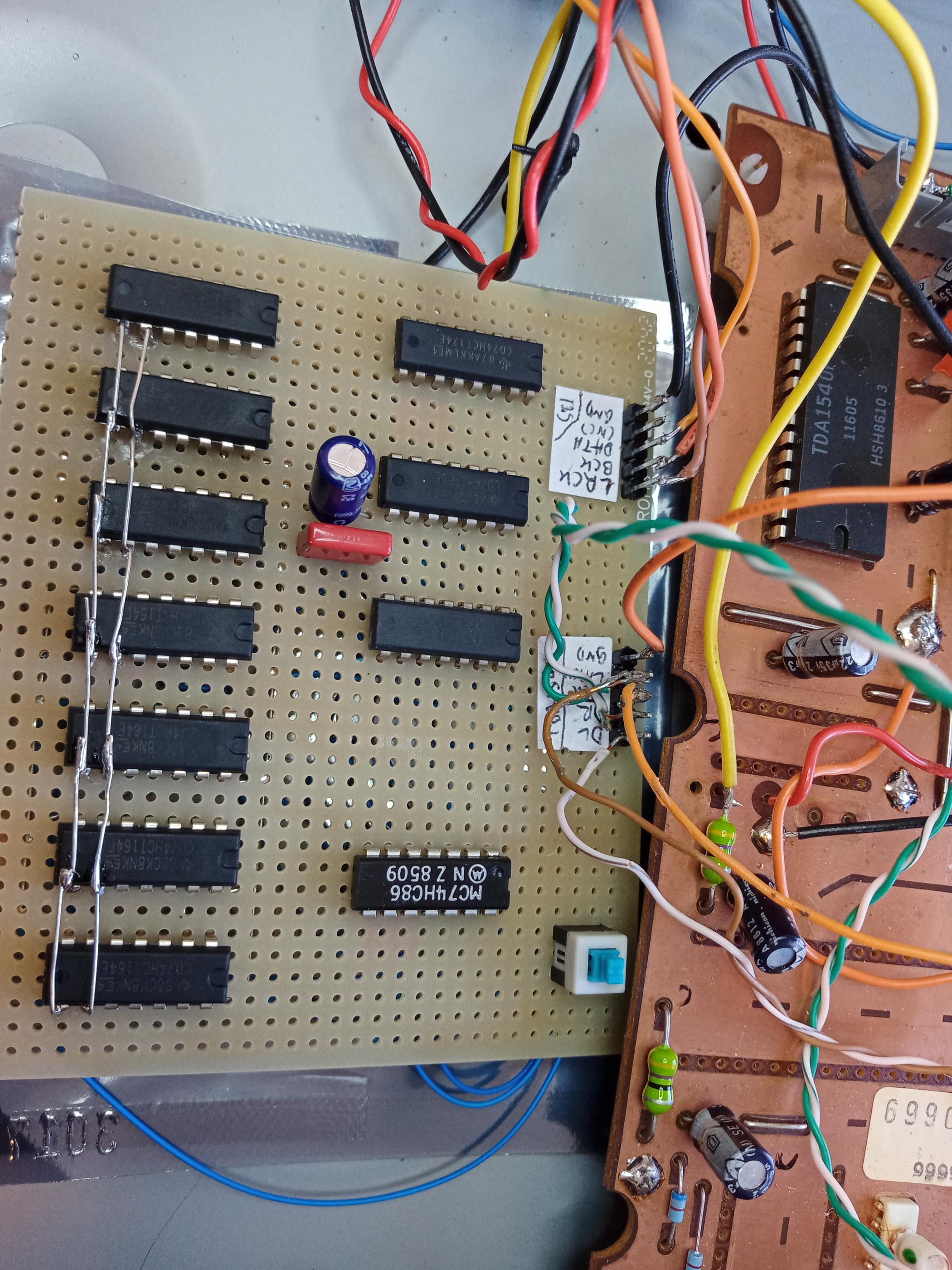

New function added:
"Time Compensated Absolute Phase Inverter"
Inverting the absolute phase requires only inversion of the data signals, but to avoid screwing up the now perfectly synchronized signals, it is not optimal just to add an inverter in the signal path.
But luckily X-OR gates can function as both an inverter or a buffer, depending whether if the other input is set to VCC or to GND, and thereby adding the exact same delay to all the signals, no matter if they are inverted or buffered.
So therefore a 74HC86 quad X-OR is used.
The Latch and the Clock signal is just buffered, and for both the data left and data right signals a switch to VCC and a pull down resistor to GND sets the absolute phase for the audio signal.
It is tested, and it works.

Hi Nrik
Thanks for posting upgrade. Yes I think that is the good way for invert phase. IF that is needed.
(I did data inversion few times to acheive correct phase out at some old school Iout dacs.)
The fact is that after I-V conversion with simple Riv at the output of ANY Iout dac, voltage is in opposite phase (180deg). But as the ususaly that level of voltage is low, and need to be amlified to some line level. The next amplification stage is usually single (tube or JFET stage) that also shift the phase for 180deg. So in the case of pasive Riv and sat tube SE anode follower stage, the phase is like it should be.
This information could be of use for TDA1540 because of low value of Riv.
Datas about 1540 is for 10mV offset (against 25mV offset for TDA1541A). For the same amount of Io current of 4mA p-p.
I done some SCK stopped mode. Will post sch later.

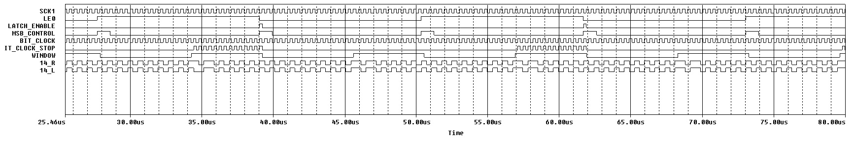

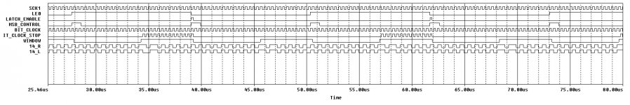

TDA1540 with stoped clock and right justified Time Simoultaneous
Circuit with stopped clock. (Module below working schematic.).
Datas are moved from left to the right justification regard to LE.
LE have just one-half of the bit clock.

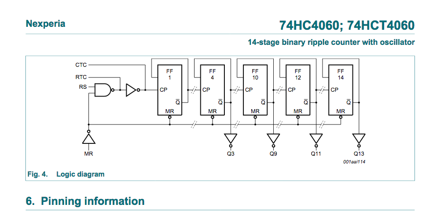

I rearange ECdesign sch (16bit version) to 14 bit for TDA1540.
It was tricky becaus I didnh have Spice model for 4060 ic. But I made it from ither logic gates.
To see what happening and to adopt from 16bits to 14bits
Hes aproach is not to "touch" LE signal. AND to keep the datas Left oriented as in I2S bus.
will post the circuit latter...

Hi
Thanks !
I emulate just for few FF and input stage from PHI logic for 4060.
I think that is maybe better to buid with separate logic parts? Because 4060 is not used like "full" ic?
Anyway 4060 has to be removed for 14bit operation, and repalced with another circuit.
I will post latter...
Thanks !
I spot that data in Miros schematic are right justified? ...
Input data are standard I2S (64-Bit word).
Output data are right justified.
Anyway, nice work with the stop-clock

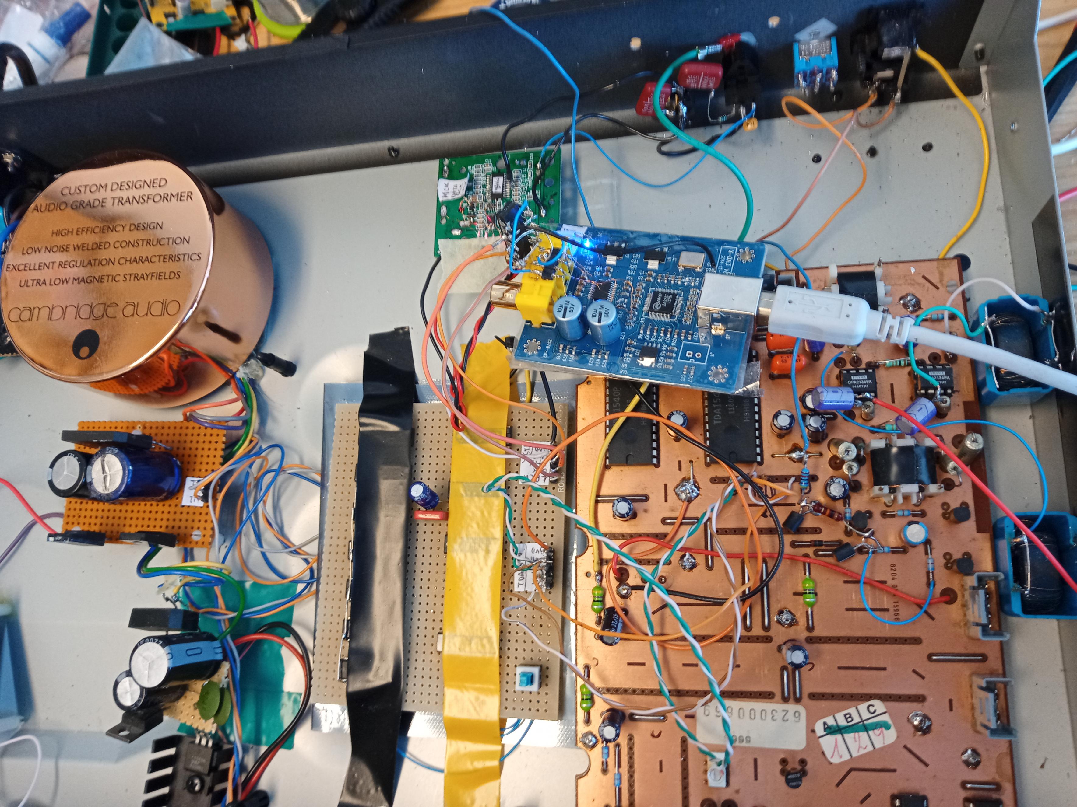

I can now confirm that Miro's circuit, including my addition of timing synchronisation plays anything up to 24bit/96khz beautiful without digital noise.
I tested it with I2S signals tapped from a SA9277 usb dac, and with an improvised 3,3V-5V level shifter circuit.
