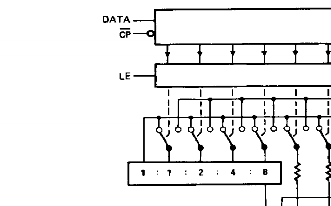

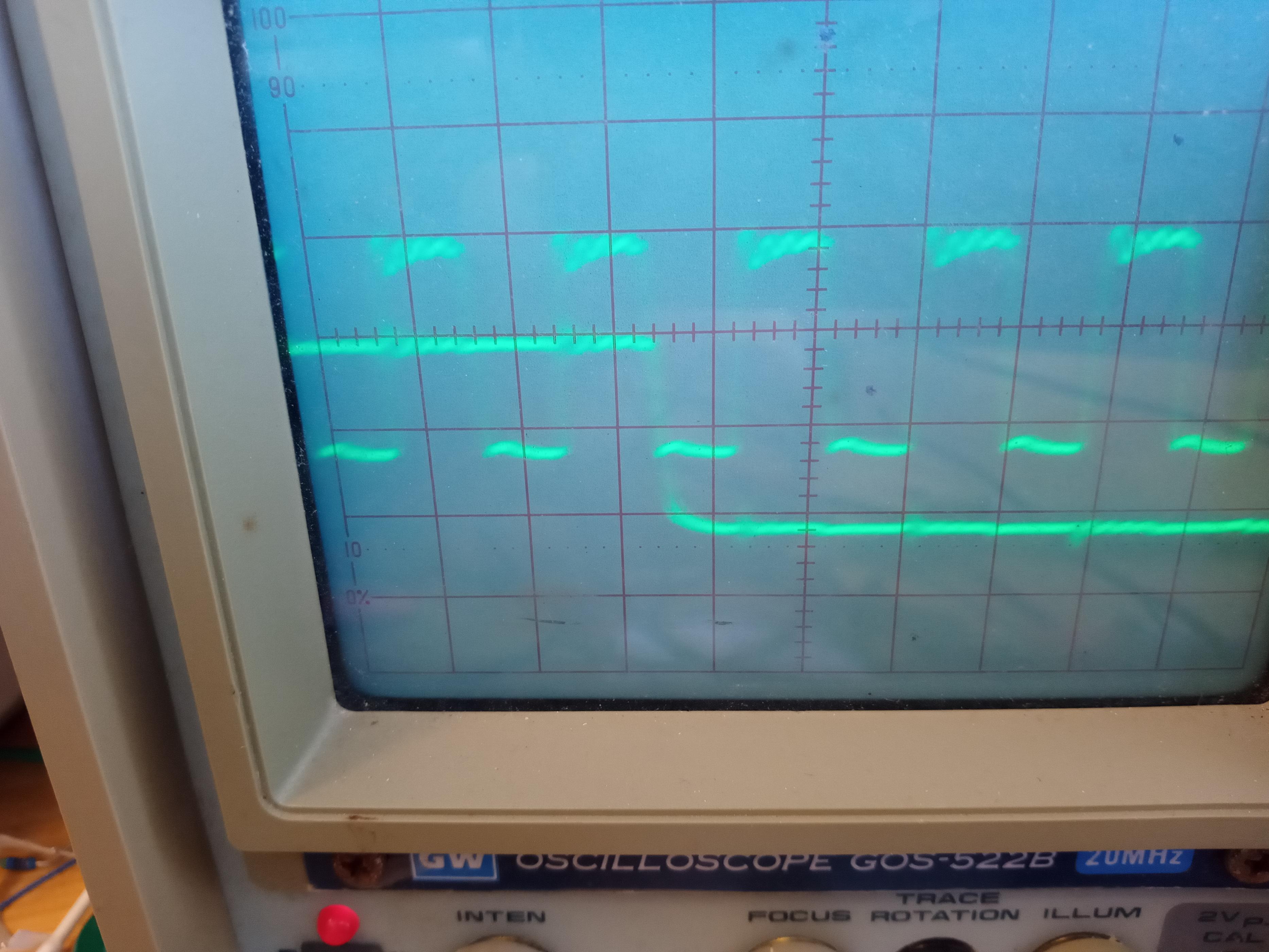

Guys, I need to know why a stopped clock is necessary?
The internal logic in TDA1540 makes sure the clock signal is ignored, and to avoid 'collisons' we could might as well just optimize the timing/synchronisation of the output signals with reference to each other.
Or am I missing something?

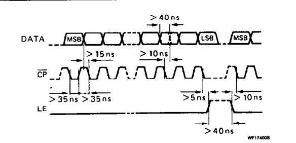

So the 74HC series has a propagation delay of 17 nS for flipflops and 9 nS for standard gates. The HCT series adds 1-2 nS do that.
In the TDA1540 datasheet you can see that the signals needs to be within 10 nS of eachother to be recognised.
So if we take Miro's circuit in post #1, the data signals are in sync with the output clock signal with the last flipflop's delay only, and the latch signal runs through two gates more than the output clock.
So if we add two inverters in series with the output clock signal, we should have synchronized all the output signals within a few nS.
What are your opinions about the that?
NB: even though I built a functioning version of Miro's circuit, I do not have the equipment to confirm the timings by measurements.
hi
i think that it is not necessery to have stopped BCK. only desireble. Because of less nise injected. And we dont need BCK run all of the time, just when needed?
delay information in the datashhets is mostly given at some higher Fo? Byt it is nt the constant and it changes with Fo. As the Fo higher delay we have more delay? So it should be measured for more accurate results?
I have digital input slot on the scope that can take up to 16 D inputs and show dierences in timing, maybe i will find the time to build and meassure circuit?

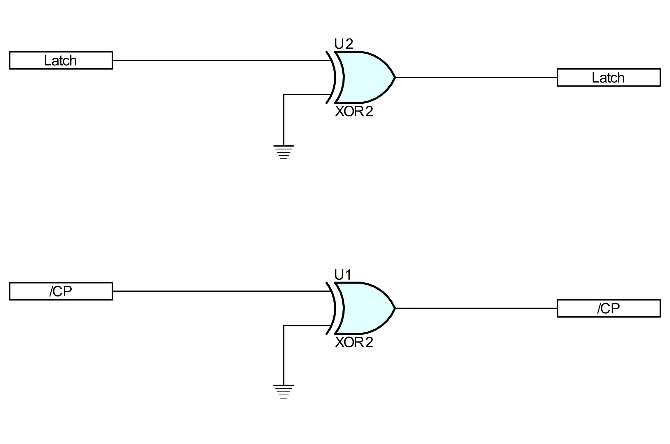

So I measured the timings and added some compensations to get perfect timing, well at least as good as I could get it with my slow scope.
The warm up was reading up on probes and ´building´my own probes trimming the compensation caps to perfect squares.
Also I quickly found out, that ALL the signals ( clock, Latch and 2 x data) benefitted greatly from adding series resistor.
Thanks once again to Zoran for stressing the point of the resistors, and better measuremnet techniques.
So my previuos assumption was, that the two data signals must be delayed as compensation, but actually it turned out, that the clock signal and the latch signal ( who were already in sync with each other) these two needed a small delay to have matching vertical lines with the data signals.
So I took use of the two unused X-OR gates in the 74HCT86, tied one of the inputs in both gates to zero, and let the last input be the /CP and the Latch signal, creating two new /CP and Latch signals with the delay of one gate.
The result is perfect in sync with the data output. ...at least as I can see on my slow scope.
check out the images in the next couple of posts.

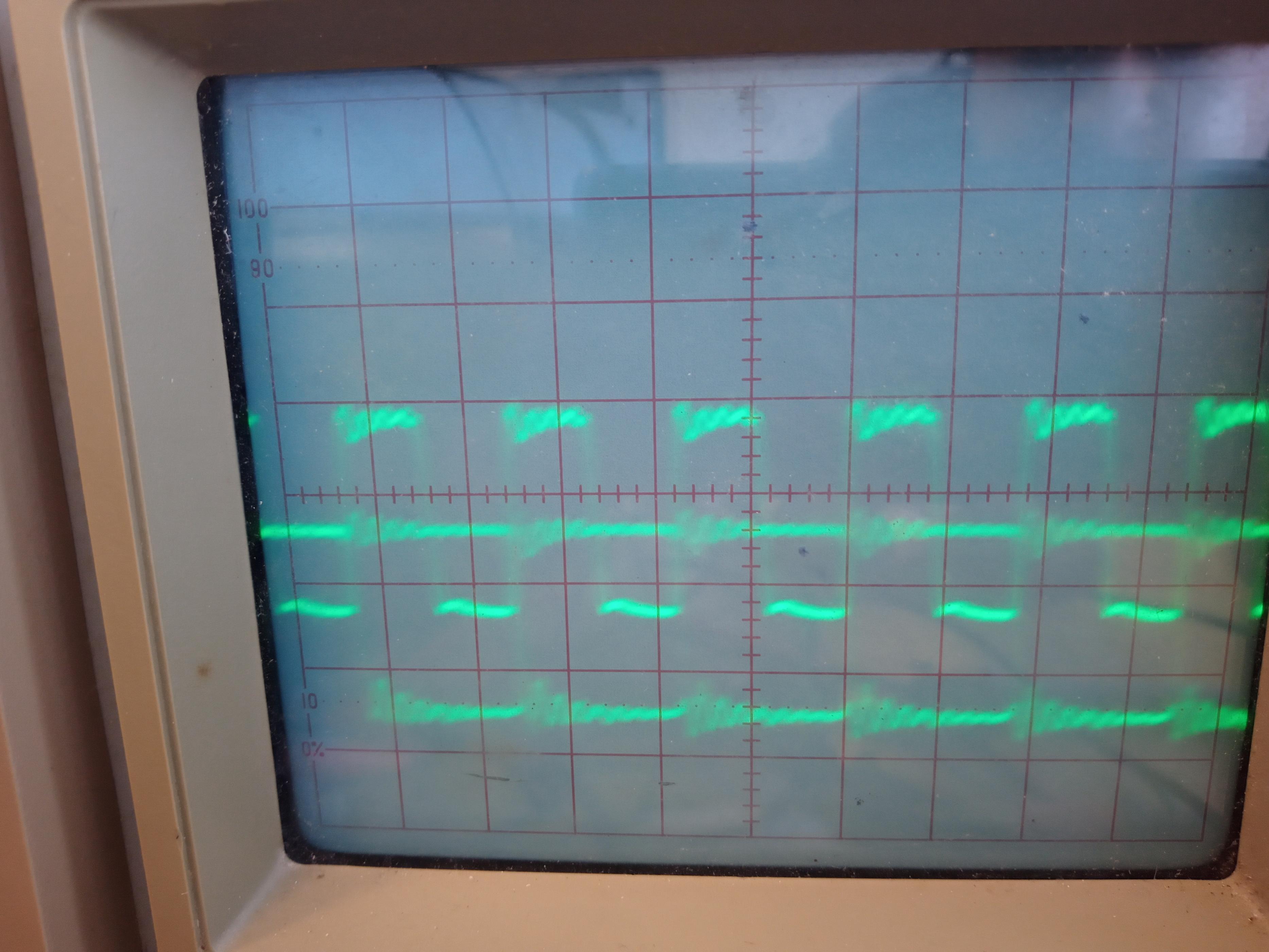

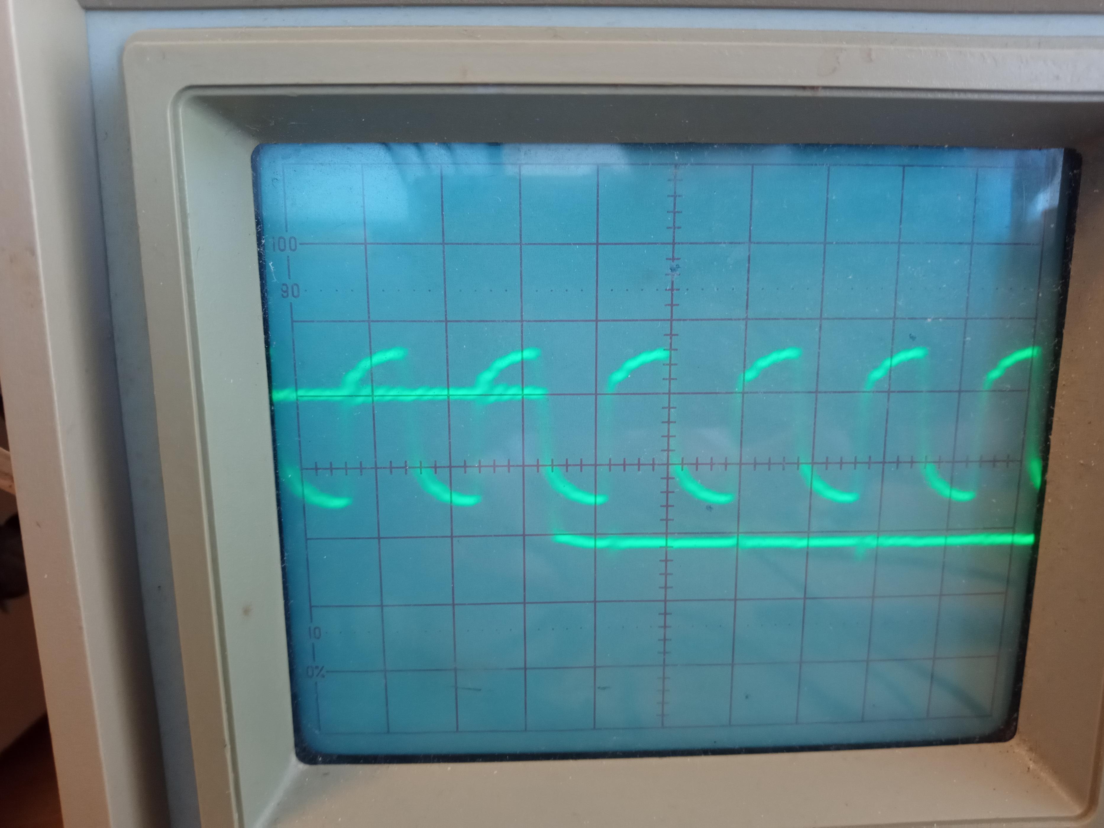

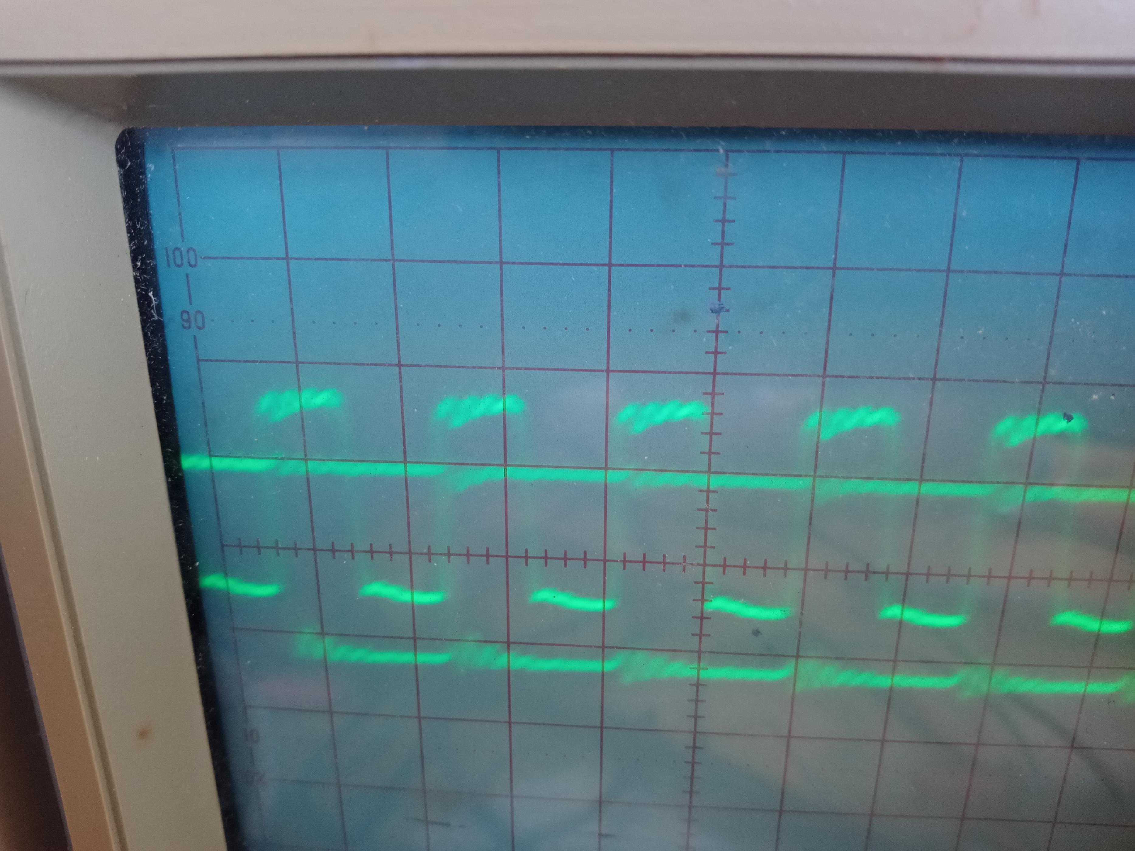

Before compensation.
Picture 1: clock and latch. As you can see already in sync
(Never mind the rounded edges of the clock - it is fixed already in ...)
Picture 2: clock and data.
If you look really close you can see the vertical lines doesn't match.
