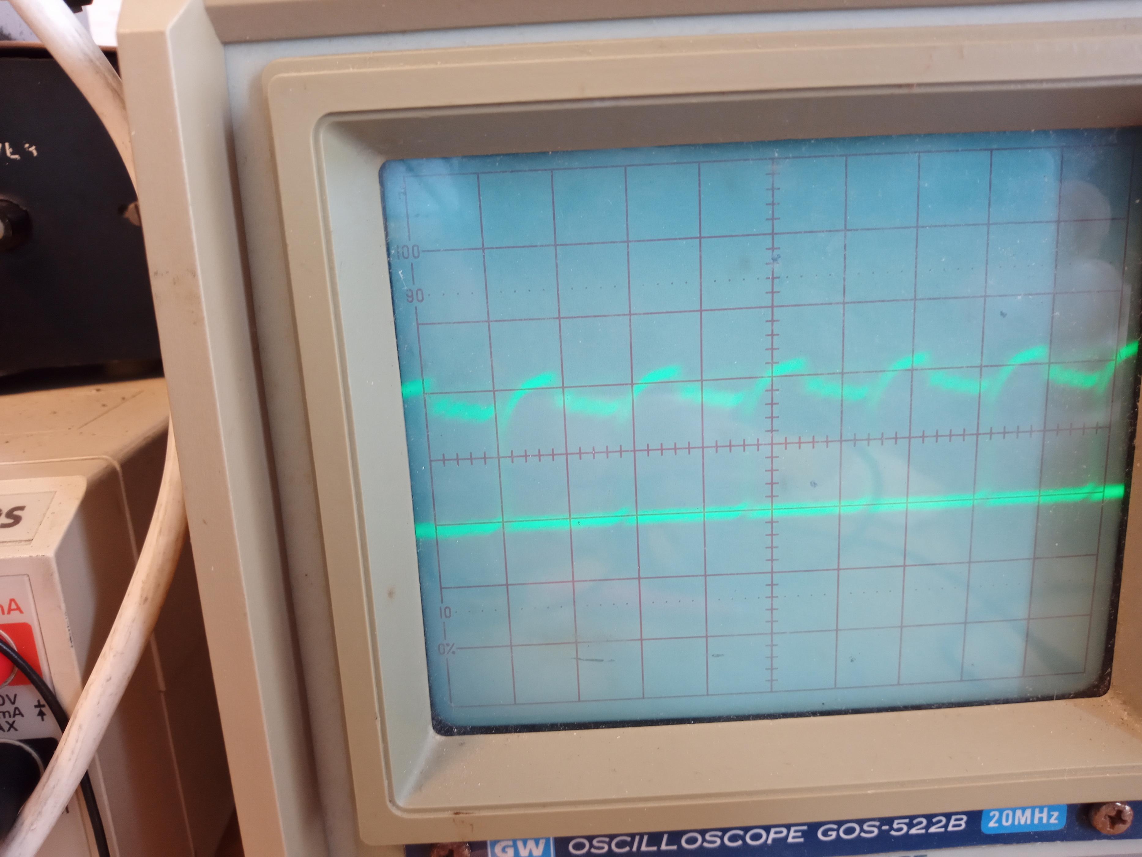

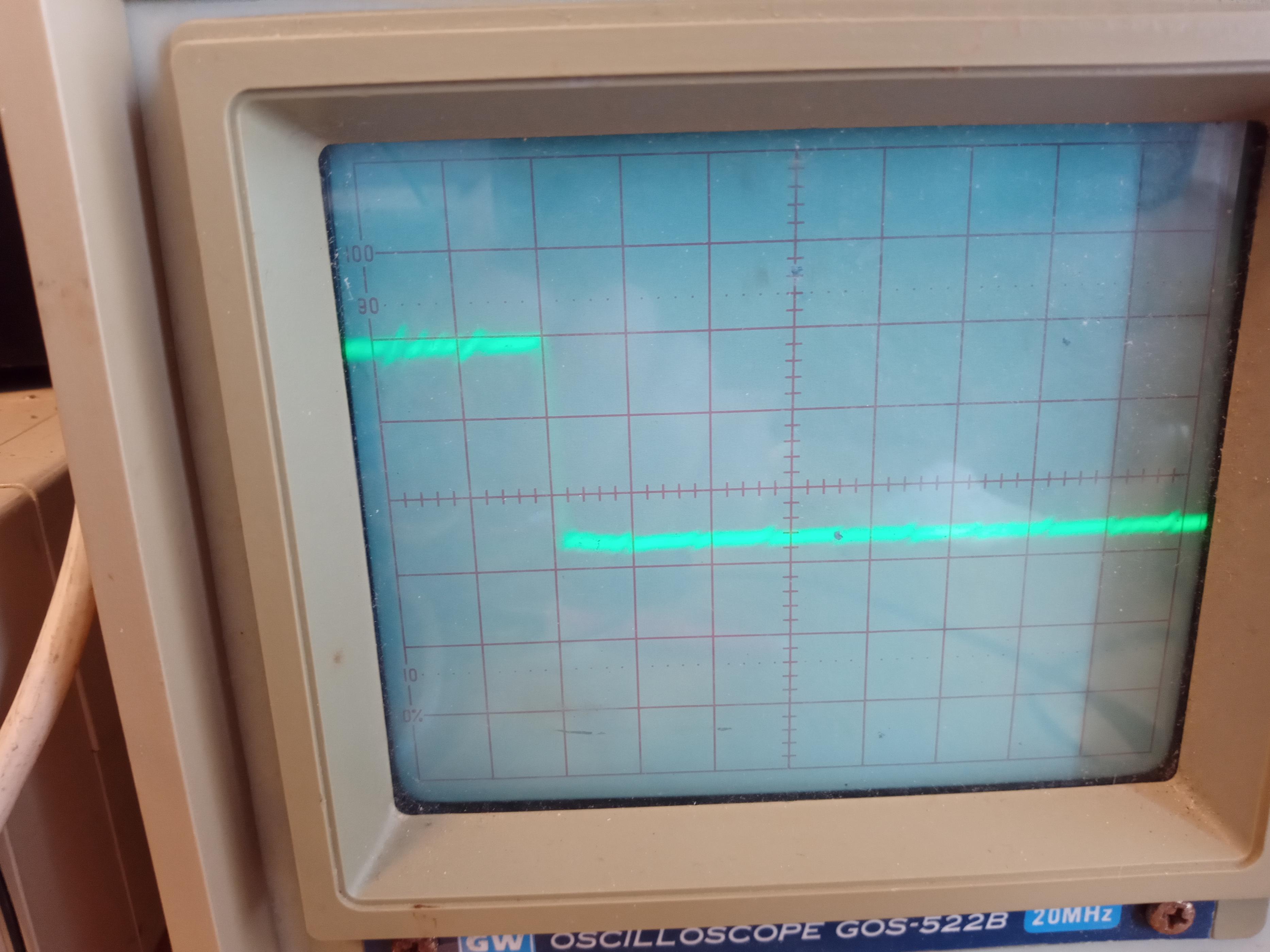

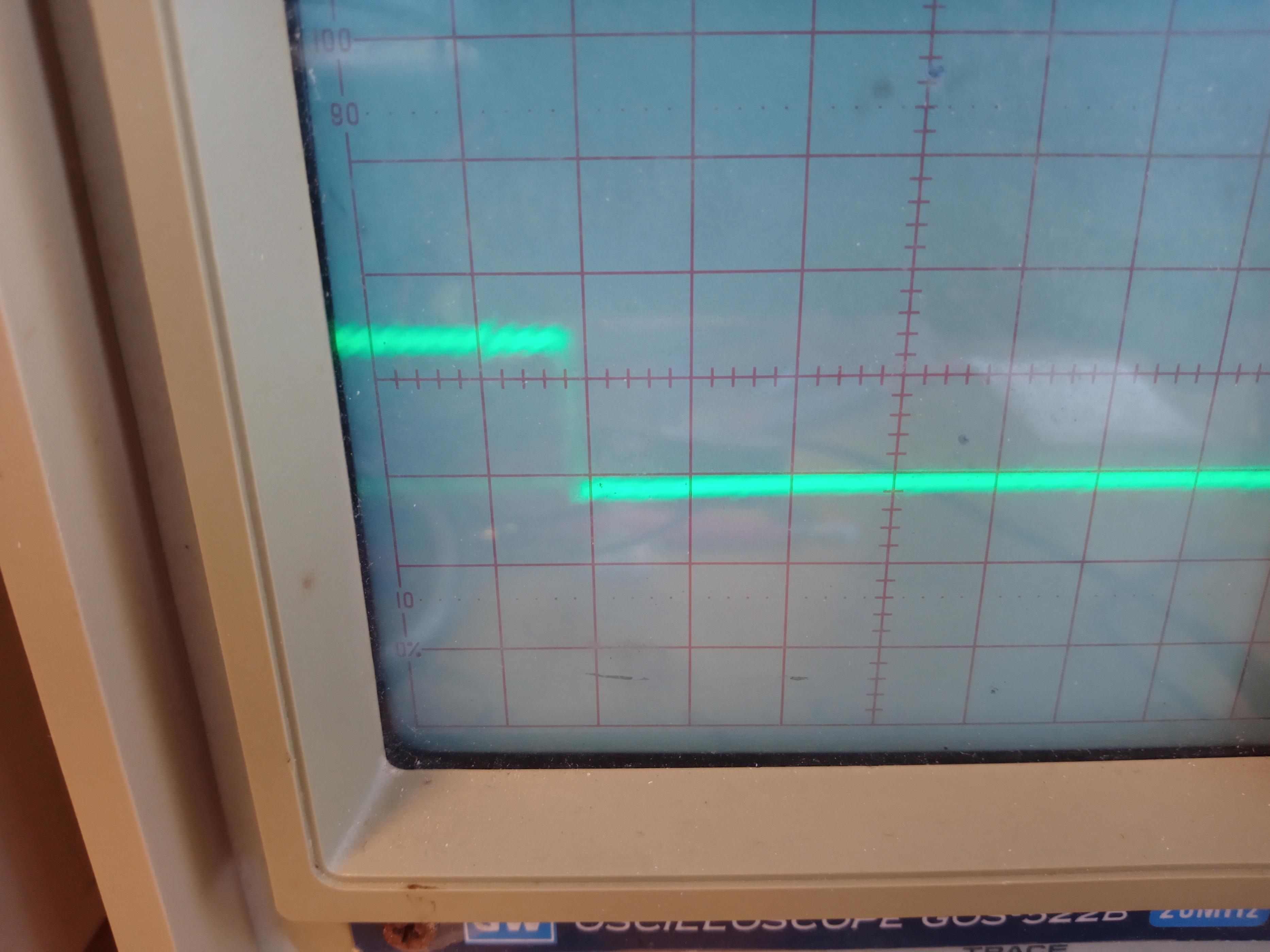

Measurements before any mods: data, latch and BCK

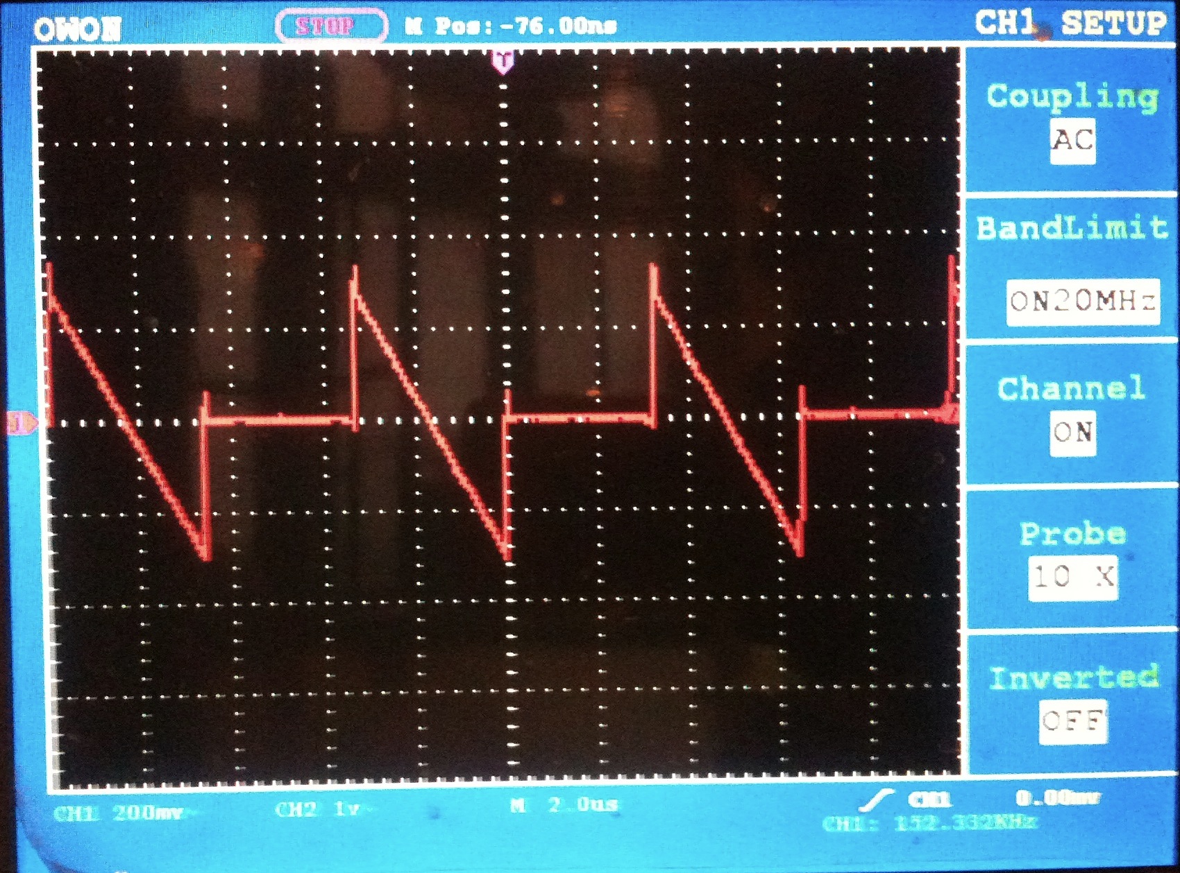

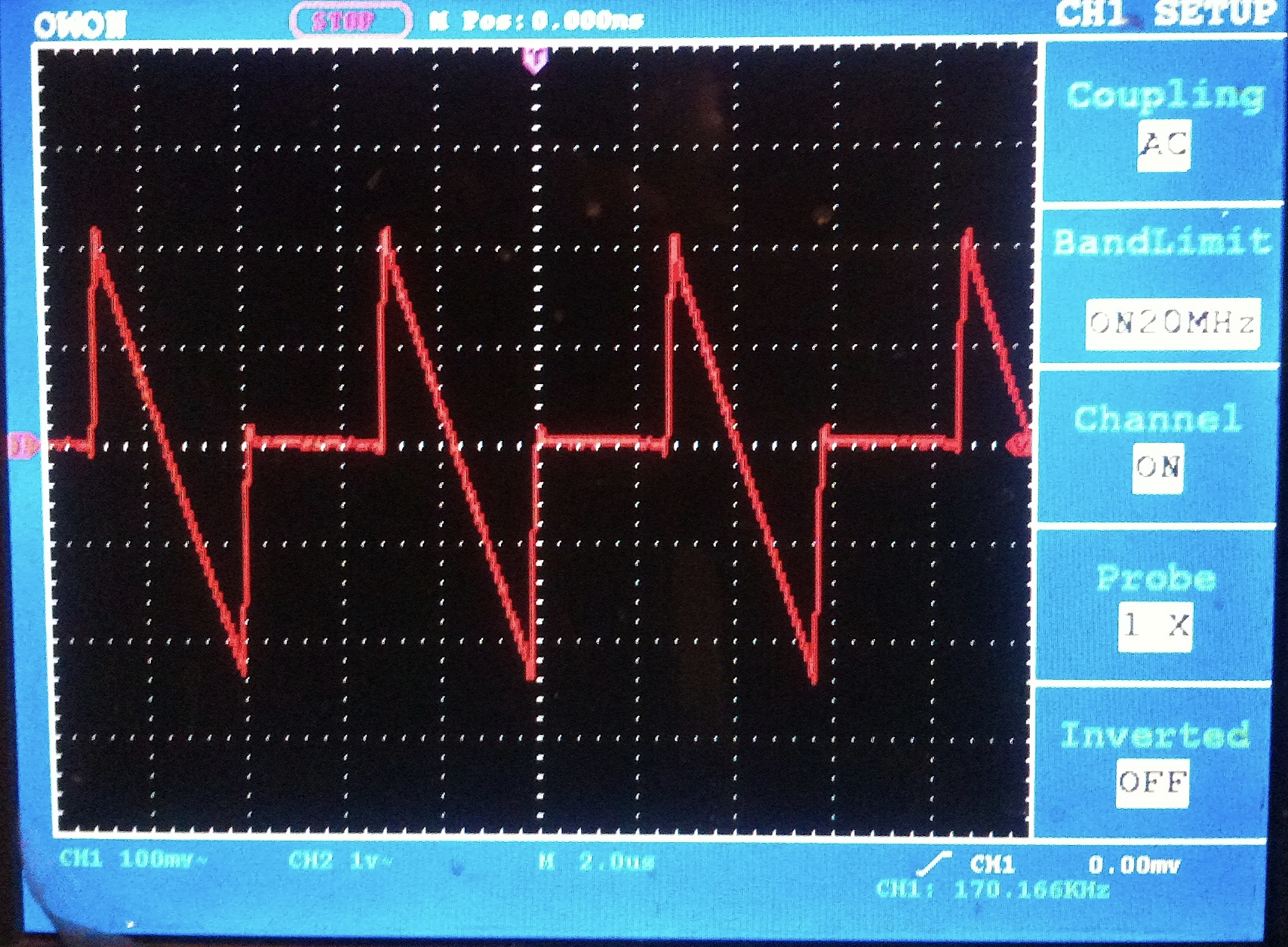

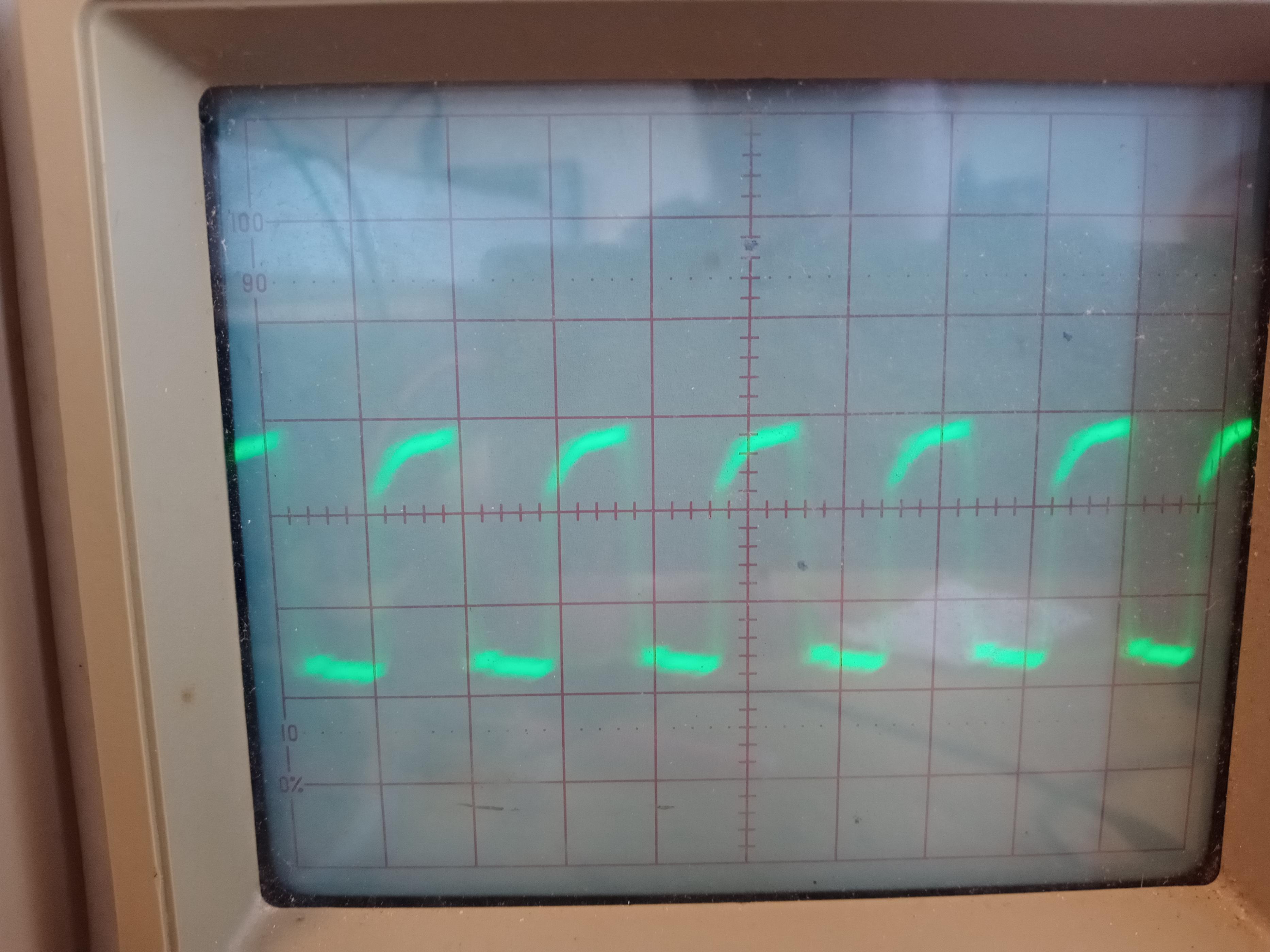

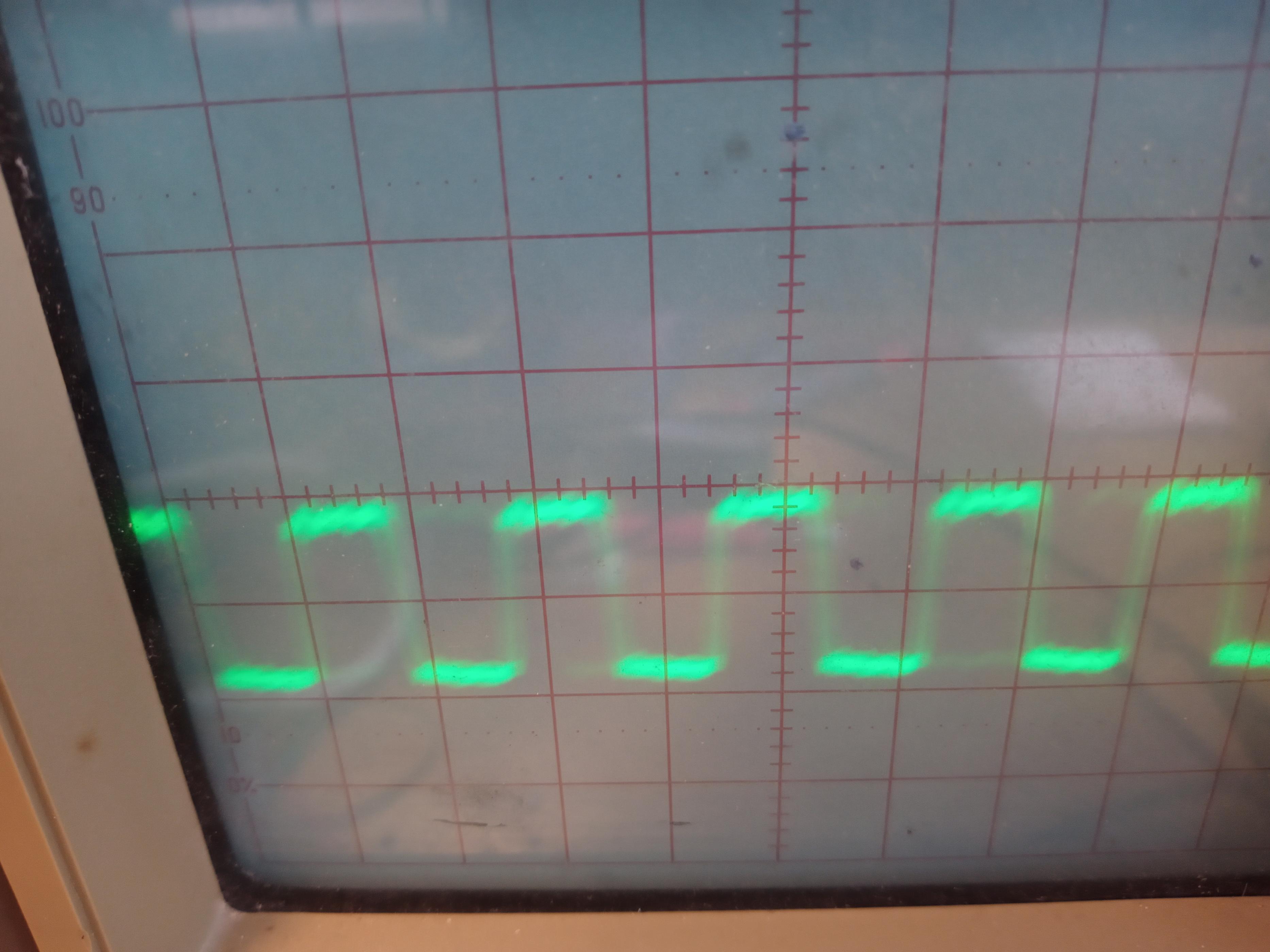

This is the at DEM pins at 820pF C measured after adding 2 x 20K from each pin (with 820pF in place) to the -18V power.
(I will try to find without 2 X 20K to -18V, but I am remember that is not good eye pattern and Fdem is smaller like 150KHz)
I found shot
Big improvement on the data and BCK signal as you can see.

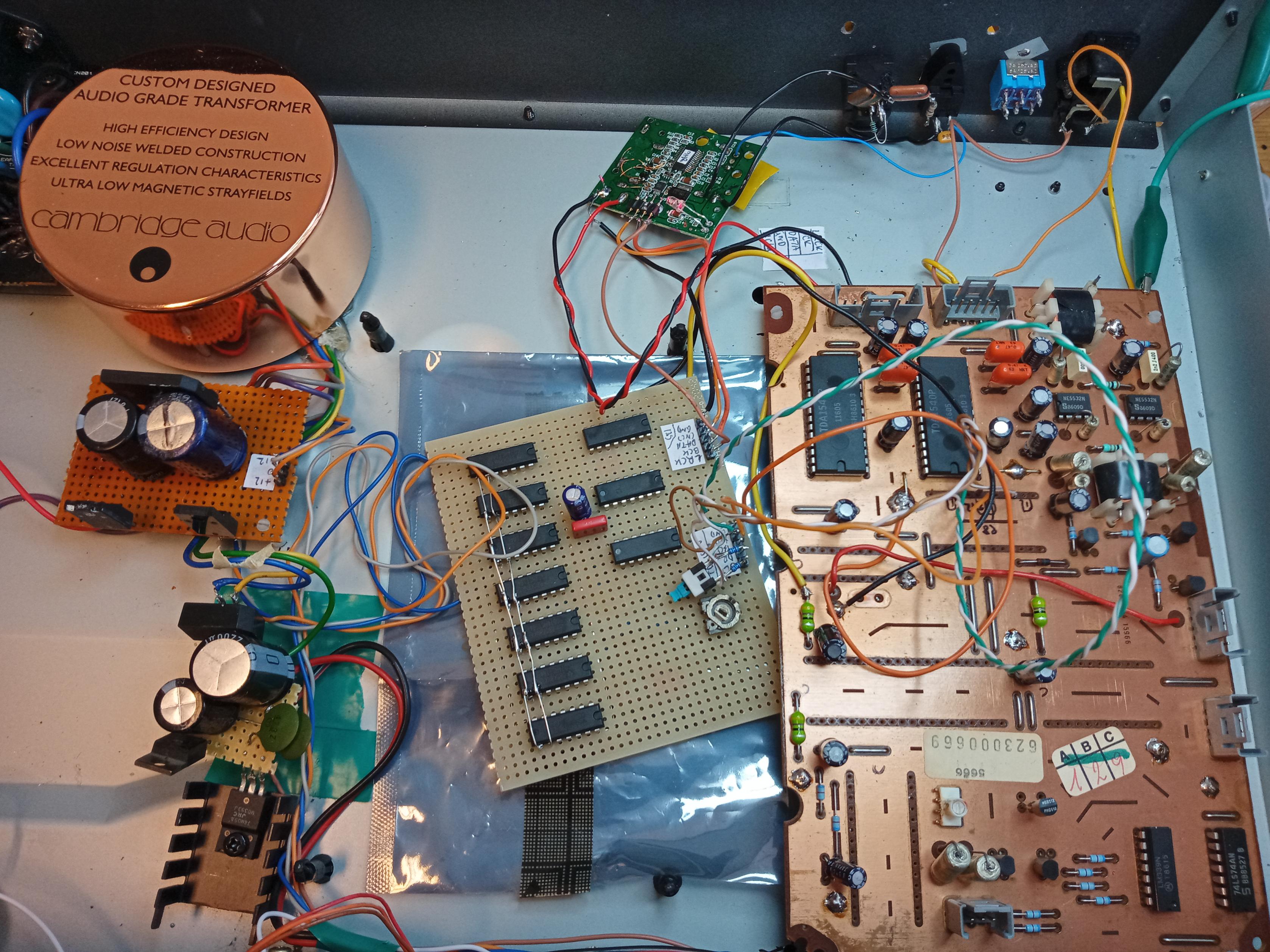

I decided that the latch and BCK signals were good, and to only experiment with series resistor for the data signal.
Your method was good Zoran : 220 ohms trimmer, and it ended up being approximately 96 ohms for optimal position with the least ripple.
My scope is only 20 MHz so the images are poor and not attached, but the amplitude of the ripple went from +/- 0,4 Volt peak to 0,2 V.
Definitely worth adding a 100 ohms resistor in both data signal leads.

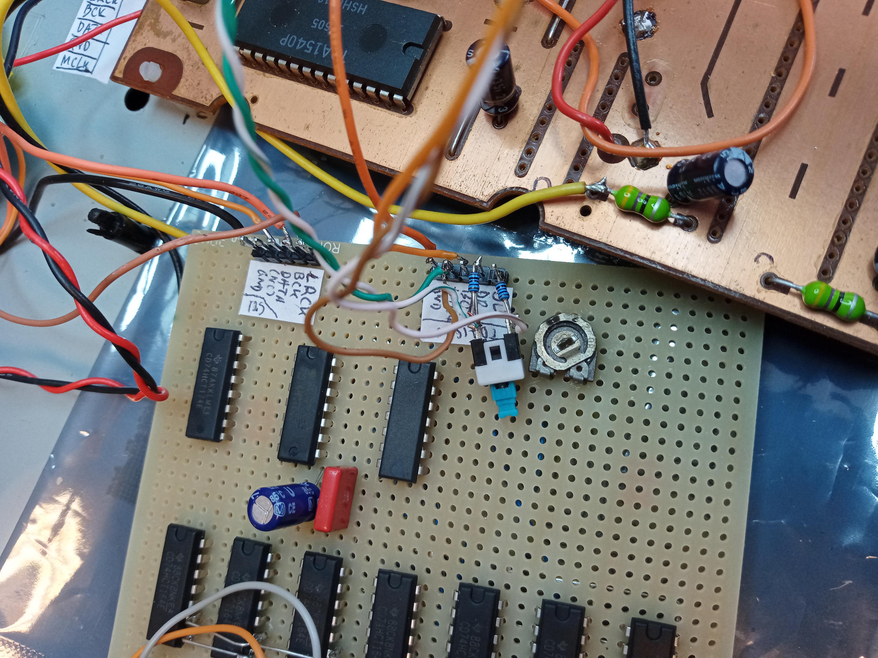

For the fun of it I mounted a switch so I could A-B test the sound with and without.
First via my monitor system (DIY amp and DIY BBC LS3/5)... No difference detectable.
Then I pulled out my diy headphone amp and my precious and analytical Sennheiser HD 600s and listened.
First som folk/rock...push, push... Was there something? No.
Then some violins ...push...push... No, sorry but no difference detectable with respect to my limitations
Of course the two 100 ohm resistors will stay for good measure, but I don't think I will go down this path any further.
But thank you for the challenge Zoran.
Yes this value for this logic fammily is almost the same that I trim to. AND this is much larger than generic values...
You right, using 20MHz scope. Probably with 1X @ probe selector. And that fren crocodile clip is probablu for ground, too distant from measuring taps? I think that maybe measurements are not showing real behaviour?
BUT more important is that You perform few listening tests 🙂

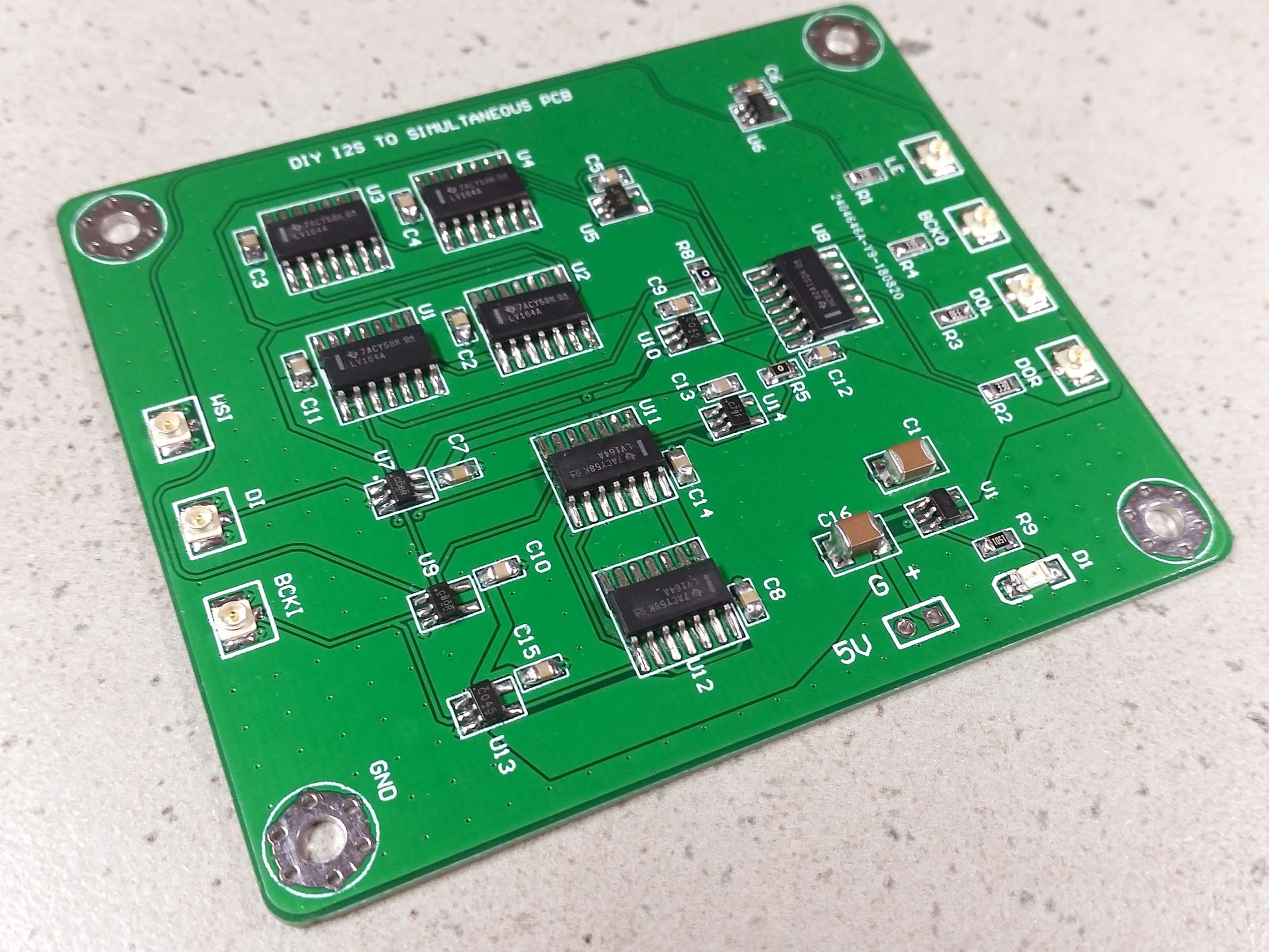

I beleive the JLSounds is proof, maybe also the the I2StoPCM Iancanada board. But the last needs a MCLK injection and all uf-l cable.
the Philips SA chip thingy to do it all is bad ?
Maybe it can be the changed for TDA1540 😀
@diyiggy you know me, I like THT components 😉

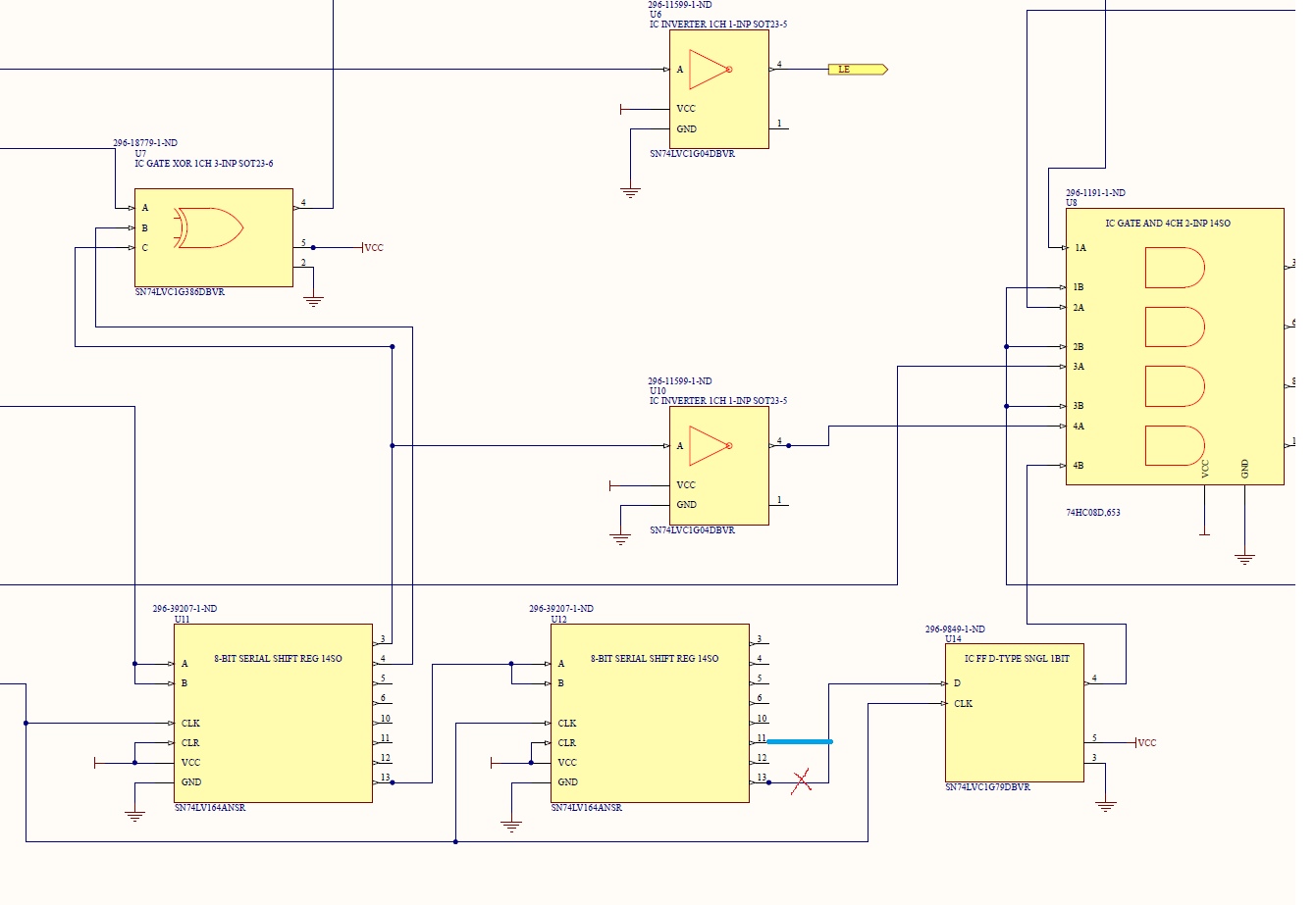

if I recall correctly, there are some digital filters.

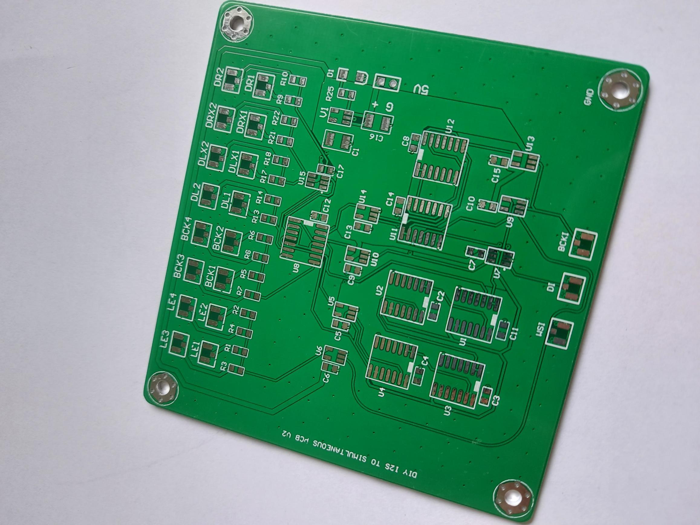

Indeed I have both, but at 1206 case size this is not what I will putt for my own at some areas (though C0G exists)... Notice on the boards you are talking about caps are way littlier must of the time, 04 size is not rare on them... so class II, hey !
@ Miro, so do I, while there are cool smt as well usefull (think inductance and magnyfing glass :yikes:), so frankly I will not use X7R for the DEM element matching network... everyone being free of his DIY toys at the end of course - YMMV -

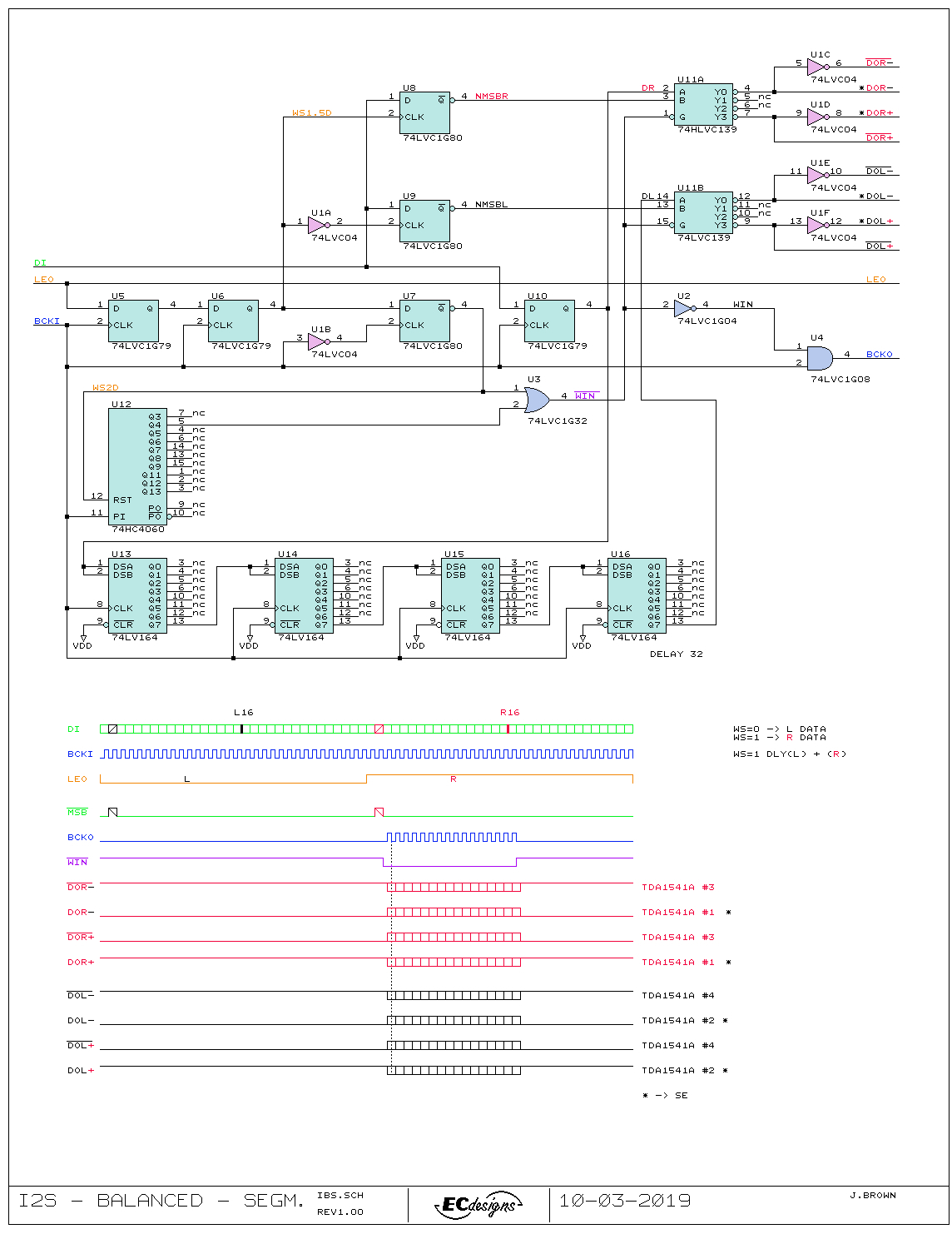

This is for 16bit Time Sim format from EC design.
(As we can se LE line is intact. Like maybe most important line.)
It is stopped bit cloc operation. And design i working. Some members are build this circuit i think?
For 14 bit, with TDA1540, maybe only intervention will be to change pin at 4060 from Q4 pin 5 (16bit) to Q3 pin 7 (8bit). AND ADD 6 bit count or shift to 14bit?
