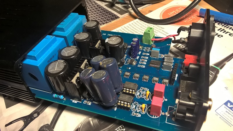

I got mine today. I put in some LM6171s and removed the 2n2 caps. It sounds promising so far. The only thing I am missing is the bass, so I'll have to add the capacitance on pin 7.
I also picked up some bass by replacing the existing supply caps some bigger uF low esr caps.
Ordering caps today, the plan so far :
1. 8x 6.3v 470uf Nichicon FG for pin 7 . Those can go either on top or on bottom, not sure what's easiest with my limited skills.
2. Big KA cap on main dac supply position.
3. 1 or 2 Low ESR for the Opamp decoupling, remove grey films.
4. Replace elko output dc caps with Wima MKS2 4.7uf.
I just had a look at your picture. Nice job fitting all of that in there! You added smaller (Oscon?) ones on the chip as well as that a big KA further away as the first main cap.
Do you recommend replacing the 4 caps right in front of the transformers? Yours are different than mine. I cannot read their value on mine, I suppose I should replace with good 35v/50v for safety.
The output caps, I already have good 1uf and 1.5uf lying around, would these cut off bass compared to 4.7uf?

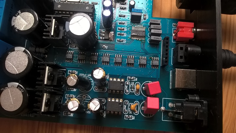

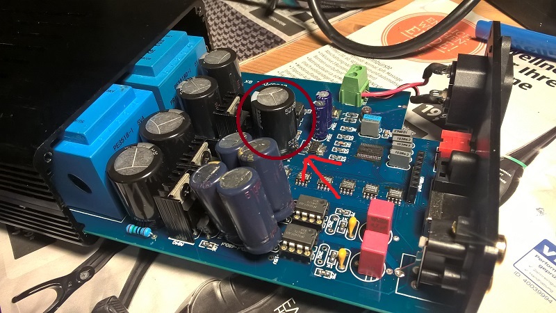

I removed the 105 ceramics but found out afterwards (stupid) that my replacement caps won't fit under the board. They are 6.3mm diameter, but the space is only 6mm in my case. I do not think I can manage to solder directly onto the pins, my soldering skills are rough. Would it be ok to try the dac without the 105 caps in place ? I did increase the size of the main pin 7 cap to a 8200uf 6.3v Panasonic FR. Otherwise I'll have to look for 5mm caps.
Its not going to do any kind of damage to run the DAC without them, no. I predict a dearth of bass :)
A main pin7 cap? So you wired all the pin7s together? Yeah that's definitely an option if you can't fit individual smaller caps closer to the chips. I haven't found any 5mm caps suitable for this, mine also are 6.3mm.
My Pin 7 caps were also 6.3mm - I don't recall exactly what they were. They do fit if they're completely flush with the PCB.
Edit: there are some photos in post #280
Thanks, I did think 6.3mm would fit from reports in this thread. But it impossible to insert the cap between the pcb and chassis.
I did not wire them together. I thought the bigger supply cap near the corner of the row of tda1387s would have this purpose, since it was mentioned that putting in 15k uf 6.3v and more ( I see some have 3 big ones there) would increase bass too. I marked it in the picture. My bad :eek:
I ordered some Chemi-con KZH 220uf 6.3v that are 5mm.
Panasonic have 150uf 6.3v FR/FM series with 5mm Diameter.

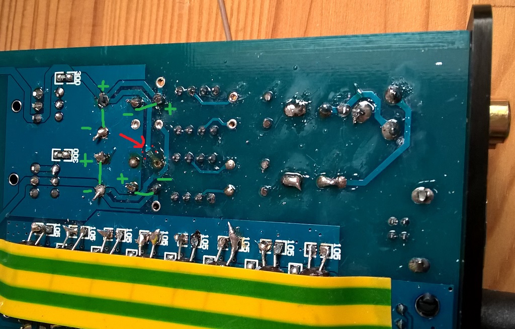

Hmm, the dac will only give music from one channel. I checked all my soldering joints and retouched them on the side that does not work. I also ran it outside the chassis. I put my DMM on the RCAs, both show some voltage activity. Changed output caps just to be sure, same thing. Maybe I damaged a trace. Any thoughts?
First I swapped left right op-amps. They work ok. I checked the panny caps before the opamps, one trace on the dead channel looks messed up due to my lousy soldering skills. I took the cap out and put the cap on the other side as illustrated in the picture. Now neither of the channels works.
As it is, with the black dmm cable on the rca ground and while playing music, pin 6 gives me -10v on both op-amps, pin 7 -1v.
