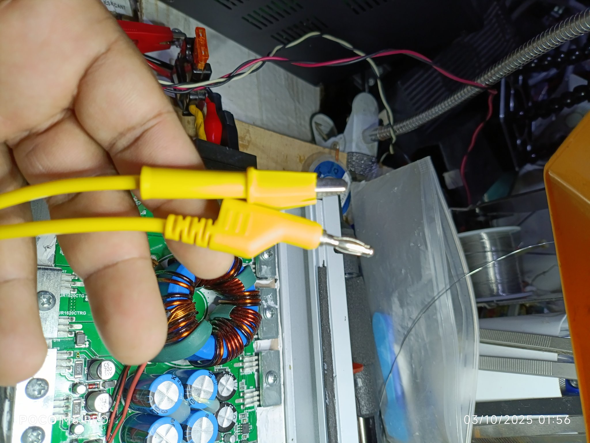

It's a 3ft banana plug to alligator clip to lengthen the ground wire.

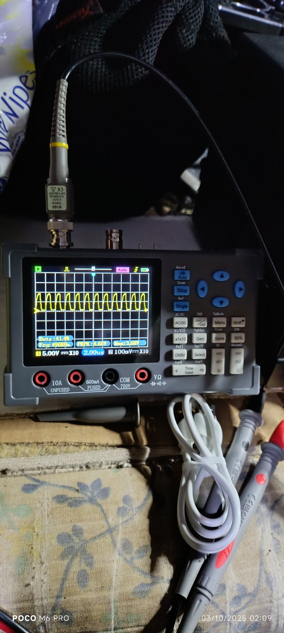

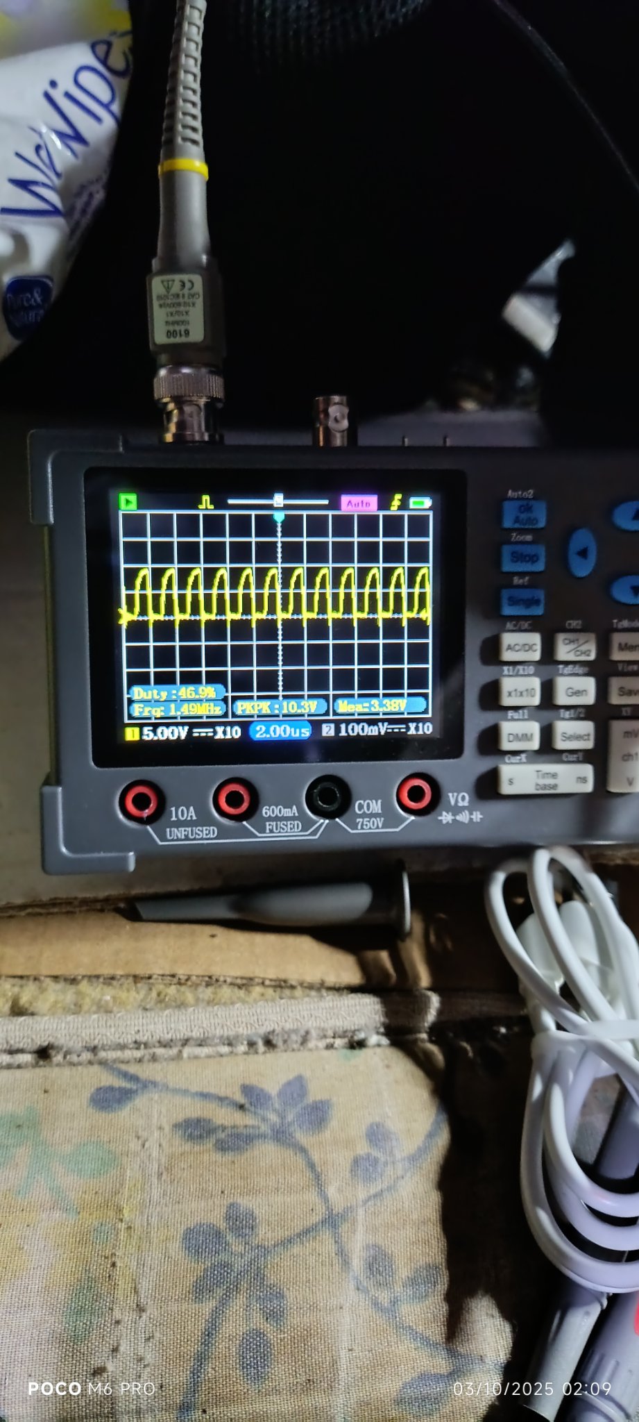

The scope probes typically come with that type of clip for the probe itself. You can hold the ground to take the photo. You can check the rest without photographing them. If you do photograph any more, set the timebase to display only 3 or 4 cycles. The resolution is too low with so many cycles.
Are these the original part FETs or did some fail?
Has anyone else worked on the amp?
1mil Kapton tape is generally OK for most class D amplifiers.
3 or 4 cycles? I've only been using a scope for a few months now so I'm still learning the ropes.

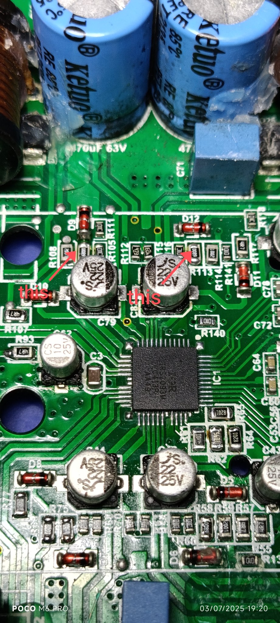

The only thing I changed was 4 6800 SMD resistors to 8201.
These and 2 more on the other side...
I changed them because they were significantly lower than the ones in the other amplifiers, so I thought they were passing to much current to the MOSFETs, that was my reasoning.
