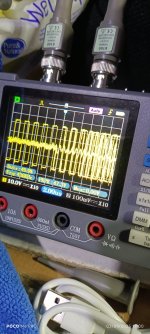

FETs in the circuit. The high-side B+ may charge without oscillating but without the FETs oscillating, it won't mean anything. The 4148 diodes are much less than most amps use. Confirm that all are OK.

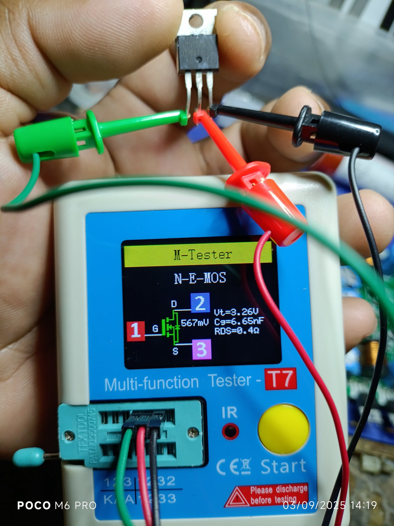

Also measure the DCV across gate and source terminals of all of the FETs. Do all read approximately the same?

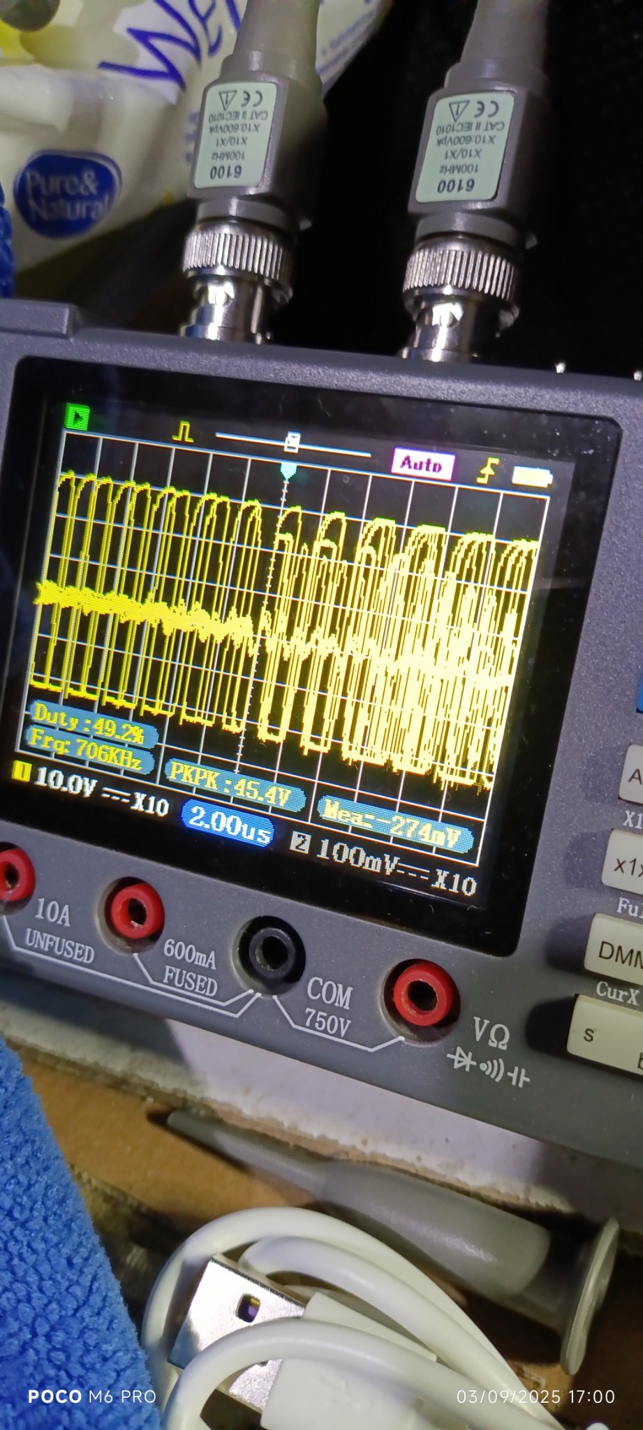

Channel 3 and 1 gate and source voltage is less than half a volt. Channels 1 and 2 are 3-3.5 volts.FETs in the circuit. The high-side B+ may charge without oscillating but without the FETs oscillating, it won't mean anything. The 4148 diodes are much less than most amps use. Confirm that all are OK.

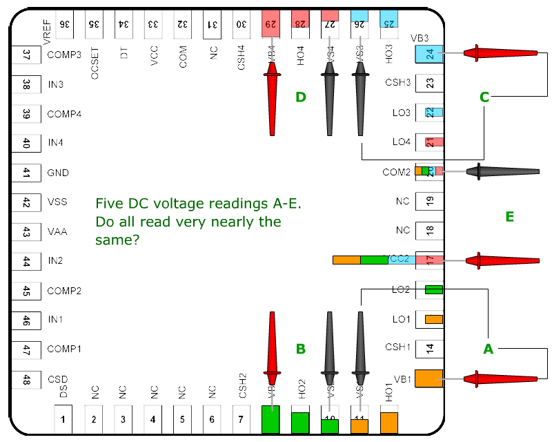

A 8.7 voltsAfter all channels are oscillating, check the voltage on all of these points.
Check the pads like you did the ICs (previous images) to make sure that there are no abnormal readings.
B 8.7 volts
C 8.7 volts
D 8.7 volts
E 9.6 volts
What's the DCV on all 3 terminals of the 12v regulator feeding the VCC and the VCC2 terminals of the IC?
I've set the PS to 1 amp so when the amplifier starts to draw excess current the voltage drops down to 7 volts and the rail voltage drops to +/- 22 volts. The regular that produces the voltage for VCC and VCC2 is measuring 10 volts on all pins when I just check it.
