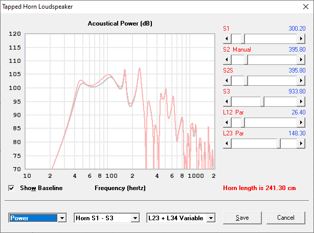

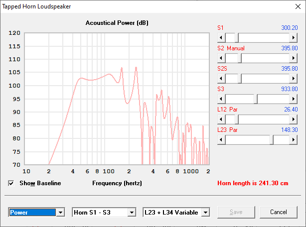

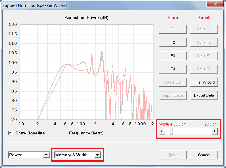

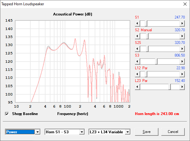

This shows the predicted response of the 15TBX100-4 in the horn, original size (grey) and the width reduced by 2 inches (red). The change is very minor. I doubt anyone would notice the difference. This also shows that that particular design is probably not the best match for the 15TBX100-4

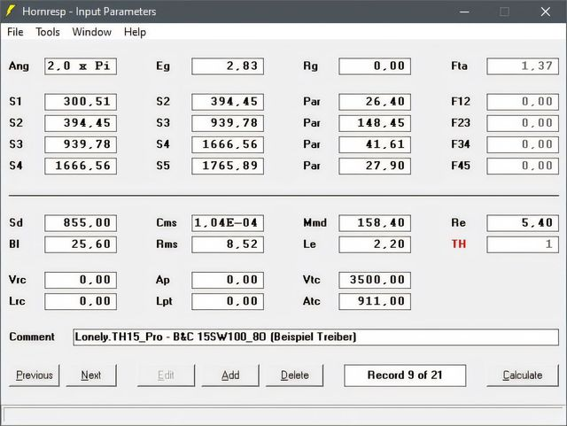

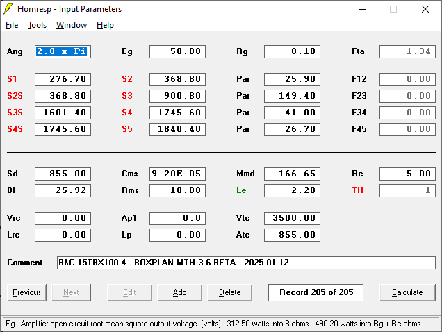

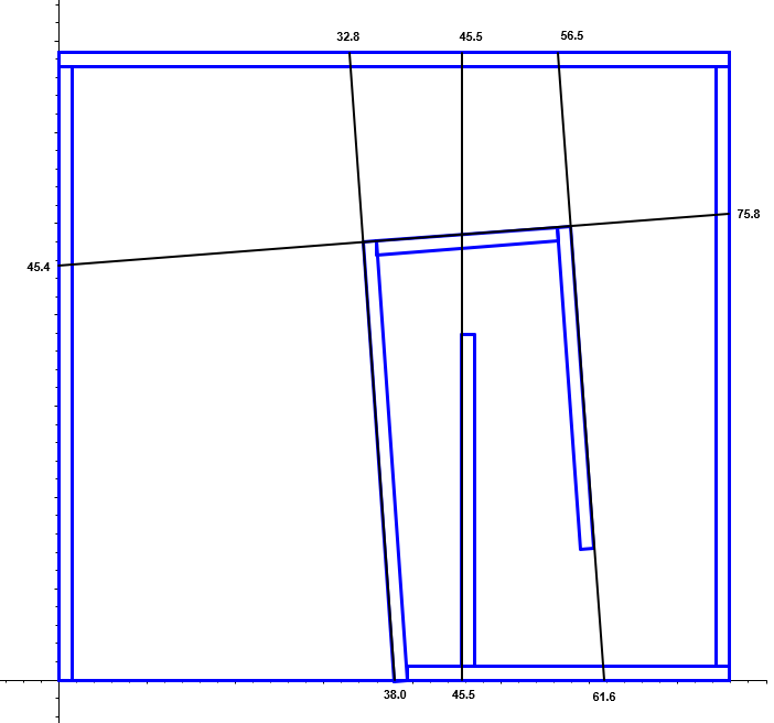

Well, I figured out why - my sim was a little slimmer than the Lonely TH15 Pro, LOL. Here's the Hornresp sim that the BOXPLAN workbook produces when the correct box size is entered:Almost done ...! The optimization routine is now working. Just a bit of cleaning up to do, but the workbook is working ...
Note: I've entered the external dimensions of the Lonely TH15 Pro, set the workbook to assume 15 cm ply, and adjusted the step in expansion and mouth ratio size to produce a result where the mouth height and expansion angle match the drawings for the Lonely TH15 Pro. The corresponding Hornresp sim is similar, but not a really close match to the published Hornresp sim for this TH. So, I'll do some more checks when I can.
It's still a little different from the published Hornresp sim for the TH:
However the overall path lengths are within a few cm of each other.
So, I adjusted the parameters (mouth/front ratio, expansion step and driver location) until S1 and S5 were closer matches, and I got this:
The parameters for S1, S3, S4 and S5 are now a LOT closer. The BOXPLAN workbook predicts the effective path length to be 241.2 cm, which is pretty close to the published 244.36 cm for the design, and I think the errors in the published sim around the transition from S3 to S4 could account for the difference.
However, with this change the BOXPLAN workbook suggests that the height of the horn's mouth would be 14.4 in, not 14.9 in. as shown in the plans. I'll see if I can find the reason for that discrepancy when I have some free time on my hands.
I've uploaded a new version of the workbook (version 3.5 BETA) that includes the changes that I made above.
I'm afraid we're talking past each other here.That doesn't change if the width is decreased. The overall volume of the horn changes however, which will change its response. If that change is significant to the person who wants to reduce the width, well, that's up to them to decide.
If I reduce the inner width without otherwise changing the housing, then the cross-sections of the line are also reduced.
For example, a Lonely.TH15, which was designed for the the box 15LB075-UW4, was turned into a Lonely.TH15_Pro.
The the box 15LB075-UW4 needs more volume to fully develop its potential. That's why the regular Lonely.TH15 has an inner width of 530mm.
I created the Lonely.TH15_Pro as an alternative concept that is only designed for the well-known, powerful drivers with a high power factor (Bl), because these drivers can cope well with less volume. That's why I simply reduced the inner width to 485mm, but the length of the line remained the same. I checked this using the simulation and created a list of alternative drivers that could work well in this project.

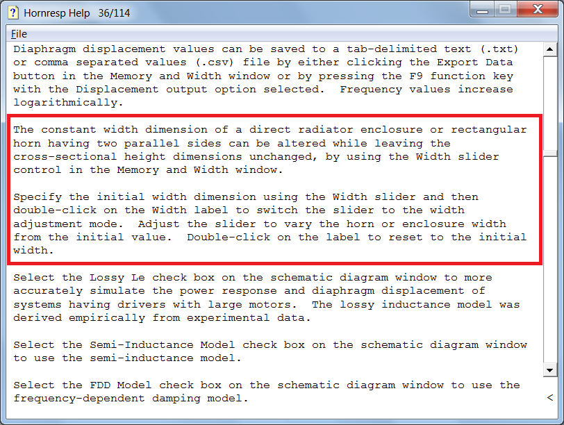

But your Excel files don't work like that.
You wrote that if someone wants to adapt the dimensions of the existing, original project (e.g. Lonely.TH15) to their needs, then your Excel table can calculate that.
If I want to adapt a TH housing while retaining all the cross-sections and lengths, for example to be narrower in width, then the housing will inevitably grow in height and depth.
You can do that to a certain extent, but at some point this calculation reaches its limits because then the position of the driver cannot be adjusted. And I explained that in post #55.
The goal is to keep the project as it was designed by the developer. But if the length of the line and the cross-sections are influenced or changed by the Excel tables, then it is "some project", but not the original.

The B&C 15TBX100_4O runs excellently in the Lonely.TH15_ProThis shows the predicted response of the 15TBX100-4 in the horn, original size (grey) and the width reduced by 2 inches (red). The change is very minor. I doubt anyone would notice the difference. This also shows that that particular design is probably not the best match for the 15TBX100-4
That was never the goal.The goal is to keep the project as it was designed by the developer.

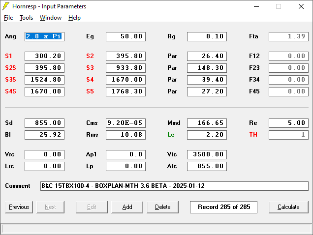

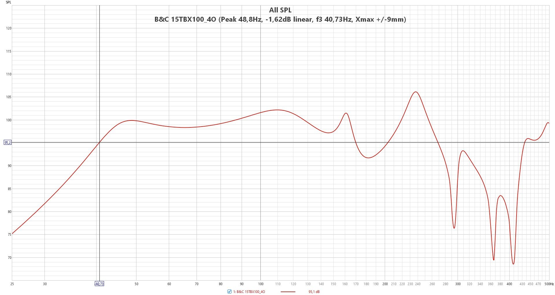

Did you include the driver's semi-inductance parameters in your model?The B&C 15TBX100_4O runs excellently in the Lonely.TH15_Pro
Ah, turns out that the t/s parameters I had in my Hornresp database for the 15TBX100-4 didn't match the ones published by B&C. Curious. I've updated them and the corresponding Hornresp model looks a lot better.

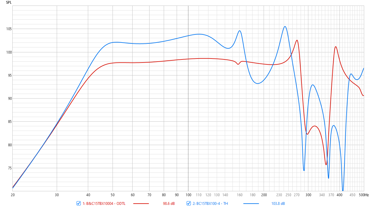

Comparison to a simple tapered ODTL with similar Fb using the same 15TBX100-4 driver. The TH's output is about 4~5dB more across 45 Hz to 100 Hz. However, the TH is also a much larger box (225L net vs 87L net).

Hornresp TH sims do not include the effect of box losses on the frequency response or impedance curve, so there will never be a "very precise" match between sim and results. If the sim is correct, of course. You can get closer by adding "fill" of 1 or 2 to each segment, but still, it won't be a precise match.

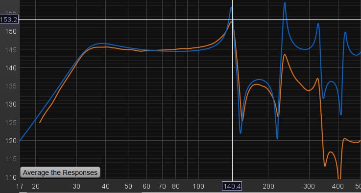

I don’t have issues with ‘box losses’ or simulations(blue) that don’t match measurements(orange)? Other than the subwoofer amps low pass filter these things are incredibly accurate.
Mayve it’s the excessive folding used in the designs that don’t pan out?
Well, it turns out that the height of the TH's mouth in the plans is 363 mm, so I think my calculation of 365 mm is close enough 🙂.
An advantage that the BOXPLAN sheet provides is the provision of guidelines to show where the internal panels should be placed. Basically, draw the guidelines and install the panels accordingly. I've updated the "Guides" sheet in the page accordingly.
