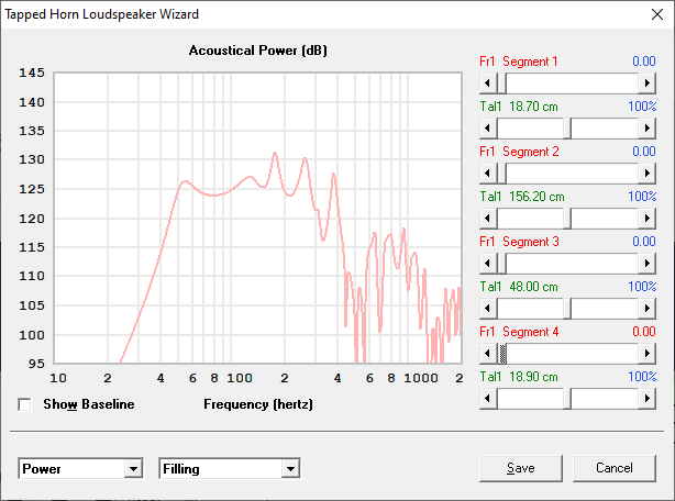

I wanted to go into that again. The idea behind my logic is the following........
Simulating a tapped horn with a constant opening angle or a constant expansion in 3 segments is OK, but not particularly effective.
I tried a lot when I first started using hornresp and simulated all the projects I knew.
At some point I started to use the well-known simulation as a basic framework and create my own from it.
And at some point I noticed that a tapped horn with 2 different expansions simulates better.
But the 2nd expansion must not be long.
In the end it should look like an alphorn.
A long tube that slowly opens from the throat of the horn and then opens much more strongly, almost exponentially, just before the mouth of the horn.
I wanted to design something similar for my THs.
Unfortunately, constructing a tapped horn with 2 different expansions is not that easy.
The first time I came into contact with two expansions was when I converted the JBELL SS15 in 15mm wood. The SS15 has two expansions, but the 2nd expansion is very long. That was better than what I've seen so far, but there was still room for improvement.......
The end of the story is that I came up with this trick with the 2nd, short expansion to finally be able to construct my THs the way I wanted.
The result is the projects I listed above.
Everyone is welcome to recreate them and have fun with them.

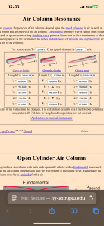

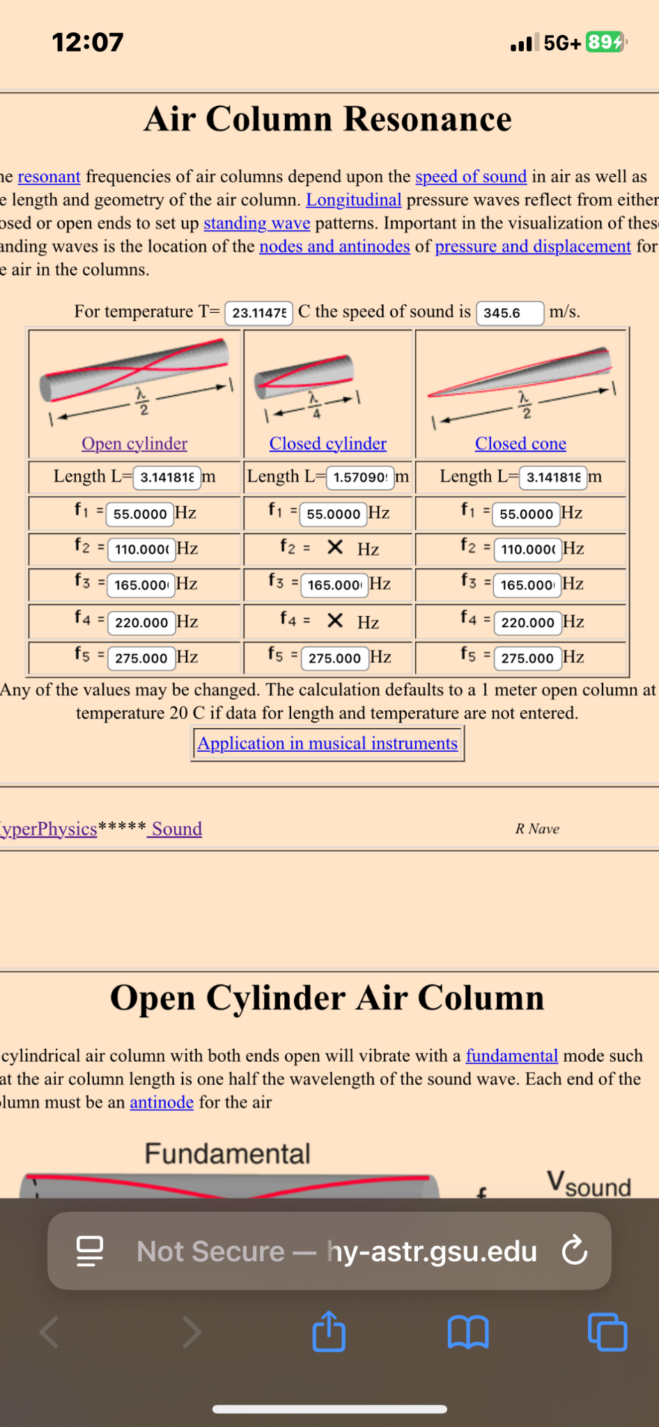

I think (??) the long skinny high pressure section/shape compliments the fundametal resonace when excited by high motorforce drivers ?
If you search in horn response for a location that doesn’t excite the second resonace the driver has to be halfway down the ‘horn’ (instead of 1/3 as in a plain ‘pipe’?
The ‘second expansion’ is occurring in the area that pressure is turning into velocity and complimenting the change with an increase in crossectional area? Then, the ‘Expanding area becomes pressure, not velocity and you continue the ‘horn loading’?

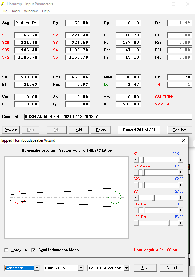

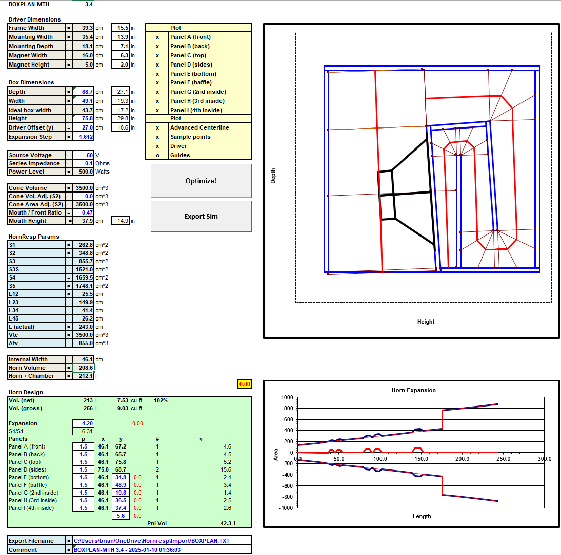

Almost done ...! The optimization routine is now working. Just a bit of cleaning up to do, but the workbook is working ...
Note: I've entered the external dimensions of the Lonely TH15 Pro, set the workbook to assume 15 cm ply, and adjusted the step in expansion and mouth ratio size to produce a result where the mouth height and expansion angle match the drawings for the Lonely TH15 Pro. The corresponding Hornresp sim is similar, but not a really close match to the published Hornresp sim for this TH. So, I'll do some more checks when I can.
Primarily it's to satisfy my own curiousity about this MTH variation, hence my work on updating my MTH Boxplan workbook accordingly. The BOXPLAN workbooks make design work a lot easier and allow quick answers to questions like "what if I decreased the width of the box by two inches to fit in my car? " and "what if I used a larger step in the expansion?" etc. The workbook allows the user to change the dimensions of the enclosure and then run the optimization routine to refit the horn to the new dimensions and produce the corresponding Hornresp sim for analysis.

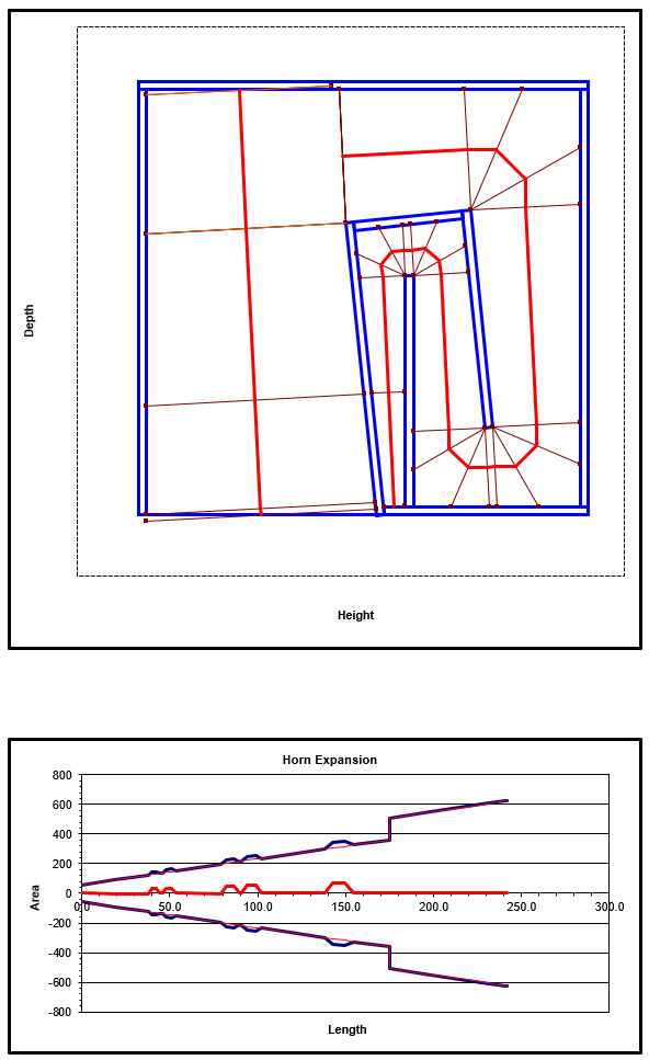

Hello Brian!

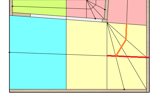

I see a certain potential for some inaccuracies in your approach.
If someone wants to, for example, make the plan narrower in width in order to be able to adapt it to their desired dimensions, as you say, then that is not always possible without further ado.
And for the following reason! If you make the cross-sections narrower, then the cross-sections grow in height. As a result, the horn line automatically becomes longer when you fold it around the corner. This means that you would have to make the line (in the plan!) shorter to get the same simulation results. But that also means that the L23 area (in the plan!) would have to be shorter, because otherwise the line would effectively be too long.
And this is where the position of the driver comes into play. Look closely at the drawing. The driver is already at the edge with its outer diameter.
So if you wanted to make the width of the housing narrower in the plan, it would actually be impossible to do.
And you only notice that in reality when you unfold your tapped horn as I explained in post #32. And not as you show it in your Excel file.

The purpose of the BOXPLAN workbooks are to use the external box dimensions provided by the user and provide the Hornresp sim for corresponding alignment (e.g. TH) that will fit in the box. It takes any external dimensions for the box you want to use, along with some additional parameters (in this case the size of the step in the last segment of the horn and the amount of the front that's taken up by the mouth) and adjusts the length and volume of the horn accordingly via its "Optimize" feature. For the situation you mentioned, the path length won't change, but the volume of the horn will change, so the response of the design will change a bit. It will be up to the user to decide if that change in response makes a difference.
