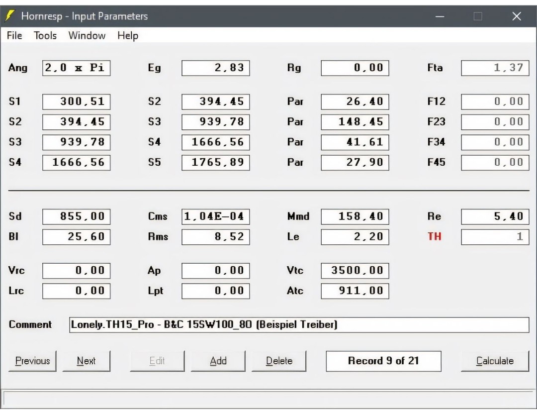

Almost done ...! The optimization routine is now working. Just a bit of cleaning up to do, but the workbook is working ...
Note: I've entered the external dimensions of the Lonely TH15 Pro, set the workbook to assume 15 cm ply, and adjusted the step in expansion and mouth ratio size to produce a result where the mouth height and expansion angle match the drawings for the Lonely TH15 Pro. The corresponding Hornresp sim is similar, but not a really close match to the published Hornresp sim for this TH. So, I'll do some more checks when I can.
Well, I figured out why - my sim was a little slimmer than the Lonely TH15 Pro, LOL. Here's the Hornresp sim that the BOXPLAN workbook produces when the correct box size is entered:
It's still a little different from the published Hornresp sim for the TH:
However the overall path lengths are within a few cm of each other.
So, I adjusted the parameters (mouth/front ratio, expansion step and driver location) until S1 and S5 were closer matches, and I got this:
The parameters for S1, S3, S4 and S5 are now a LOT closer. The BOXPLAN workbook predicts the effective path length to be 241.2 cm, which is pretty close to the published 244.36 cm for the design, and I think the errors in the published sim around the transition from S3 to S4 could account for the difference.
However, with this change the BOXPLAN workbook suggests that the height of the horn's mouth would be 14.4 in, not 14.9 in. as shown in the plans. I'll see if I can find the reason for that discrepancy when I have some free time on my hands.
I've uploaded a new version of the workbook (version 3.5 BETA) that includes the changes that I made above.
Well, it turns out that the height of the TH's mouth in the plans is 363 mm, so I think my calculation of 365 mm is close enough 🙂.
An advantage that the BOXPLAN sheet provides is the provision of guidelines to show where the internal panels should be placed. Basically, draw the guidelines and install the panels accordingly. I've updated the "Guides" sheet in the page accordingly.
