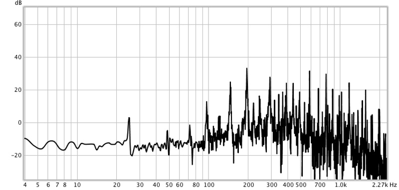

You will find that your "compromised" homemade speakers are going to mop the floor with the old commercial subwoofers, both in spl potential at low frequencies and in value.
At 16 hz it's all about driver excursion capability and resonant enclosure size. The more air the driver can move the better. The larger the enclosure the more acoustic gain. (And it has to be ported or resonant.) Add the two together and you get high spl potential.
The B-40 has a tired old driver with limited displacement capability. The cab isn't that large. This adds up to low spl potential. I'd love the driver and cab specs to simulate the potential.
Moving the system focus from your large 18 inch driver with huge displacement capability and large cab to the commercial cabs is going to be a step backward. If you left the current subs alone and just added the commercial sub, the new sub wouldn't bring much to the mix, it would be completely dominated and overshadowed by your current subs.
I'm sure the B-40 has a great reputation but if you bench test it compared to your 18 inch homemade sub head to head you are going to find that at 16 hz there really is no comparison at all, especially at their spl limits.

You are making a conceptual error. You are confusing the frequency conventionally assigned to musical notes with the stuff that your organ tone generator is putting out in its simulation of those pedals. I bet Allen knows perfectly well that nobody has a speaker is capable of more than barely audible sound at 16 Hz.
Please look at the output of your tone generator using the REW Real Time Analyzer function. SEE what is coming out of the tone generator. Betcha you'll be surprised what's there. You simply plug the output into your Audio Input on your laptop. Piece of cake.

From 2:30 to 2:35. That low peak is at 25 Hz, about 30 dB below the mid-frequency peaks.
Ben
Good for you, you found a low amplitude tone that is neither a 16 hz or a 32 hz note.
I'm sure if you try a little harder you can find a much higher amplitude note that actually corresponds to an organ pipe frequency. If the low end is filtered down on that recording and you can't find one maybe you should measure an actual real organ (one that's set up to showcase the low notes properly), I'm sure you'll be able to measure a 16 hz note at a much higher level relative to the mid frequencies.
