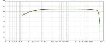

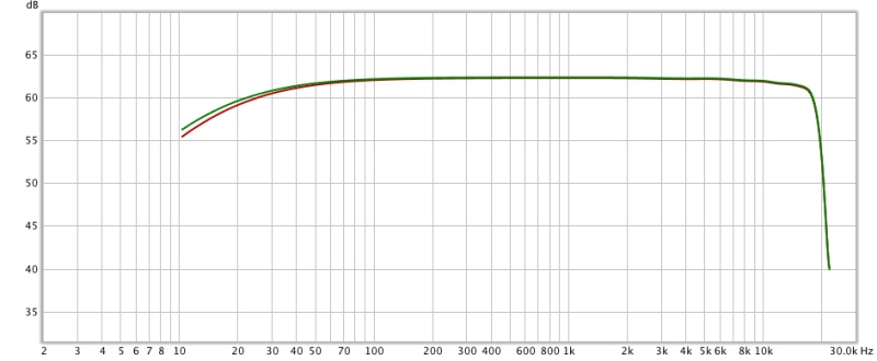

I suppose Zero posted before reading my plus and minus 1.5 dB footnote. Or just didn't believe me or trust REW. So here it is again, but in pictures this time. The bars are a mere 5 dB apart. BOTH transformers shown to demonstrate their comparability.
Ben

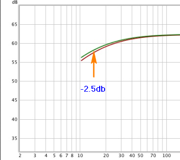

@ bentoronto
It seemed like you were talking about REW's capabilities ! So, you meant the TFR's. Well, the response you show of them isn't +- 1.5db, but around - 2.5db @ 16Hz !
I wouldn't use them for this project, but for regular use they appear very good value. I couldn't find any actual manufactures www real specs for distortion, or anything else ?

@ bentoronto
Well, I always like the opportunity to discuss how to measure things.
What i said was, the two transformers - not just individually but even matched together - are within plus or minus 1.5 dB 20-25kHz. And that's just what my chart shows. Yes, there's a tiny and totally imperceptible drop further below 20 Hz; but until I see Bach On's measurements, I'm skeptical there's real electrical content below 25 Hz or that he has speakers than play anything hearable that low.*
What you don't seem to remember is that measurements (mine and most everybody else's) are passing through the 50-cent DAC inside my MacBook laptop and ALSO back through my bargain-from-Hong-Kong Behringer ADC as well as the little isolation transformers you seem to disparage so much. All of them together are as flat as anybody could possibly want.
These two threads have been chock full of ill-considered needlessly purist advice for Bach On. And that includes some seriously deranged advice about ripping apart a perfectly good amp. An electric organ is a musical instrument and the standards you'd apply to reproducing Gill Shahan's violin or Diana Krall's voice in your music room may often be inapt here.
