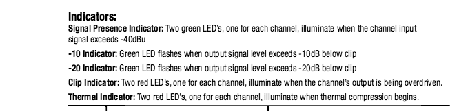

A quick look at the XLS meters would tell you if you are reaching the -10dB indicator, which would only be 52 watts at 4 ohms. Checking the output voltage with a true RMS meter on the AC scale will show you how close to full output is being reached, 45.8 volts is 525 watts at four ohms. 32.4 would be about half power, 3 dB less. You would only read 45.8 if the crest factor of the tone generators was 3 dB like a pure sine wave, the crest factor is likely to be upwards of 6 dB, in which case the most RMS voltage the amp would produce at clipping would be 32.4 volts RMS.
Each additional note played adds about 3 dB, if you play a chord you should see a lot more voltage than a single note.

The Crown XLS series has thermal compression indicators, as well as -20 dB below clip, -10 below clip, and clip (or clip/limit when limiter is engaged).
The XLS 1500 clips at 300 watts at 8 ohms, 525 watts at 4 ohms (which is the nominal load of the OP's speakers), and 775 at 2 ohms.
Crown's meters can be trusted to do what they are intended to do, give an operator an idea of what (if any) headroom is available.

When the clip light illuminates, you know the amp has "run out of moxie", regardless of speaker impedance. When the -10 dB lights, you know you have about double the moxie available at 1000 Hz, or four times the moxie at 20 Hz, assuming "moxie" equates to loudness...In short, watching the meters tells you exactly what the output voltage is but not how you stand vis a vis running out of moxie.
