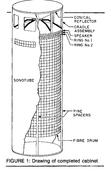

The wave cannon design seems to be predicated on the concept that the driver is placed 1/3 of the way into the tube. I'm going to make a huge guess that the 14 foot in the quote I've included includes the 1/3 length behind the driver AND the 2/3 in front of the driver.
Now, IF THIS rule of thumb is accurate, presumably an 18 foot tube could take us down in the magic territory that interests me.
But an 18 foot tube of over 18 inch diameter is a lot to fit into our speaker/pipe chamber - especially with all the stuff it currently contains.

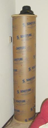

As I pour over the various threads and do searches for various horns, I see a great many folded horn designs. Most are constructed of wood with intricate labyrinths. Various programs can be used to help design cabinets to produce certain frequencies.

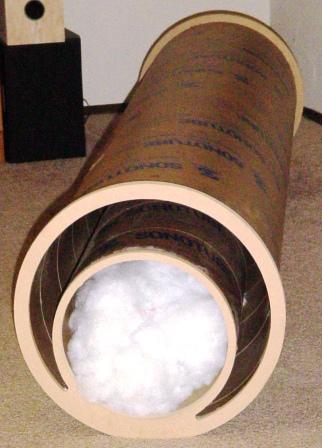

Using different sized sonotubes within one another could be used to produce a labyrinth - similar to the wood versions.
Here's one example:
End view of the same subwoofer
If my goal is to have a subwoofer based on the wave cannon design, why can't the nested tubes approach be used?
Is there a program that could simulate the results?
Otherwise, we're down to experimentation. And big sonotubes aren't easily obtainable in my area.

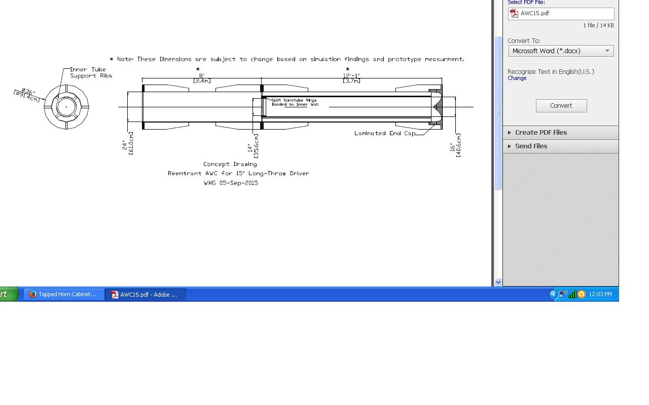

My current attempts @ simulating the AWC have not come out well enough to go that route. Once you have a flat to 16Hz target w/ some usefull extension a big port bass reflex does just as well (or better), and is a lot smaller.
Looks like the main argument for the AWC is that it might be possible to hang the tube into an otherwise unused area where it is not in the way (it really is big), provided one can come up w/ a simulation that looks promising.
I'll attach my attempt at simulating the AWC from Post #314 using the Dayton Ultimax UM15-22.

Hi Bach On,
Post #346: "...a subwoofer based on the wave cannon design, why can't the nested tubes approach be used?
That is what whgeiger is doing in his design in Post #314. The right hand side is composed of an inner and an outer tube, @ that point you basically have a transmission line (maybe think of it as a nested el-pipe-o); then the left hand side tube (extension of the outer right hand side tube) makes it into a tapped horn. You could also reduce the overall length by finding an even bigger tube, and nesting both right hand side tubes in it. Epa once did a nested PA-TH design like that using square tubes.

I guess I just missed the thrust of what you were saying. Sometimes I'm just slow. Sorry.
I did read Danley's white paper. I'm not sure I completely understood it. But I believe I understand how the concept he outlines fits into the design you are suggesting.
So this is the design you are suggesting.
The tube length adds up to the 32 feet of a Low C on an organ pipe plus one inch.
It's a 12 foot 1 inch 16 inch diameter pipe inside the 24 inch diameter pipe. All this is on the front side of the driver. There is 8 feet behind the driver.
Am I somewhere close to understanding what you are proposing?
The driver you feel that is optimum is currently $750. You feel that only a rugged driver with plenty of Xmax can adequately work in this type of situation for those lowest sounds. Again, right?
But anyway I look at it, this design will result in a 24 inch diameter sonotube assembly roughly 20 feet long. I'll have to do some measuring in our pipe chamber to see if we could accommodate such a beast.

RAWC Notes
Your welcome.
The inches don't matter in regards to length. 12 ft. will do.
Why can't you extend the output end of the unit into the listening space?
This unit will shake the whole building and loose objects in it will rattle as well.
The only driver I like so far for your application is 18". In my opinion it is a bargain considering the specs it is reportedly delivering. I am still looking for a 15" equivalent.
A good but imperfect indicator of value is $/lbs for drivers of the same magnet type.
WHG

Hi Mark,
Post #352: "... have yet to set up an exact simulation of Bill idea."
How about my simulation in Post #347? I tried to get close, using whgeiger's dimensions, 16" and 24" sonotubes, and a long throw 15" driver. Now, exact may be difficult.
OK.
Looked.
It is a great tapped horn.
But is missing the mass loading effect that Bill designed in.
I got close. But I am running a virus scan on my work computer. Not accessible right now.
That is why the lowest frequencies have that slump in the response. They should pick up a little with the mass loading.
All in I know that this is much lager than the room Ron has available.
It is an elegant idea.
Looked.

OK.
Looked.

Bill,
I've looked and measured. I won't have an area large enough to accommodate a subwoofer this large. That goes for inside and outside the shades. It looks like a promising project for a purpose like ours. But I'm going to have to go with a smaller package - even if it doesn't provide as much sound down low.
Thanks for sharing it and for the time and effort you've expended on the project.
The same goes to several others who have been working to produce sims.
Bach On
