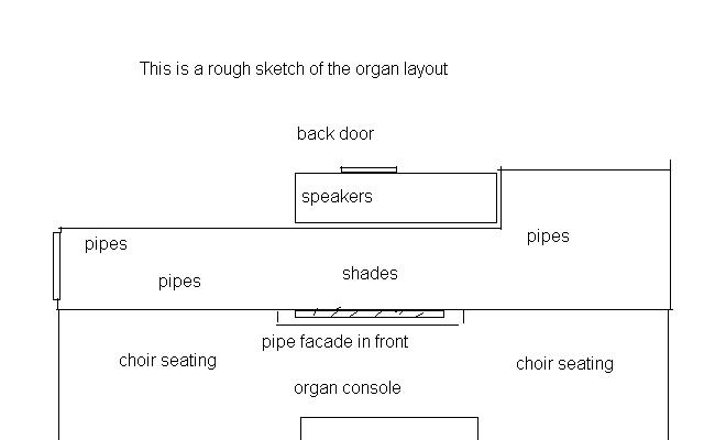

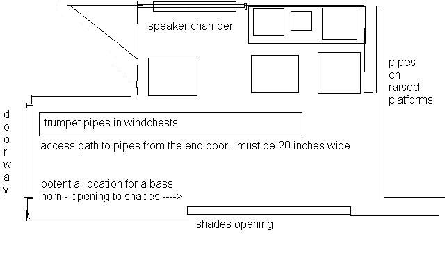

I toyed with the idea of Infinite Baffle drivers right above that opening (4). But cutting a hole through the plaster and lathe ceiling would be very messy. We'd have to remove all the pipes and cover everything in there to keep the dust from creating a huge problem. That would require lots of labor by our pipe tech and be very expensive. So I've rejected that plan.
I do have one area near the shades opening that would be suitable for another bass box. But a limitation is that it must be relatively narrow - on the order of no more than 18 ior 19 nches. Otherwise, there isn't room for people to have access between it and some pipes on the other side of the aisle in the pipe chamber. This is required for periodic tuning the pipes.
Here is one of my poor drawings to show what I mean.
The width of this area could be as much as 30 to 36 inches. And I think a height of 72 inches would fit. What I'm thinking is that the driver(s) could be placed on one of the 30 inch walls with a horn design (of some type) where the opening would come out right at the shades. Having the lowest notes of the organ exit right at the shades SHOULD maximize the amount of sound that could enter into the Sanctuary.
You'll recall that I'd made a decision early-on to have the speakers play at full volume as the pipes do to make voicing and balancing easier. The division of channels coming out of the amps have been setup with that in mind. The two current bass boxes are setup that way.
Some have suggested that I put another bass box out in the Sanctuary. But the sound engine allows me to make use of the organ volume pedal to adjust sounds for any channel - or to have it play full volume. But I cannot do both. (The volume pedal is called the Expression or Swell Pedal.)
So if I put a box in front of the shades for the low channel controlled by the expression pedal, the control would also apply to the two boxes in the pipe chamber. And the volume on those is already going to be adjusted by opening and closing the shades.
So I'm still leaning towards having all sound sources behind the shades.
I'm not focused on any particular driver yet. I only mentioned the SI HT18 because I'm familiar with it. It seems to have good bones for a ported box.
As you point out, some type of horn may need a different driver.

If I'm reading you right, the box can be 72" x 36" x 19", 28.5 cubic feet gross maximum.I do have one area near the shades opening that would be suitable for another bass box. But a limitation is that it must be relatively narrow - on the order of no more than 18 ior 19 nches.
If you confirm the dimensions, one could design something that would fit the space you can allocate, rather than suggesting things that won't.
That said, adding more of what you have, adjusted to fit in the space available would probably better than a relatively small (for the desired Fc) tapped horn.

If I discover that we need such a cabinet, I'm leaning towards one on the order of 72 inches High, 32 inches Deep and about 18 inches Wide. Those are external dimensions. I figure losses (motor, interior bracing, etc.) in the neighborhood of around one cubic foot. That would make for an interior volume of roughly 20 cu. ft.
JAG's observation that separating one box beyond the distance of 1/4 wave of the tuning frequency may introduce negative issues is valid.
Too, mixing a horn with ported box may introduce negative issues.
And I'm still hopeful the boxes we have may turn out to be adequate.
But I'm looking at a good potential solution that will fit if they aren't.
Bach On

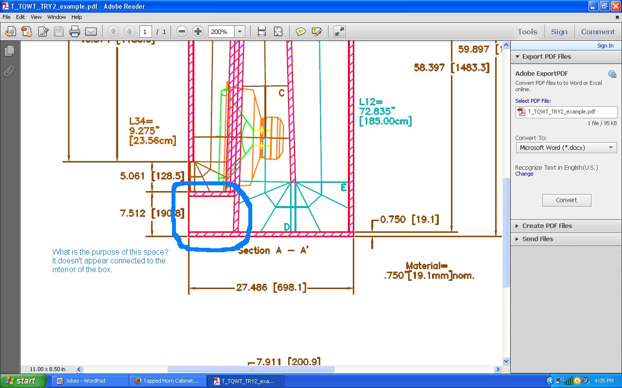

I went back to post 24 (page 4) of this thread. tb46 suggested a T-TQWT horn based on the Stereo Integrity HT18.
I've been studying it. The dimensions are pretty much within the available physical space I've been describing.
I've been able to follow the design, though there is one space I just do not understand. I've highlighted it in blue, Oliver. It doesn't seem connected to the interior of the box. What would this space do for the design? 😕
Would any negative impact result if I turned this box upside-d, own to put the exit near to the shades opening in our pipe chamber? My thinking - limited as it is - was that this would maximize getting sounds out into our Sanctuary.
Finally, it appears from the frequency response graph that there is a hump just above 60 Hertz. My thoughts were to give this cabinet it's own amp playing frequencies below 56 - 60 Hertz. A 2nd or 3rd order crossover system might cause a 12 dB roll-off from that crossover point into that humped area. So this sub would start to "wake-up" as the SPL of the others was diminishing. 🙄
Whacha think?
Bach On

Post #391: "...I went back to post 24 (page 4)...What would this space do for the design?...Would any negative impact result if I turned this box upside-d...
The picture shows part of the drawing from Page 4, Post #39, as it says in that post: "... there is still a bit of wasted volume...". This was the leftover space after finishing the fold as per Hornresp length. You have to stop somewhere 🙂. I have not had time to try to rework this design to fit with the new (Mark's) T/S parameters, and I'm not sure when I'll find time to look at this in any detail again, or to apply the JAG Fix to the design in Hornresp, etc..

Once again - a delay from Friday (today) until Monday. But soon. Then - and only then - will we hear what we have.
So the space I highlighted serves no "crucial" purpose. I get it.
I guess I just don't quite understand how crucial the T/S data is to the specific design of the T-TQWT box. But your T-TQWT design does look like it would fit our available space.
Your previous design on the Triangular box was good. So I just jumped to the conclusion that this one would be good too. I'm not pressuring you for work.

Hi Bach On,
Bjorno has been advocating the use of the T-TQWT, and the ones that have been build (that I know of) have been well received.
One other way of getting amplification is to provide individual plate amps to your cabinets. This would provide you w/ level, phase and crossover controls for each speaker, and should give you a lot more flexibility and adjustability to match speakers and room(s). Here is just one example:

Hi Bach On,
If you have room somewhere for a 5'x5' riser you could build a PPSL T-TQWT, here is a sketch 🙂 :
You're just full of ideas. But I don't think our space would accommodate this big boy.
Even if it isn't perfectly matched to that SI HT18, I think your earlier T-TQWT design is more within the scope of our available space (and shape). But I would need to have the exit opening at the top, instead of the bottom. Frankly, I can't see how that would significantly change the sounds coming from the box.
I know I've written this before, but I'm still wanting to have enough bass capability that none of the amps or boxes have to be run too hot. I'm just concerned this will produce distortion. I'd like to have enough reserve SPL that I may say, "OH wow! I need to cut that bass way down." 😀
Maybe Santa would bring me a used Crown MA2400 in good condition for Christmas to power it. (I just don't quite trust Plate Amps for this kind of setup. And it adds another level of complexity for turning it on and off remotely when the organ is switched on.)
I'll keep your design on my short-list for solutions if it turns out our bass cabinets aren't quite enough. That would probably be a good winter project. Then we could surprise everyone at Easter. 😱
