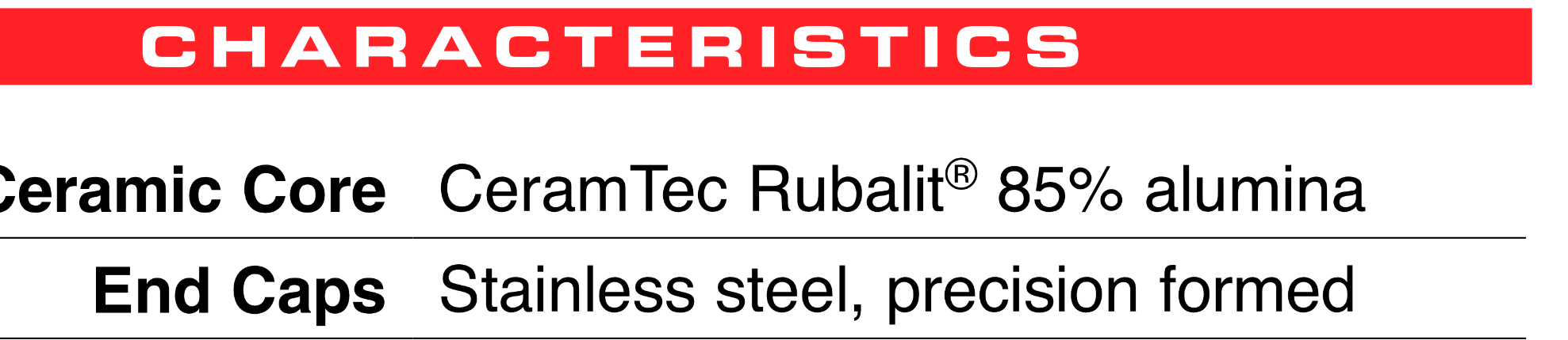

The issue of fake components being sold on Ebay has become quite complicated. Initially, it was fairly easy to avoid Chinese/HK counterfeit sellers. However it now appears that some unscrupulous sellers from other countries (including the USA and UK) are buying these counterfeit components and on-selling them as the real deal.
It's only the endcaps that are from steel, the leads are copper.Miniature Ohmite WN are made with magnetic steel material.
Are they good, any comparison ?
I can't compare them in working circuit for the moment is too new.

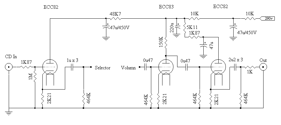

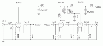

Will say we installed Caron Composite in the plate votage of my Defy7,, hummm, requested the tech place in the Takman Metal ~Rey~ ,,and sure enough the magic that Jadis had there before with metal resistors, came back.
I can verify your observation that the carbon Composite did ~~smooth/soften~~ the sonics,, but at a cost of fq separation, thus sound stage, As I say, i can esaily see why folks like the carbon composites for its ~~smoothness~, but considering the Defy has 6 6550's per channel, taht provides all the smoothness anyone could ever wish for.
The metal offer a bit more etched , sound, ~~harsh? , not with the fantastic Svetlana 6550's. which IMHO is the best power tube ever made.
Though I am sure one could esaily vote for your fav kt88.
Anyway, we will employ Takman Rey Metal in the jadis DPL 1st part of the circuit,
Richard likes to side with caution, and go slowly,
What i love about Takman is you can find nearly every value in the 1/2 watt and 1 watt. The only value missing is the 470K, for that I will go with the ~~Audio Note Tantalum~~ Made in Britain.
Takman 's are $1.50 each, the AN go for $17.
I need a quad of AN 470K.
Here is my question, how will the Tantalum's voice in that stage of the circuit?
Here is the DPL schematic

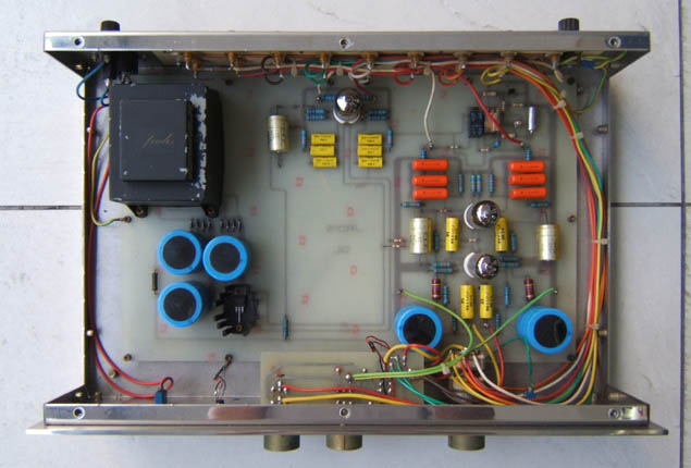

Here is my recent upgrades to the DPL,
Come to find out as i brought pre home, is that 1 speaker has xover issues, which Madisound is now in the process of rebuilding new xovers with Mundorf Silver Gold caps M ultra resistors.
Previous were Hovland Caps, which the tech cked and found all good, both xovers will be up for sale.
So hard to say how the DPL repsonded with the new M caps, due to 1 weak xover.
But preliminary opinion is thumbs up, = a winner.
