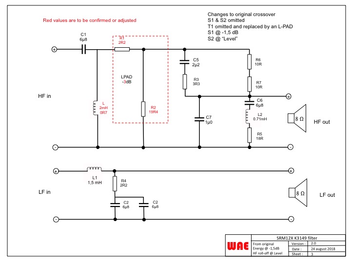

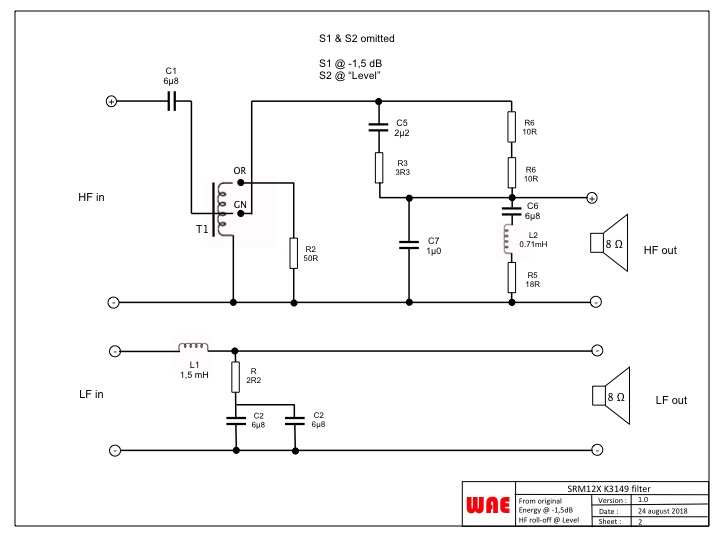

With the help of the more knowledgable in this forum and reading proposed documentation, I am trying to understand the principles of a crossover.
Came up with the next version (see attachments in this order);
1 - The original (I own 1)
2 - Replacing the rotation switches S1 and S2 for a fixed wiring solution. The switches can be seen replaced on all Tannoy model from around '80's by (as far as I understand gold-plated screw solutions).
3 - Replacing the autoformer / coil solution for a simplified setup, using an L-PAD.
Think I'm going to decide on brands and types of components, find a web-shop and order. Must be starting sometime.
Improvement suggestions always welcome.
kind regards.

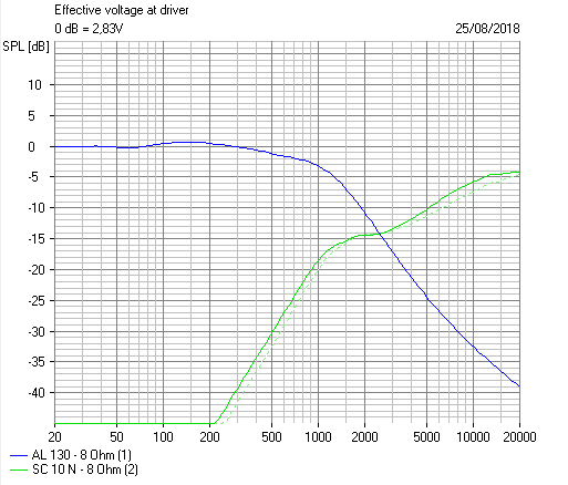

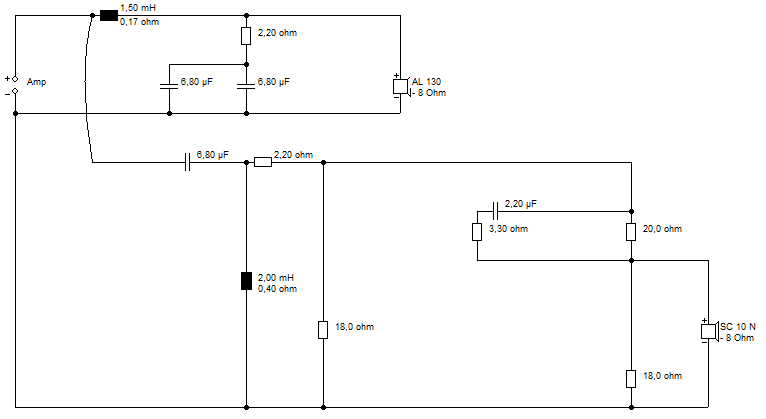

I just ran a sim to see if I could estimate what that tweeter filter does. Crossover around 2kHz. It looks like a simple step on the tweeter to allow for the typical 6dB low down gain of a horn tweeter between 2-5kHz.
In fact the main event is the 2.2uF/3.3R in parallel with 20 ohms to do this. Into approx. 6 ohms tweeter.
You can do much the same with a few resistors and the 2.2uF! I could probably simplify it further. The dotted line is the simpler circuit. The main line is your proposed circuit.
Hi Steve,
Nice to see your on to this. Maybe for now we'll settle with this version. I need to start building the cabinet and see what this brings compared to the original crossover I also have (just one). I could compare the original in the same setting as this version of the crossover and listen what a new version without the components I did not like compares to.
As said earlier, I don't like switches in a crossover, so wanted to get rid of them anyhow. We succeeded (well, you did) in that. The autoformer is OK if you want to be flexible and even "uplift" a signal. I don't see any need for that, the HF with the little horn inside the Dual Concentric is way more efficient anyway, then why crank it up even further.
Detail, you mentioned a dotted line, I'm afraid I don't see a dotted line in the filter drawing you posted.
kind regards.
It's all a bit "suck it and see"! 🙂
You are right, it's hard to see the dotted line. It's about 1dB below the original green one:

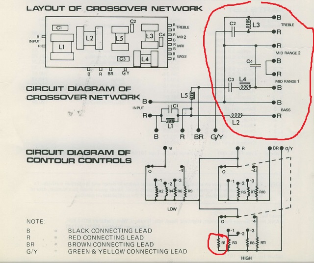

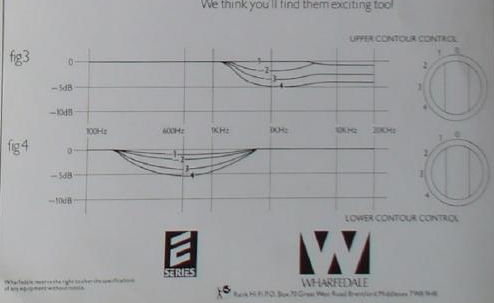

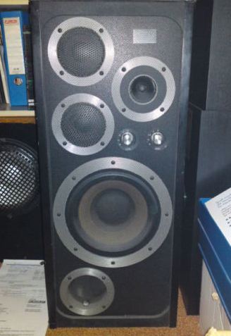

I have diddled with this sort of problem before. The excellent Wharfedale E70 had some user tone adjust. In level form, it reduced to the easy circuit outlined in red. The slightly complicated elements just got switched out of circuit. Don't know why Wharfedale bothered really. 😀
Seems we're not the only ones that stumble into the same issue and make a big fuzz about it. Makes me think at least 10% of us people over the entire globe are constantly (well sort off) working on the same issues coming up with mostly the same or slight variations of answers. Mind you, we think we're the most intelligent animal on this planet. Being busy ehhh..? 🙄
Thats just me.....

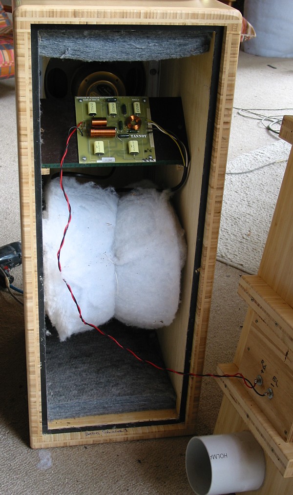

Damping
Found this one on the internet.
IS this a more effective way of damping. I've always used the traditional side-wall damping approach.
Can it be simulated / OR just don't bother?
kind regards
Hi Wae,
I can't say if it is more effective damping but it is a way of doing it i've seen in many speakers from 80's and 90's.
On my own main loudspeaker the damping is a large sheet of kind of recycled wool tissue tense at center of box ( and some more in the bottom of box).
