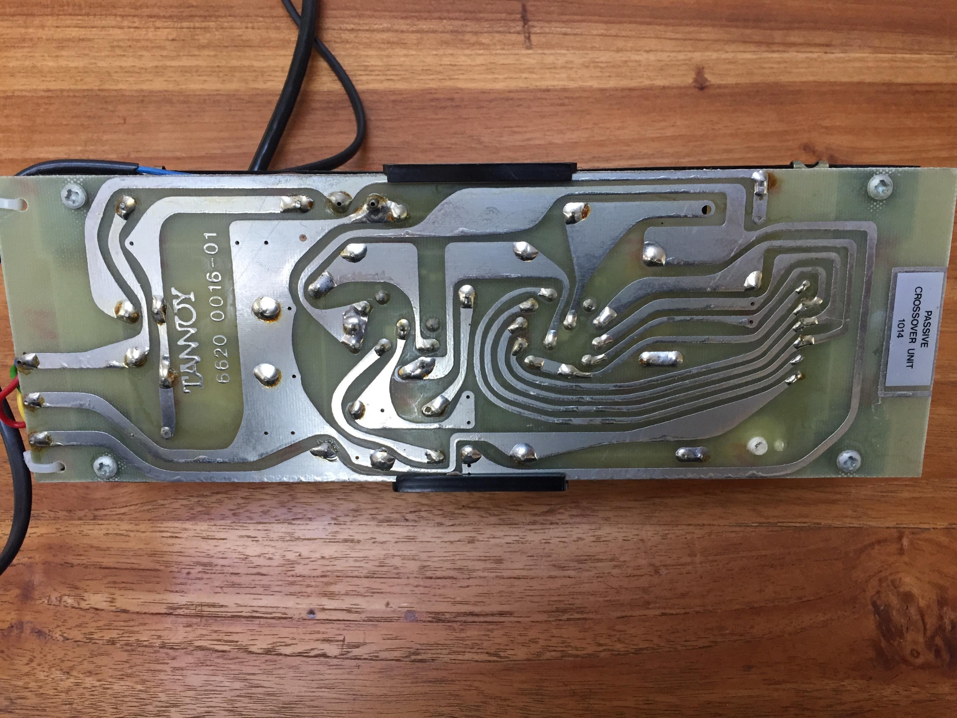

1 - Printed Circuit Boards are detrimental to sound quality.
2 - Star earthing is of paramount importance.
3 - Components must be held down securely to prevent microphonics.
4 - Wiping contacts and switches downgrade sound quality significantly.
5 - Gold plating of electrical contacts is beneficial to sound quality.
6 - Connecting cables can have audible effects.
Some of these issues are also addressed in the cross-over upgrade article;
1 - Use wiring instead of copper traces on PCB, which degrade in time.
2 - As stated, do NOT use long "-" or earth copper trace (or even wire) but, just as in normal live earthing, lead all wires to 1 central point. This way you will never have the possibiity of current delta's / ground loops / HF oscilation on the "-" wire in the cross-over.
3 - Glue them or tie wrap, I found that the "hot glue pistols" work very nice.

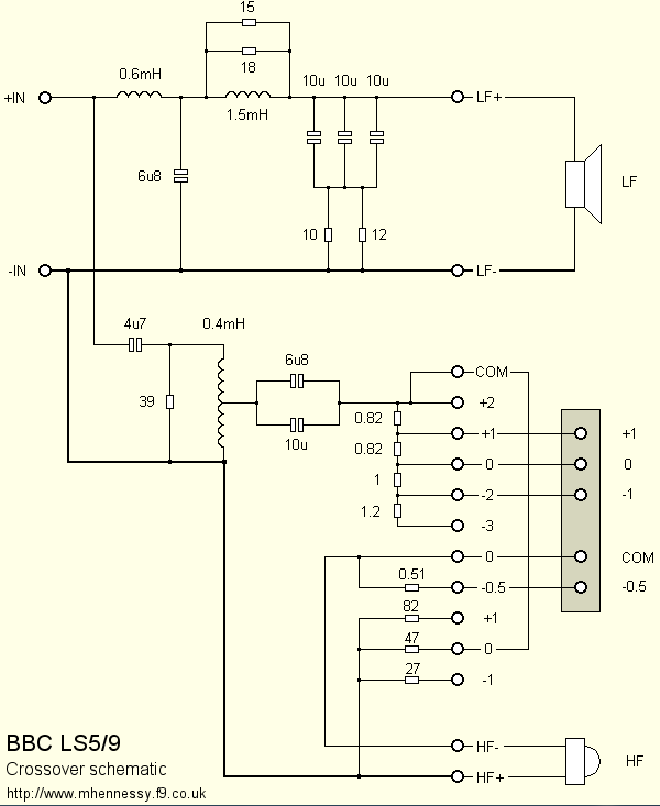

4 - The other issue with the autoformer and the option to be able to select HF level and HF roll-off, they use switches.
BIG question, WHY not measure and listen and find your optimum for level and roll-off and then replace the switches with fixed wiring and the appropriate components for the filter HF level and roll-off. I can't see a point in having selector switches when the loudspeaker is used in a fixed setting. If you want to move it from one location to another and another and another, OK. I WILL NOT, will you??

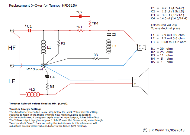

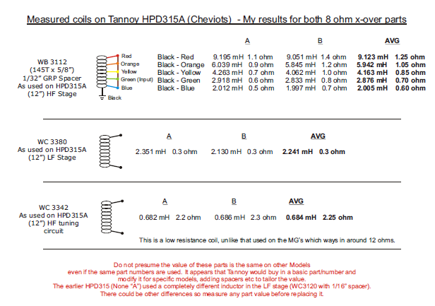

Cross-over modification article
Just by accident, or by deep mining the web 🙄
I found this article on some-one who seems to know what he's doing here. Gave me more insight in filters, issues with them and solutions / alternatives.
It happened he also used the Tannoy R&D findings as mentioned in my previous post.
The article is very informative and holds foto's to show the solutions.
Much credits to John Kenneth Wynn here.
It's this solution to get a good cross-over for my K3149's, I want to use.
I know, the SRM12X will not be "standard" any more, but it wasn't in the first place. I will build a replica, since there are no original cabinets. Just like restoring an old car, what's not there or unrepairable needs to be replaced.
The cross-over however, could bring so much more to the table, that this NOT being the original filter is not an issue by me, for this project.
Autoformer;
Did send a message to a guy who specialises in autoformers and one of specials. Let's see if we can come up with a solution to build exact replica filters.

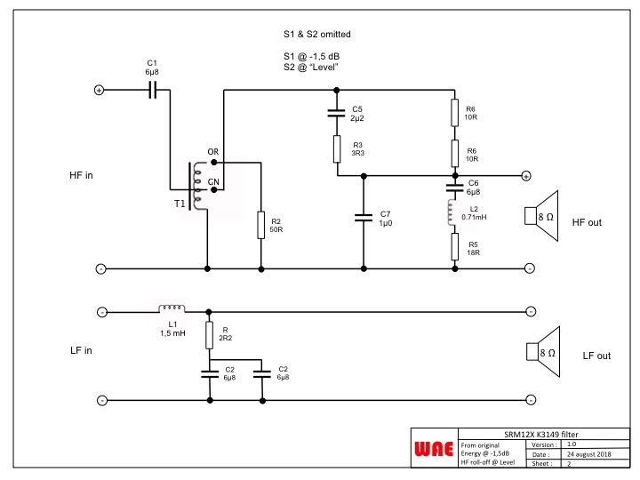

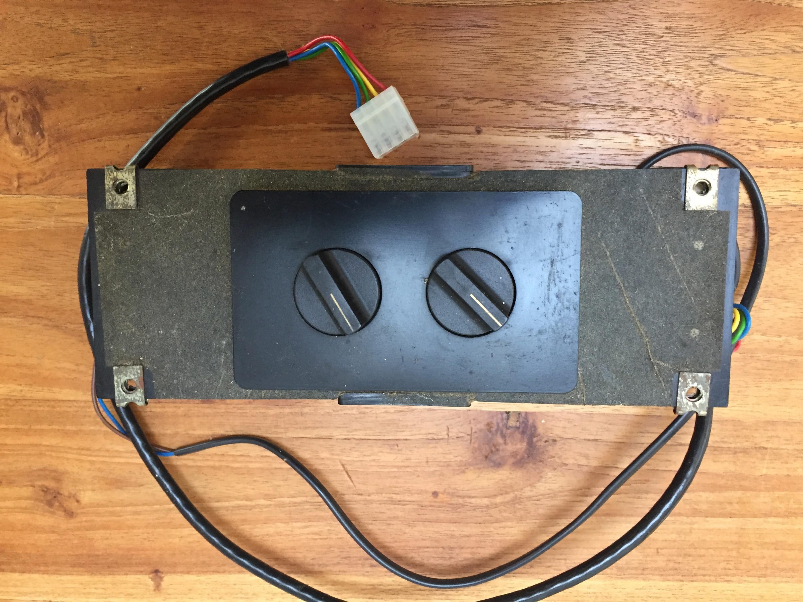

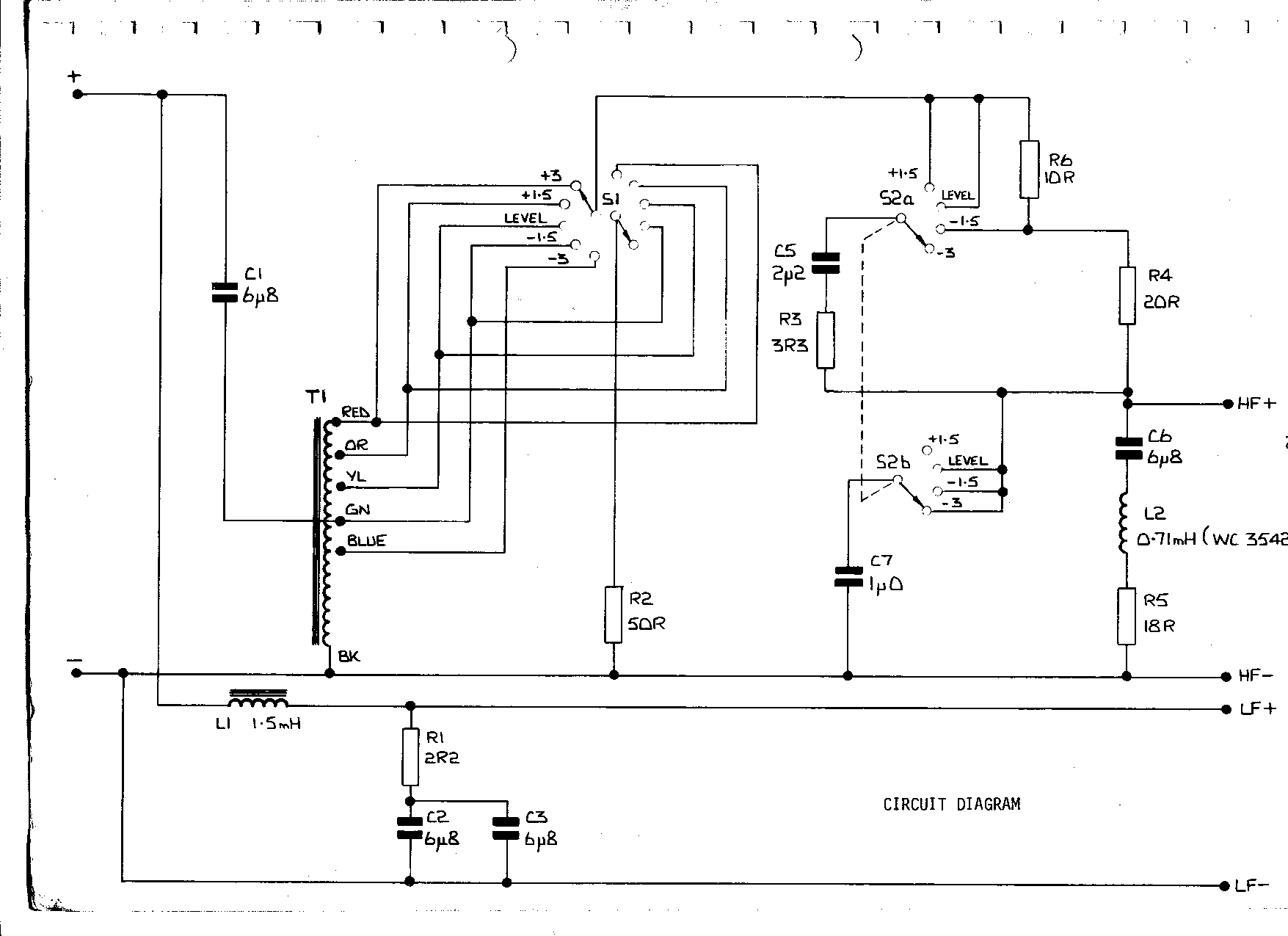

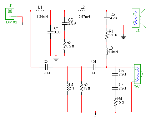

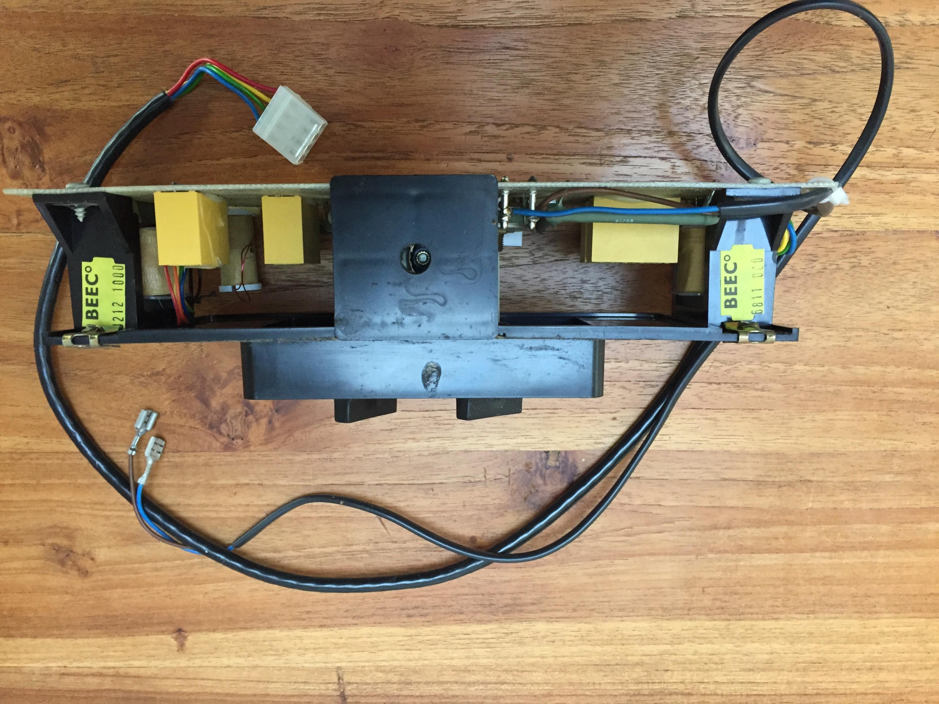

SRM12X Cross-over WITH autoformer
So far, I kind off settled with the idea that I was never going to get my second cross-over for the SRM12X.
Making one from scratch would give me some challenges;
- I need the filter schema: Got that
- I need the components: Not a real issue, except for the so called autoformer
- I need to build the same physical frame, or at least the part that sits behind the filter front: With a bit of creative engineering can be done.
Having said that, I think the real issue will be, it will NEVER be the same as the one filter I currently own. Which means I need to build 2 and use my current one as a museum peace 😉
On the autoformer, although at first never thought I could get hold of one, just happened to find a guy in the USA who could supply me one (at least that's what I was asking for). Luckily he pointed me to the fact that building one is NOT a wise road to travel. OF-COURSE I need two from the same materials, build the same way. That's the only way I would get 2 almost the same (give or take a most likely ignorable tolerance).

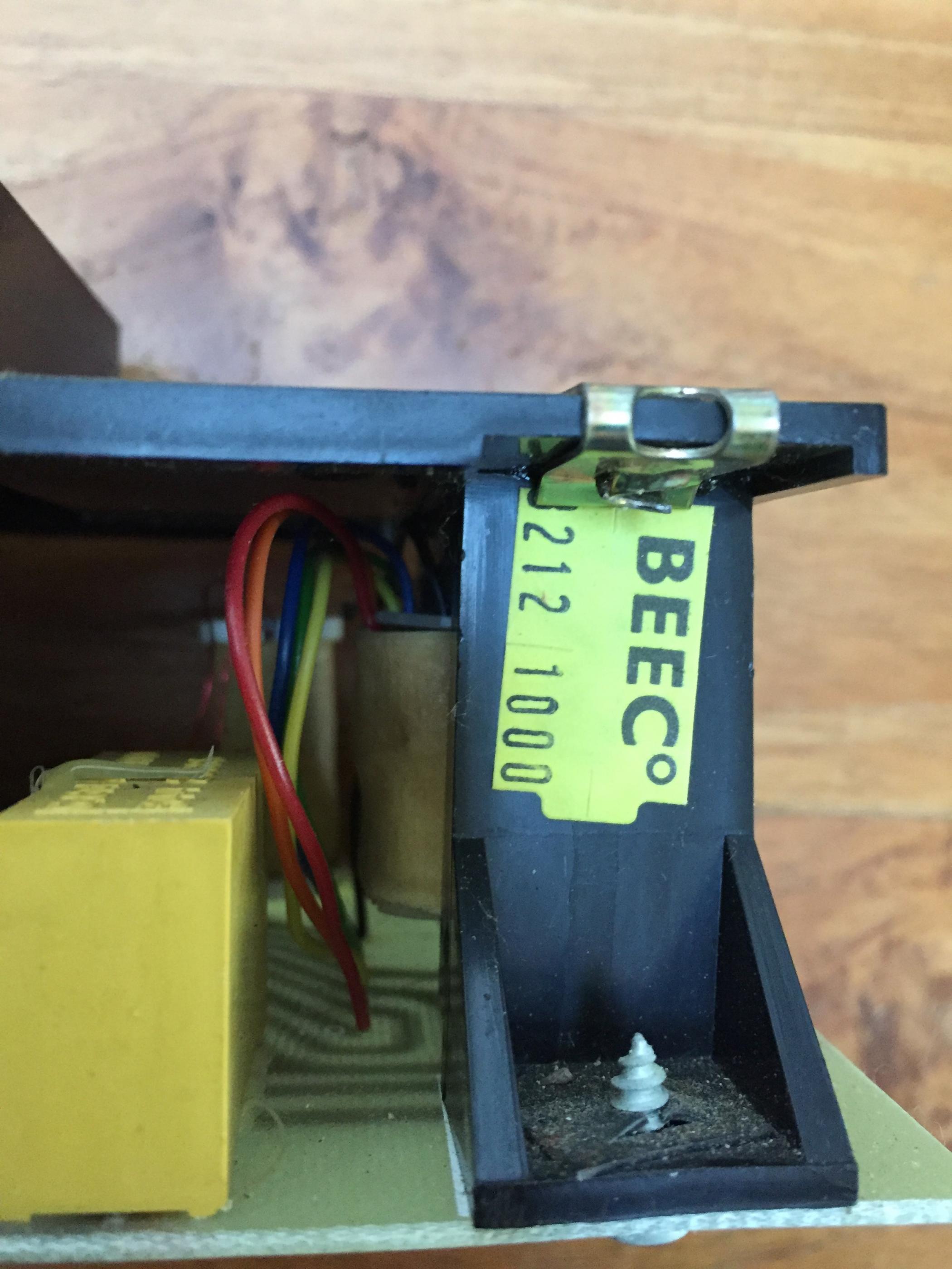

Added are some pictures of the filter and it's front plate, need some cleaning here but that's ok.
Although recreating the old filter, I WILL change a few bit's. At least do the following;
- Do some more reading on filters (not my prime expertise but I understand electronics to an acceptable degree). We are talking the 60's and 70's here when I tried (well not really) to get a degrade in Electronics, but at that time the "Music, girls and having fun" part of my live successfully killed the ambition to get the degree..... 😱 / 😀 "Now pay some attention boy, You'd have, I said, You'd HAVE to get that knowledge into your little head you know..... (Yeah LOVE Foghorn Leghorn). 😀
- Apply some improvements on the physical side of the filter, like wiring instead of copper traces, star-earthing, improved components, NO switches but gold plated connectors , etc.)
- Change the wiring to the drivers and the connection panel
- Make it bi-wireable on the connection panel.
To be continued,
kind regards

Thanks for your explanation. Your earlier statement makes sense to me now.
I haven't critically auditioned that particular Tannoy autoformer ( as a part ) > so can't really comment much on it ( though ) ;
- I was prepared to mod my cousins HPD315's some time ago ( I had lot of nice sounding caps that I assumed would be an improvement ).
- Well, I listened to his system first and then decided against it ( somewhat along the lines of "If it isn't broken why fix it? as my thought process ).

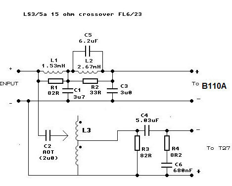

HERE's a thread to from another Tannoy user, who changed out his crossovers ( & was quite satisfied with the results ).

How's that for alternative crossover modification... 😀
The other variation is to completely redesign the filter and leave out both level and HF roll-off, replacing them for a fixed network after some measurements and listening.
QUESTION: What would be wrong with a set of resistors to tame the HF level (like an L-PAD with a series / parallel resistors of good quality)
I don't know yet. Bi-amping does not cost more than $20 for some wire and 2 extra connectors.
Your options are welcome.
kind regards

I can't think of any reason whatsoever why a cored transformer or autoformer style might be better than a simple air coil in this use. Transformers were traditionally more useful with low impedance microphones and LP cartridges into high impedance amp inputs.
If the Tannoy is being operated in the -1.5dB position, the input and output use the same tap, and the autoformer reduces to a simple coil in effect.
The BBC used an autoformer in early versions of the LS3/5A, but converted it to a simple coil and resistive ladder later. Can't imagine what the agonising here is all about.

Although not the crossover expert here, I did try to put up a simpler version, leaving out the S1 and S2 switches. I choose the switch setting "-1,5" for Energy and "Level" for HF roll-off.
What I noticed is that the autoformer still takes its place as a 2 tap autoformer. The Green for "straight through" BUT also the Orange tap connected to the resistor. 🙁 Am I wrong here, or is the original schematic wrong. 😕
Would be VERY much my preference, assuming the right type and quality resister be used. So how do I get ride of the autoformer??
Help MUCH appreciated.

This looks like a good halfway house:
You don't nowadays often see a resistor in parallel with a shunt coil, but in fact it works as an attenuator. Think of it as adding a little resistive power loss to the coil. The Heybrook HB2 was the last example I saw, and I include the (slightly inaccurate, because the shunt coil on the tweeter must be nearer 0.2mH IMO) schematic along with the Rogers LS5-9 autoformer as edifying. The Rogers monitor has fine adjustment because it needs to perform accurately in the broadcasting studio.
Wading through an earlier pdf, I have extracted the pertinent parts. 2.9mH seems a huge value here. It reduces the filter to near first order IMO. I would sim this one to see what it does electrically.
