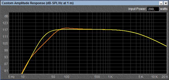

Tannoy SRM12x reconstruction?
So, I goy my woofer tester software and hardware. I did measure both K3149, they did not end up "identical" Anyway, for the box, it was not a real difference, so I made up the following sketch. End up close to "real" cabinet, except for the bass reflex, mine is a tad bigger (low vent air speed).
I added braces, don't know how the original internals looked like. I do know the particle board wood they used at that time was "crap" compared to what we use now. I know, I build boxes in that period. They used 25mm thick particle board for the front panel. I stick to 18 mm MDF and add braces around the speaker frame back side.
See attachment.
Yes, it does not go much deeper than 50-ish Hz +- 3dB with 73 liters. Adding volume fils up this quitte steep roll-of, but only from like 120 liters up to 200 liters makes a noticeble difference.
I added a graph with the 73 liter plot (orange) and the 200 liter plot (yellow). This shows whats happening. The driver suffers however, which most likely want make it sound better overall. That must be the reason why they did not make this a real BIG box. Soffit mounting the 73 liters is a peace of cake, it does not require much room. AND adds to the low end, may-be even filling this roll-of gap🙄
It seems like it's a designers choice, to support the driver, produce sufficient lows and small enough NOT to fill all the studio space. (My opinion).
My thought was, WHY make it 200 liters? They used these boxes to produce PILES of hits and nice sounding recordings at that time.
My plans to make it part of a larger TL as mid-high have changed. I want to make this one as close to original as it was and soffit mount it in my (ever to build) home studio. Even use the same veneer and color scheme.
I DO feel the need for a new thread for a studio monitor, based on a TL and using "cheap-but-best" components. See how that works out. 😀

Hi - i will follow this thread with interest as i have a pair of 3149 waiting to be reconed with Lockwood cones. They are the dual magnet type.
Charles' advice to add another 12' (or even15') for bass looks like sound advice to me and this is most probably what i will do. I seem to recall a thread by mpmarino (?) here with box indications, crossover settings you should look it up and maybe contact him?

Alternative, 2x 12" with K3149
Yes, it's obvious. The original SRM12X wasn't a bass monster. Charles option is a very nice one, although moves away from the initial idea of this thread. I got the K3149's at a reasonable price and wanted to recreate a set of SRM12X.

How about the design in the attachment? It's an 80 liter bass reflex cabinet for a Faital Pro 12PR300 BUT, added with a 15 liter CLOSED cabinet with the K3149 tuned at 160 Hz.
Bottom line here, ALMOST SAME SIZE as the SRM12X (slightly wider and deeper), LOTS of low end added, friendly priced (around 130 euro for the Faital). It is 18 mm birch ply 13 layers BB quality. Could be loaded by a Hypex PSC2.400 plate amp and a passive filter for the Tannoy. The Hypex has a DSP and is dual amp 2x 200 watt @ 8 ohm. Crossed at 160 Hz with the DSP and the passive crossover as designed by Tannoy for the K3149, but with NEW components to make it a top filter. The DSP can be used to flatten the combination if required. Would that be a killer?😛
That's what I will do anyway, make some saw dust and there they are. It's a simple box. As stated earlier, I would like to hear them in a Soffit Mount structure (sunk in the wall your are facing with the speaker panel plane leveled to the surface of the wall). As this eliminates rear reflections of low freq's of a cabinet close in front of a wall, it also add 6dB in the low end. A good soffit mount will also have a bass trap UNDER the soffit mounted speaker to "eat some of that added low", you can tune the additional dB's. That will make the SRM12X act like a 150 liters version while being a 73 liter cabinet. Now, that's a nice idea? Also because the soffit mount requires the wall to be at least the dept of the cabinet moved inwards of the room, you want a "undeep as possible" cabinet.
Now for C73 reply "Hi - i will follow this thread with interest as i have a pair of 3149 waiting to be reconed with Lockwood cones. They are the dual magnet type.
Best wishes for your build!"
Looks very good Wae. I am at a much earlier stage than you as i have to buy the measurement tools (i just have an UMIK microphone and rew for now, not to mention my 3149 are still unconed). I am aiming more at domestic reproduction than monitoring, one thing that keeps turning in my mind is an OB à la Nelson Pass. It will depend on WAF... I have Icepower ASC200 modules at hand that i could use for Bass. Don't know yet for mid/high, am going to watch closely what you acheive with the passive crossovers. Best,
