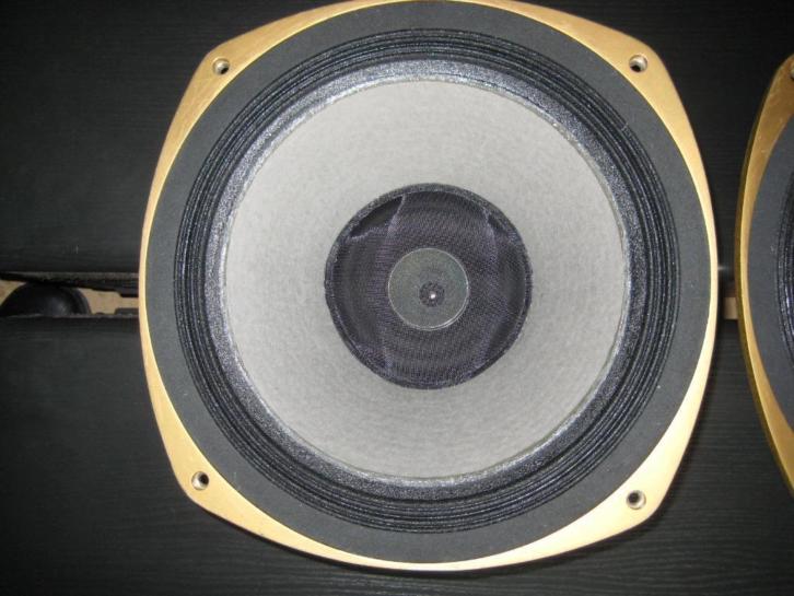

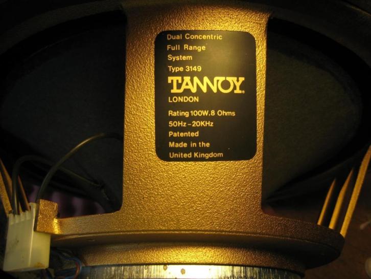

I bought myself a set of Tannoy K3149 speakers (Tannoys Dual Concentric 12") in mint condition. It came with 1 filter 😱 and 2 filter frontpanels 😛 .

Challenges enough, I found a number of web-sites that contain K3149 and Super Red Monitor data, including a schema of the filter used.
To my supprize, the T&S parameters found ALL differ, and not by a margin. I use Bass Box 6 Pro, to design my cabinets (with good results) and it also contains a 12" Tannoy (SRM 12 LF), but it holds a note (caution: These parameters were measured by an unknown source (never knew that an unknown source has this type of talent...😀) and may not reflect the original specifications of the driver.). These parameters ALSO differ from the others found, but seem "More logical".

Oooh , by the way, the picture attached of the complete cabinet of course is just an example of what will be the net result of this project. Duuhhh.

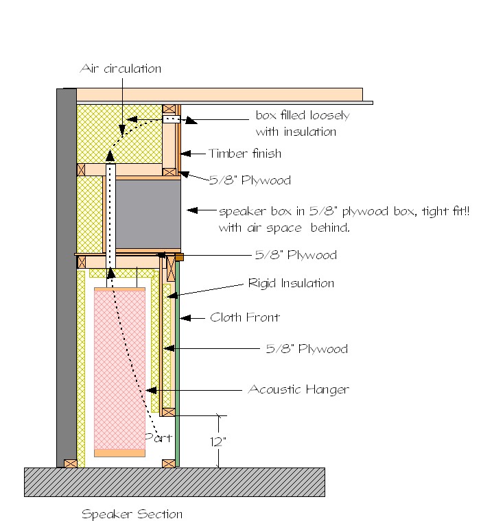

I added a drawing for "soffit mounting" for those who are unaware of this studio monitor placement approach. The air behind the box is only required when using active speakers, so I would skip that.
