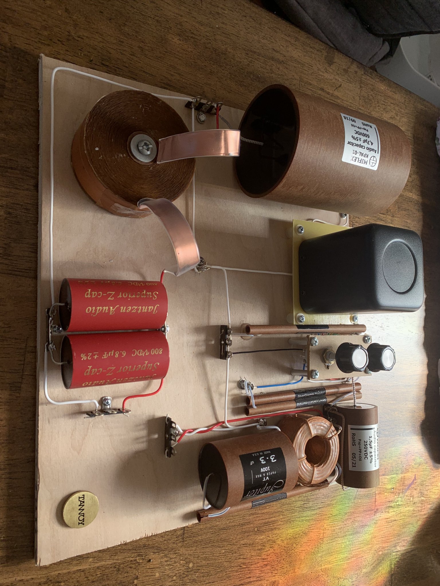

Hi Treyphan,
I am happy to have a like minded for HPD 315!
Are you interested in the topic of very good Step Response for
that Tannoy ?
Always! I’m always interested in discussing crossover or circuit changes. Provided the reason for said changes is included. Along with what exactly has been changed.
If it follows electrical and crossover theory and makes sense, I’ll probably give it a whirl.
Gonna check the link you out that you posted now.
Thanks!

Yes it is a mater of preference.
Thank you for the link Step Response, i'll study your description of Trifonov approach. I think i remember seen it in Vituix cad as a possible filter strategy option.
Honest, yes i try to be under all circumstances.
Brave i don't get it... i just don't want you to spend time on something i won't use in the end. Maybe you find brave to be honest? If that is what you meant i find it weird but... maybe i'm naive.

Let's clarify. I'm not a fan of multi way with Tannoy. The real legendary old Tannoy - one coaxial and HPD 315A - only! Not the new Cheviot!!
Hi, Step Response i get some have preferences for a reference over another one ( for bad or good reasons) but all the 'Classic' Tannoy drivers i've met were beaten to death ( i'm a former studio technician).
What do you dislike about multiway implementation with Tannoy drivers?
Reactions: 1 user
Thanks for the very right question.
Not only Tannoy but many others have wrong (dead) designs due to lack of knowledge!. The mistakes are mostly in the Time Domain,
the bass baffle, general configuration or a modest budget.
Last but not least, inappropriate drivers and crossover frequencies.
Single driver (full range) is not enough, but more than a three-way box is bad - if no "help" from a very good DSP!
When analyzing high-quality components, we should consider a specific model with its engineering conseption - if possible.
There are too few suitable drivers for three-way and even fewer for two-way.
About three ways with the Tannoy.
Dual concentric to be five or six inches. Suitable bass - 10", 12" or 15" ......?
A must with DSP for all crossovers. Ok - why not...if you get a good Step Response?
