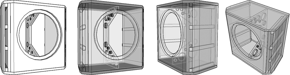

I designed a soffit mounted moniyor for the HPD15. That was when it became clear that a heler woofer would be a good idea.
Not the variation he built, but my favorite.
